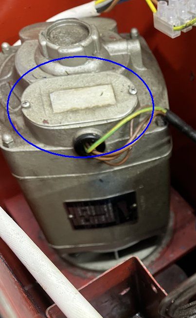

That would remove the limit switch but I suppose and the ability to control the lift using the lever on it? I’ll just have to be careful!?The output from the VFD should be connected directly to the three brown wires coming from the motor. There should be nothing in between VFD and motor, only copper and plastic.
In the photos, it looks like the motor wires go into the blue box. Disconnect them there and wire into the VFD.

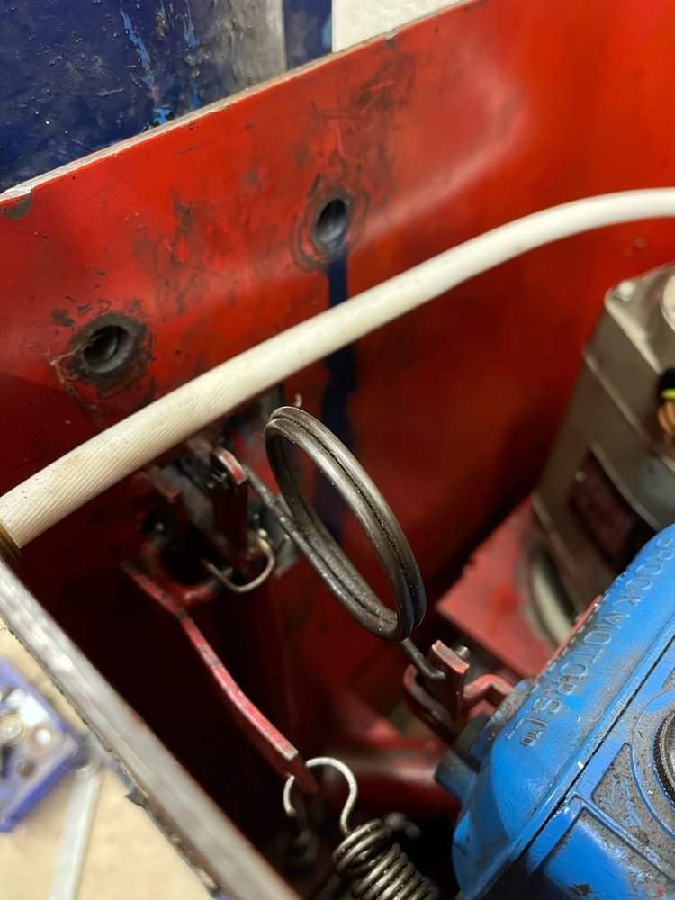

Lever
Comes into the tank here and operates the switch in the blue box:
