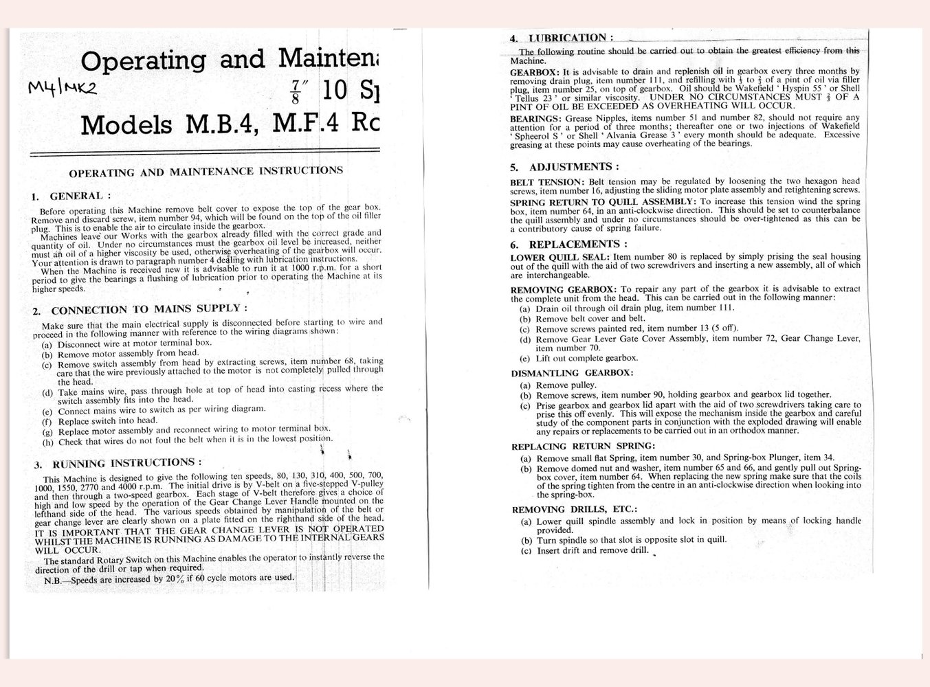

I have never been able to find a proper manual for the Meddings M4/MF4 drills.Hi new here looking for the size of the oil seal for my meddings f14 and any Manual
Thanks
The most I could find is the parts list and one page worth of manual.
You can download it here after registering etc.
