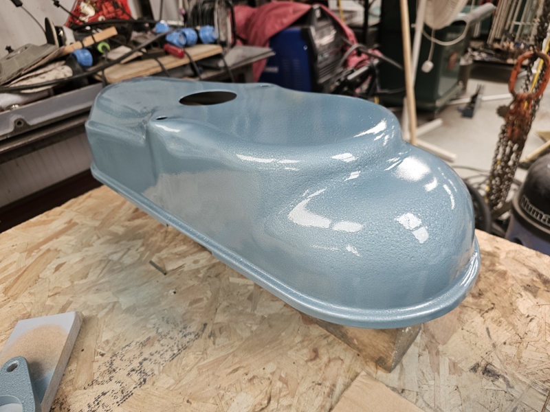

Maybe test the hammered paint on spare scrap with the primer on it. It may react with the primer is what I am thinking. (Although modern watered down hammerite hammered is probably OK)A bit more progress. I've taken a couple of days off to look after teh kids while the missus is working away. Until recently I could have worked from home at my manager's discretion but now I have to be in the office 3 days a week, company policy. No big deal, it means I can get some quality workshop time in

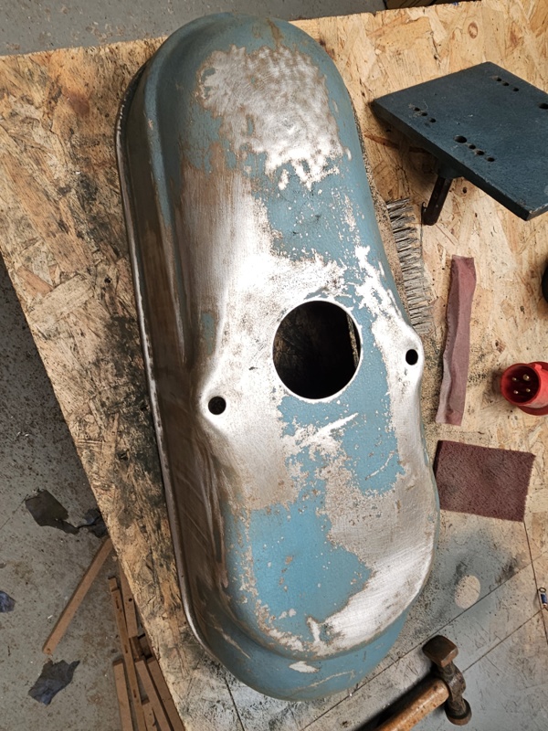

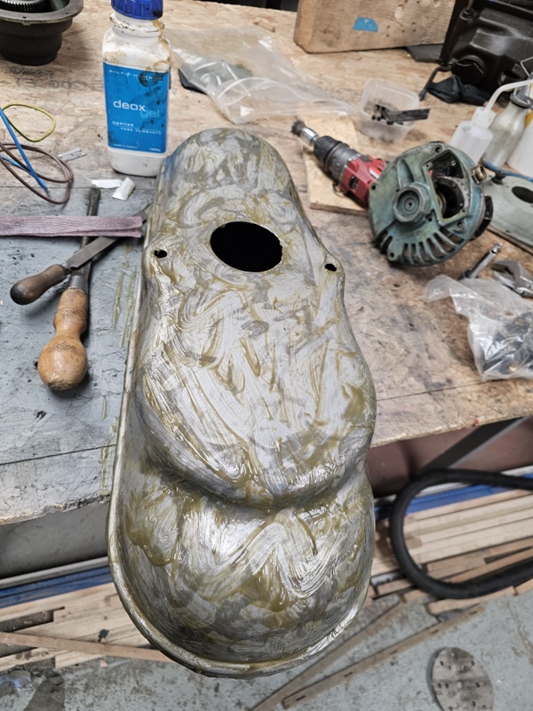

This is how I left the belt cover the last time I managed to break free and escape to the workshop

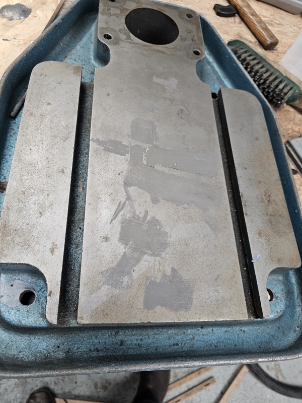

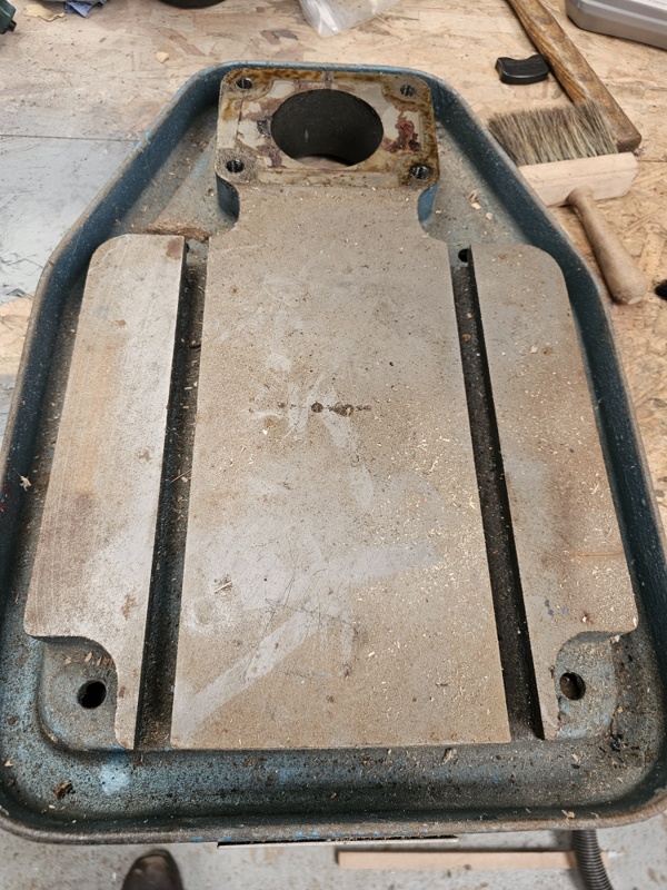

Most of the dents pushed out, but a bit rough. Plus rust had got under the hammered paint finished, no primer just one coat of hammered paint.

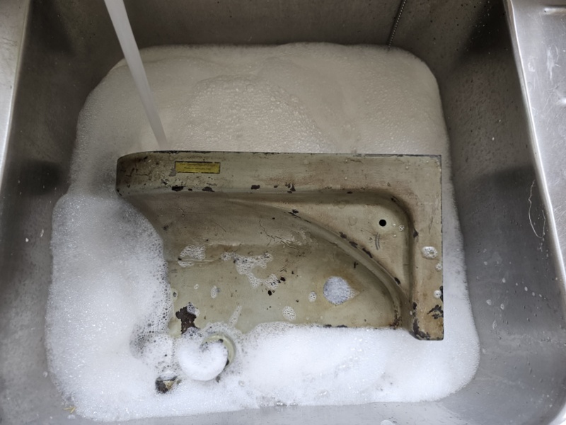

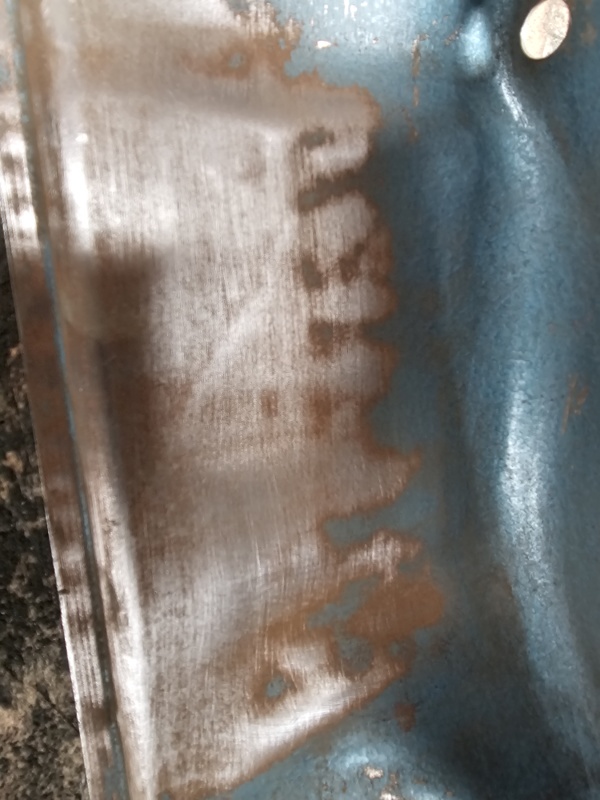

So it all came off, here it is after removal with a cup brush, followed by a coat of Bilt Hamber Deox C (citric acid gel) as the surface was a bit pitted with rust in places
an hour or so later and another was in the sink in the utility and its looking not too bad

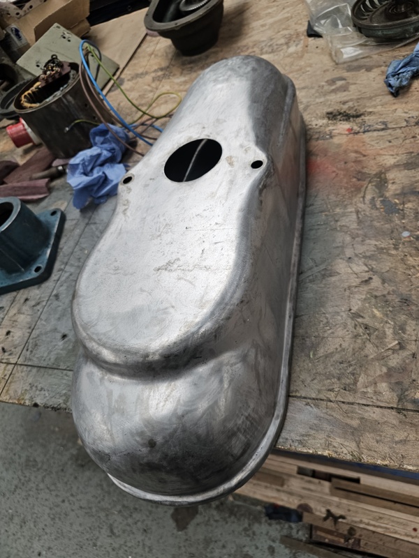

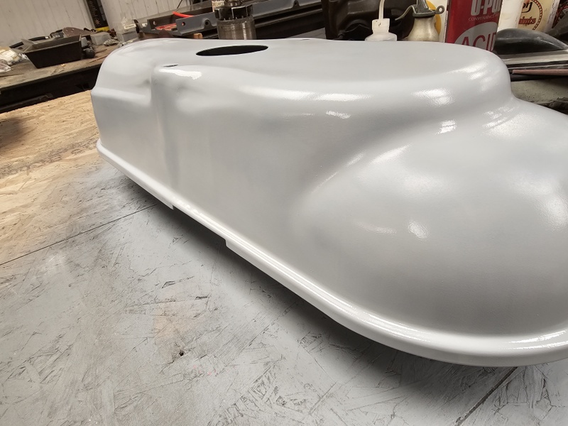

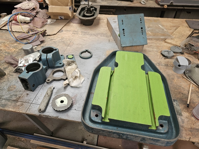

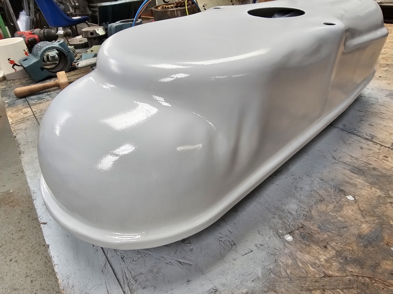

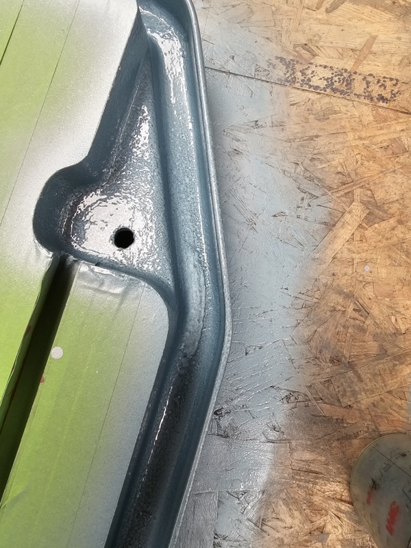

I put a bit of Upol Dolphin glaze on the worst of the minor dents from my amateur tin bashing, a quick sand then a coat of acid etch.

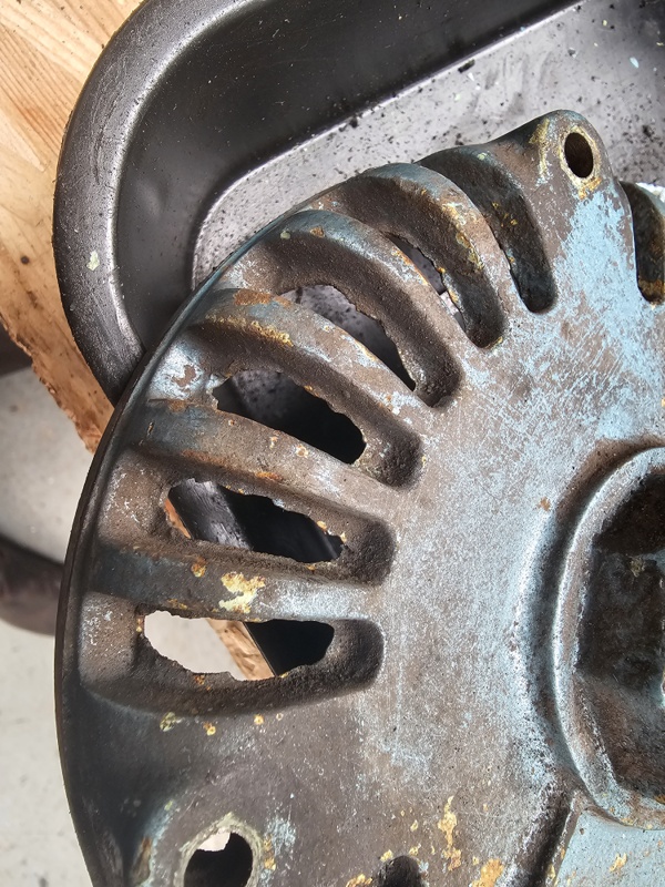

It doesn't look bad from that side, but on this side, the paint revealed a couple of wrinkles from when the drill fell of the blacksmith's bench that I thought were just part of the pressing process, they look far worse now.
I thought about having a go at bashing them out, but decided they were part of the history and patina of the drill, or rather I think its good enough, it fits the casting fine. It must have been hell of a wallop to do that, no wonder the drill casting smashed. The dent at the front is pretty good in that its not very visible unless your looking for it. Hammered paint is quite forgiving so once its had a coat of blue hammered finish, it will be less noticeable, I hope.

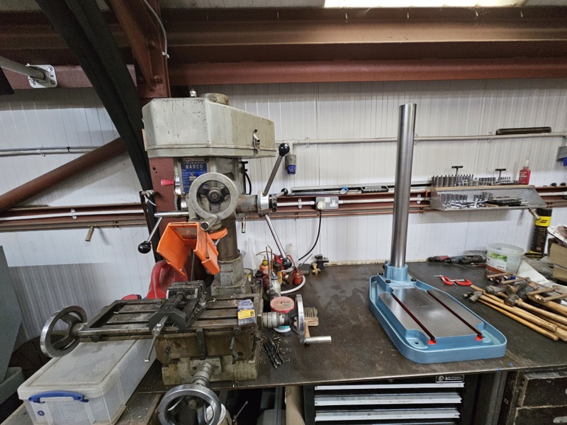

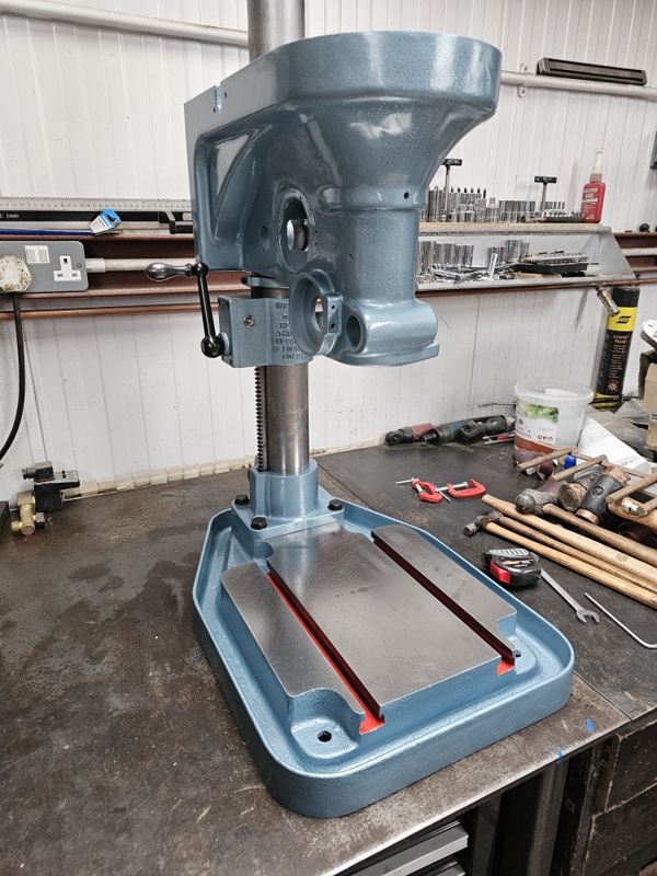

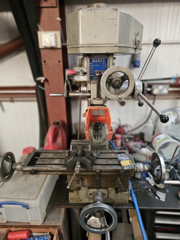

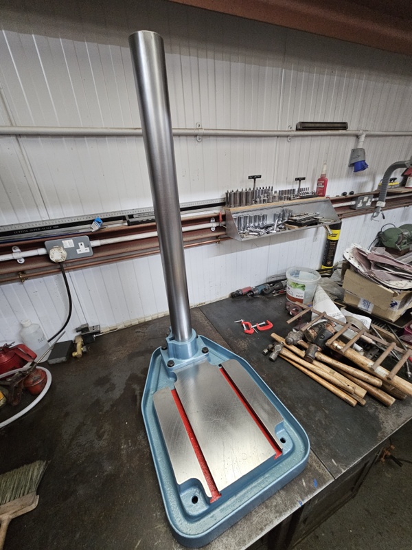

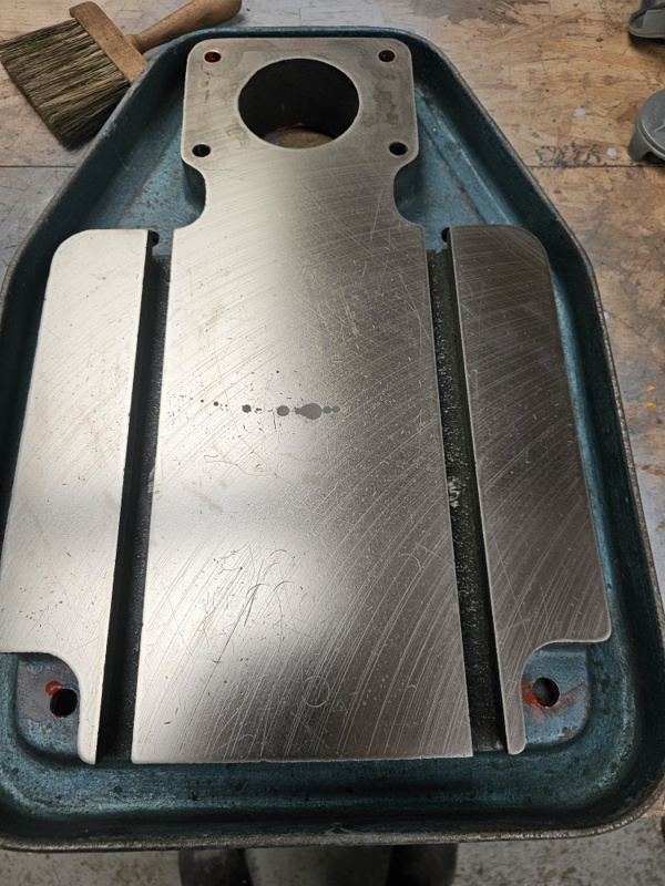

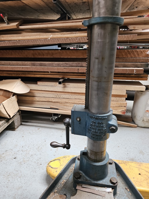

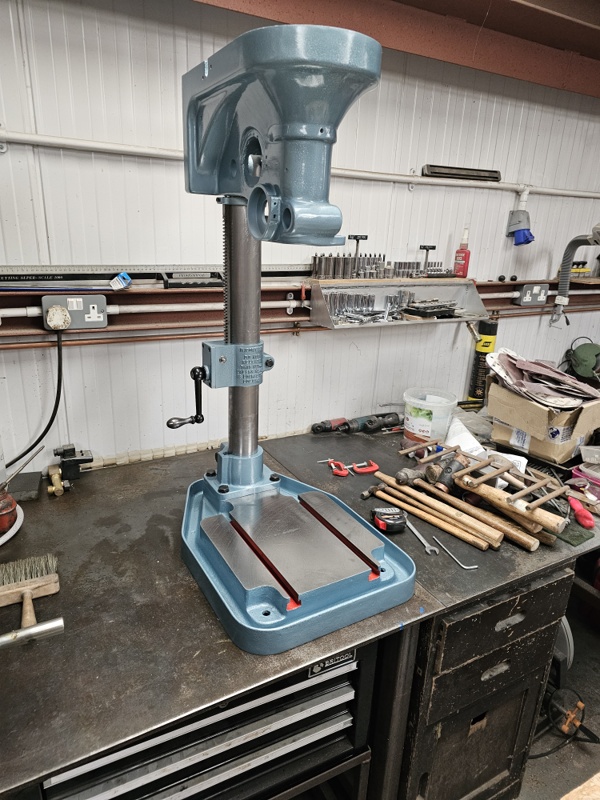

Looks very well indeedI put the base on the bench in its temporary position next to the mill/drill its replacing. Mainly as it was the easiest way to clean up the column. A strop with 240 grit emery tape then straps of extra fine scotch pad cleaned ig up nicely.
