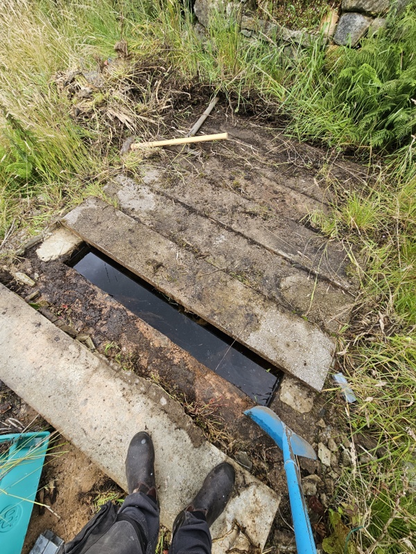

I was going to be brewing today, but our spring water smelled funny. My fault, when I cleared the area for the solar panels, some of the vegetation fell on top of the spring tank. It started to rot and the rain washed some of the essence into the tank.
My fault, so I've pumped it out and will give it a good clean tomorrow. I need to make a stainless frame for the paving when I do the patio next year so this gives me an opportunity to measure it properly.

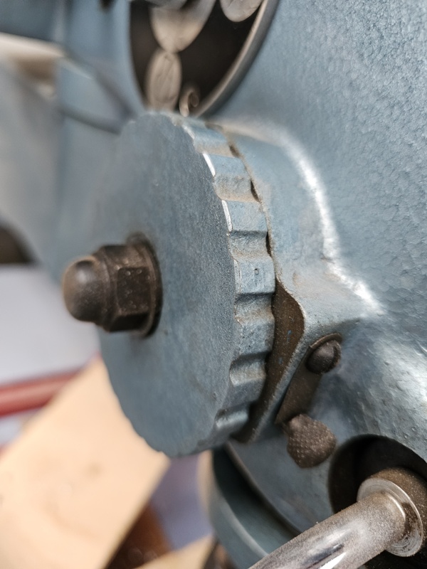

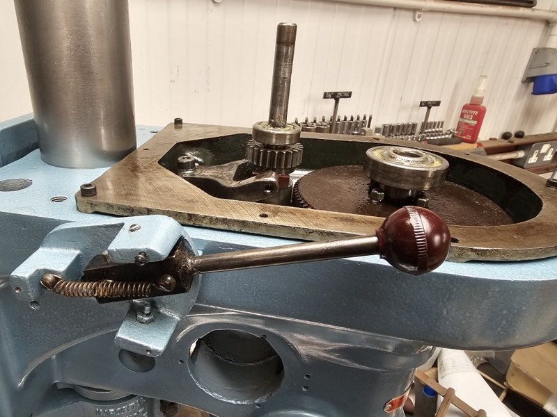

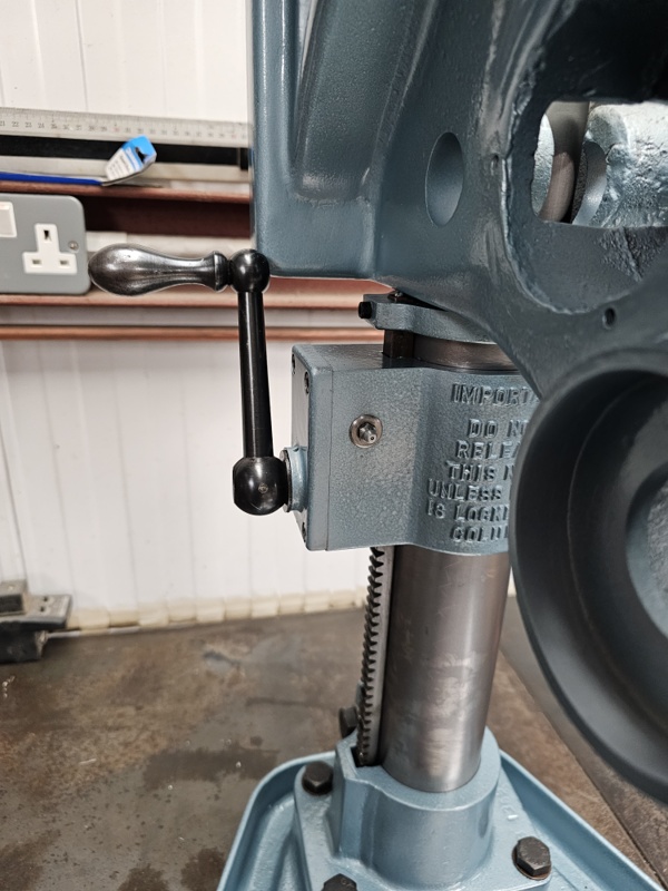

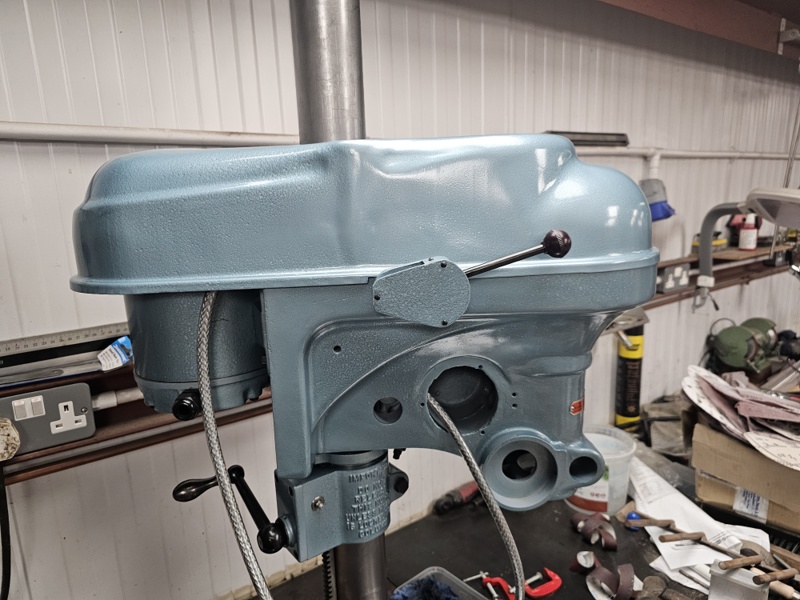

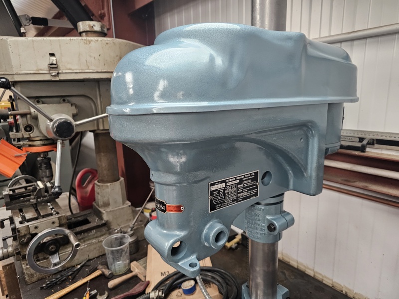

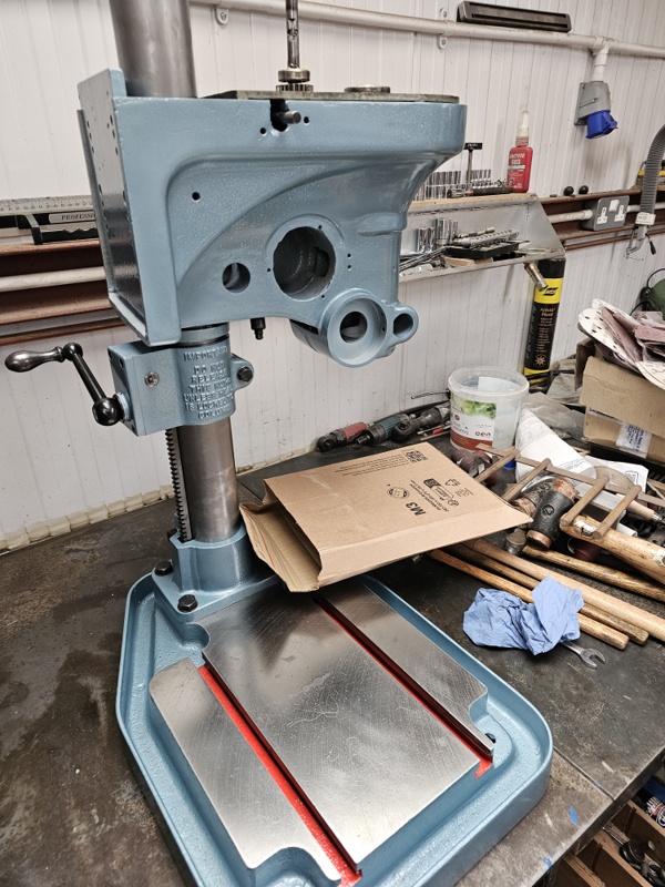

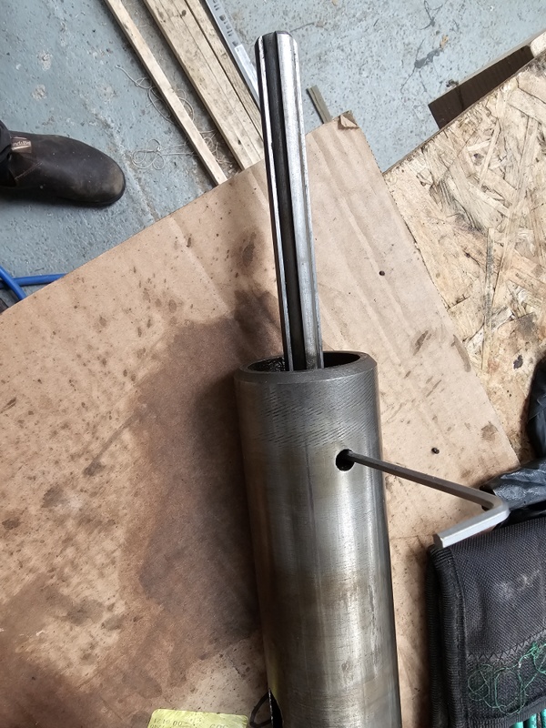

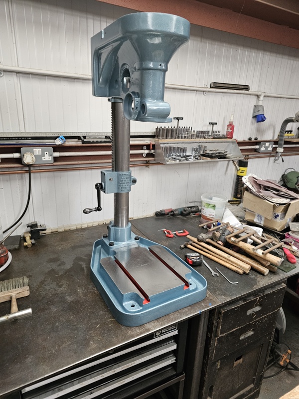

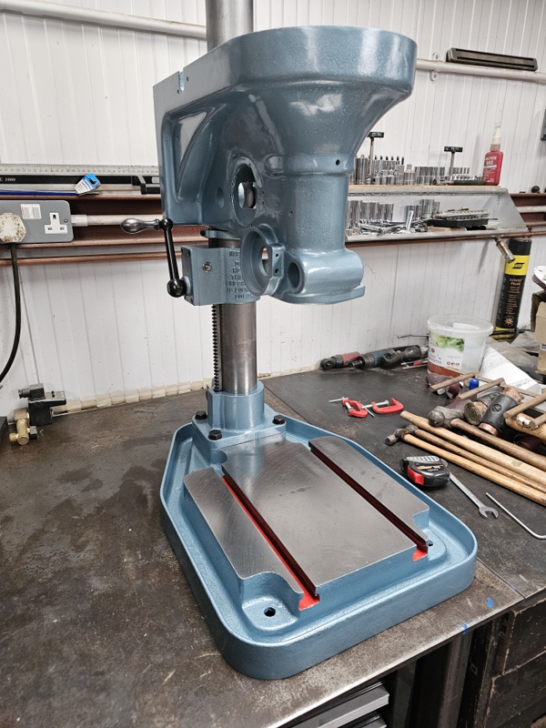

So I got a bit more time in the workshop. I reassembled the lifting rack mechanism and put the head casting on. Quite a useful head height.
It's easier to work on it with the head lowered, I clamped the lifting mech just so the top of the head doesn't clear the pillar at full lift. At full drop, once there's a chuck on it, the quill should be able to reach the table, or close enough.

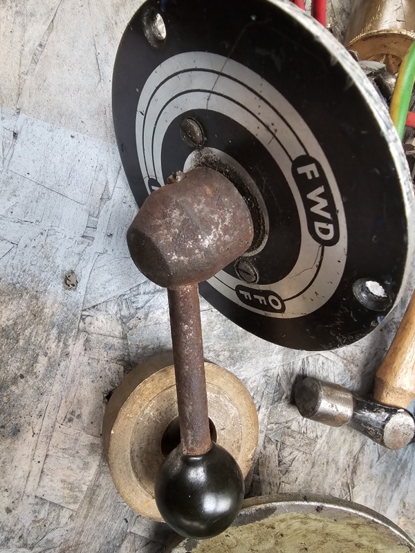

Only slight design fault is the winding handle hits the head at full drop with the head straight ahead, but you can twist the head to one side slightly.

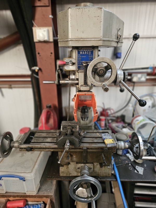

The Warco/Alpine/ Taiwanese Mill/Drills seem to be sort after for smaller workshops, and I only ever use it for drilling so a bit of a waste in my workshop, probably better earnings it's keep elsewhere .
Are you intending the Meddings do light milling chores?
That's what I was wondering! It seems you've got mills well covered then!I have a couple of Tom Senior mills, a light vertical and an M1 so no need and not really designed for it.

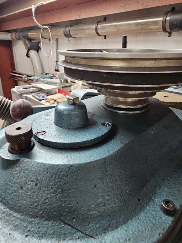

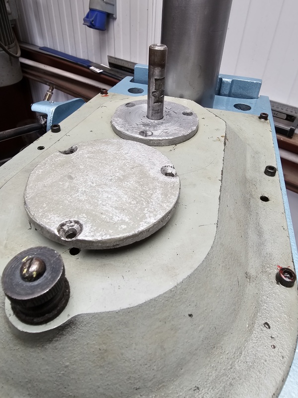

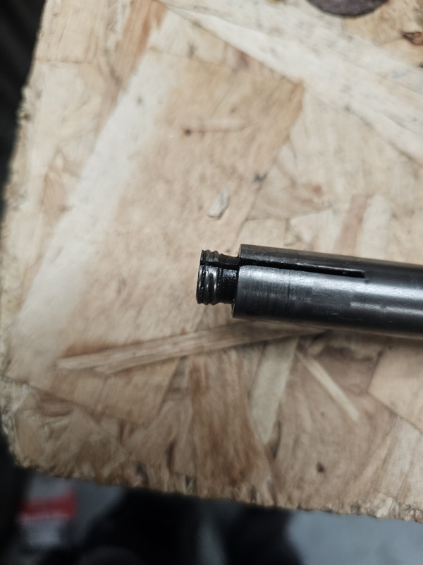

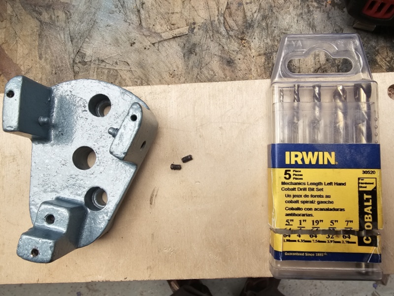

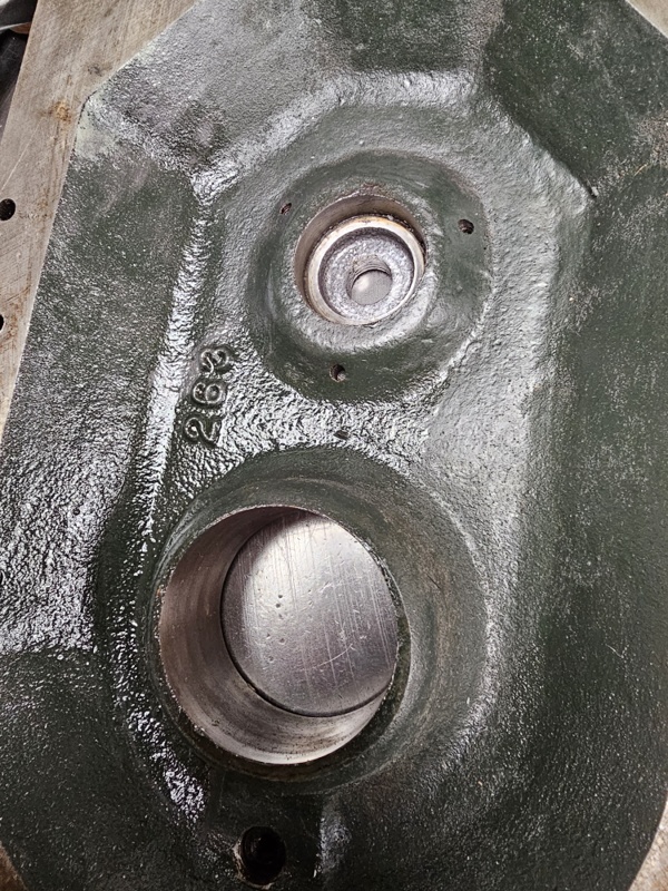

Just confirmed, the vent is item 94 in the attached diagramOn the subject of seals, is there a breather, even just a small drilled hole, in the gearbox? My Progress leaks, but only when it gets very hot, as in the weather. It's a feature that I'll add the next time I play with it.
A small, drilled brass bush.
It's all good funJust as you get the lid on the gearbox bolted down.........

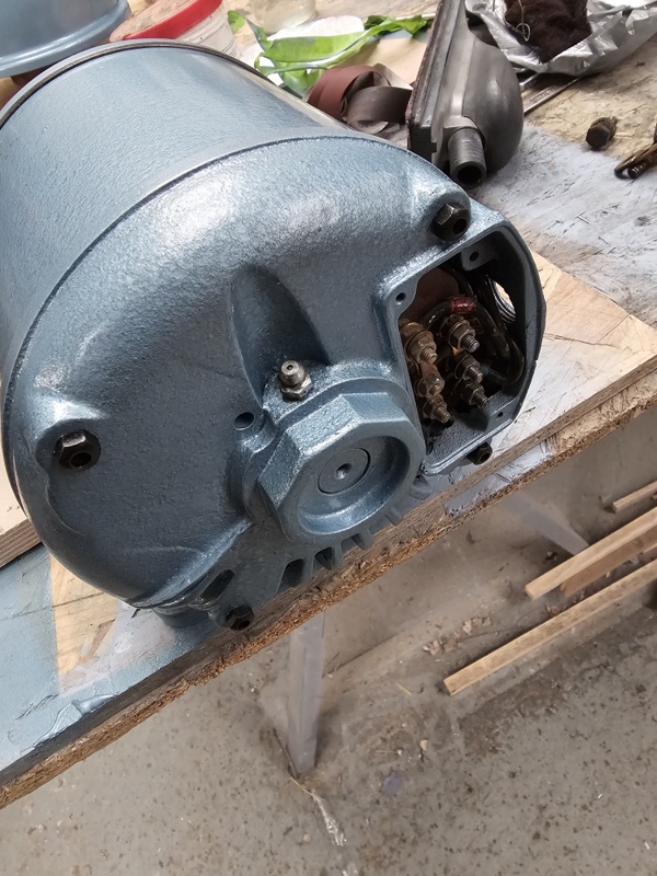

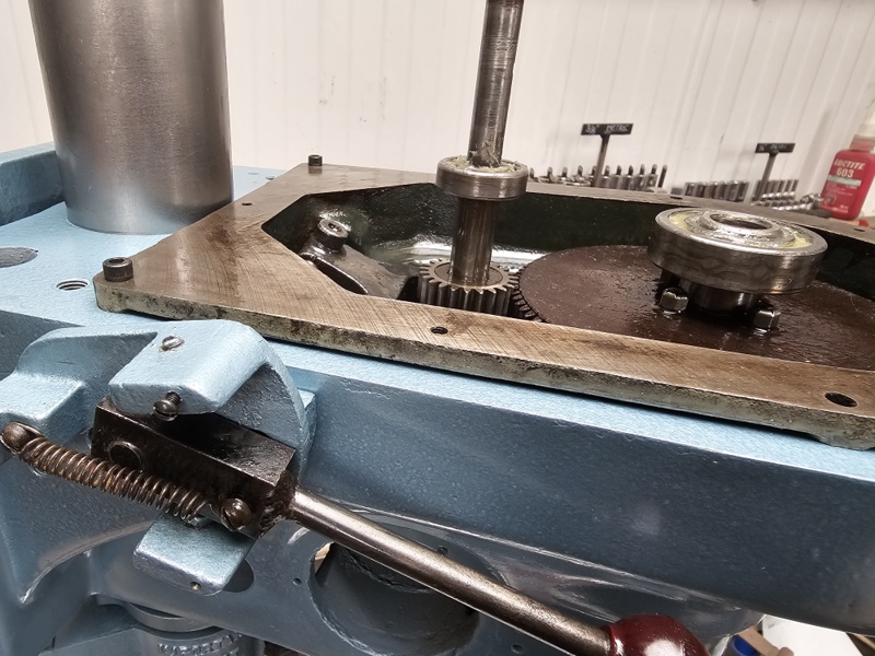

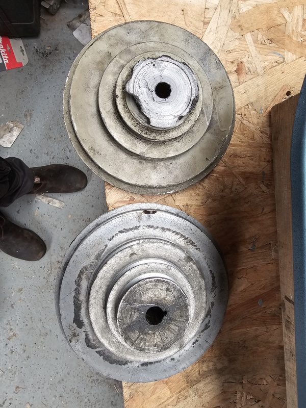

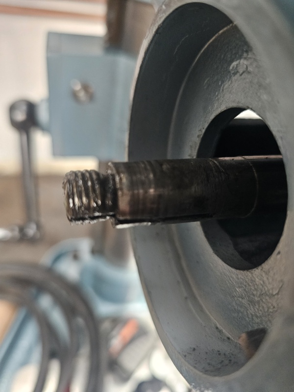

While I was at it, I thought I would get the pulley on, that way I can line up the motor pulley and bolt the motor on as there are multiple bolt holes on the motor plate. So I get the pulley from the tub of bits, needs a bit of a clean, then I notice that the small pulley is mullered, I had forgotten about that. No problem, get the spare, bigger bore and has a keyway...
Existing shaft just has a flat for a grub screw

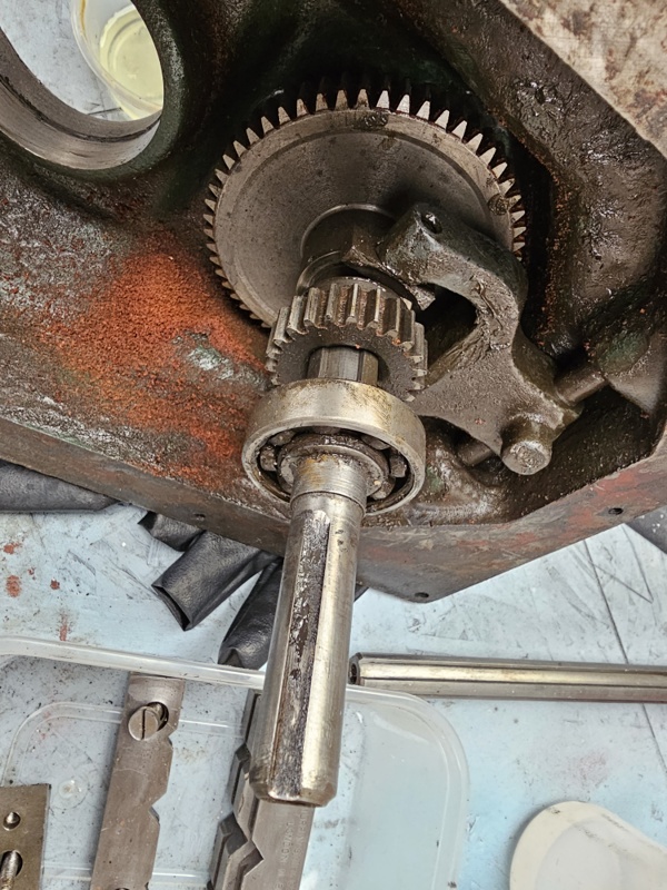

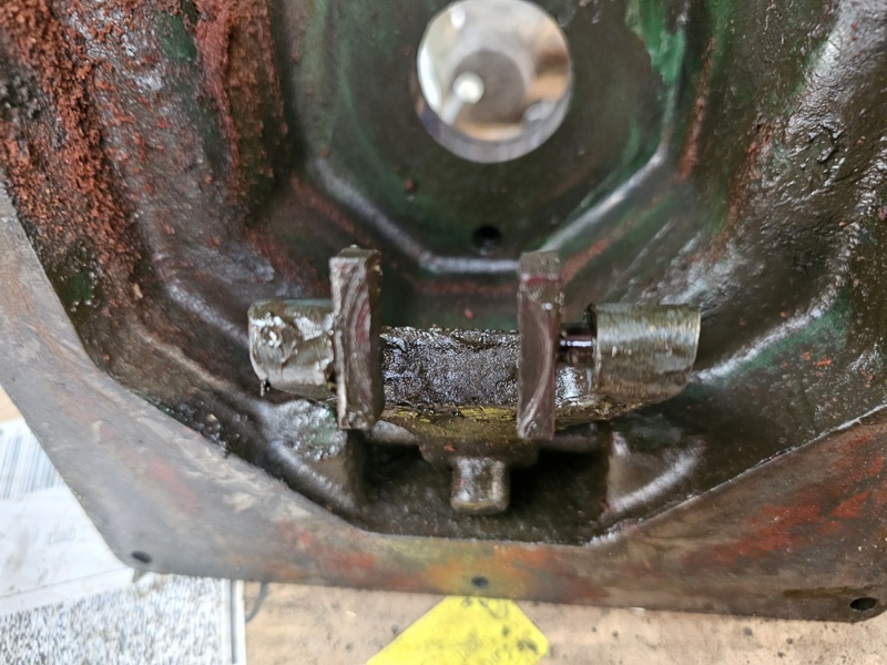

The shaft in the spare gearbox has the keyway and the pully has a grub screw opposite, a better design, The spare gearbox has seen better days, the wear pads that move the change gear are past it, you can see the powdered cog where a previous owner has changed gear while its still running.
Given the pads on the gearbox I now have in the drill have a bit of wear, but serviceable, I think I will go with the damaged pulley for now, I'm going to fit a VFD so its unlikely I will use that pulley anyway. I'll refurbish the old gearbox at some point then I can change it later. That means buying one delrin cog, fortunately the smaller one, £103 each.

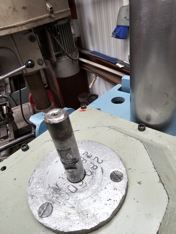

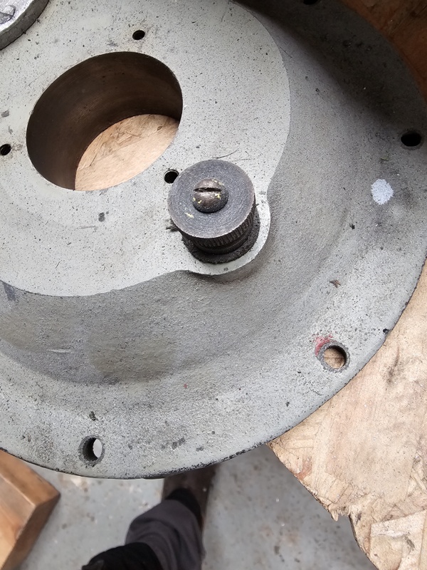

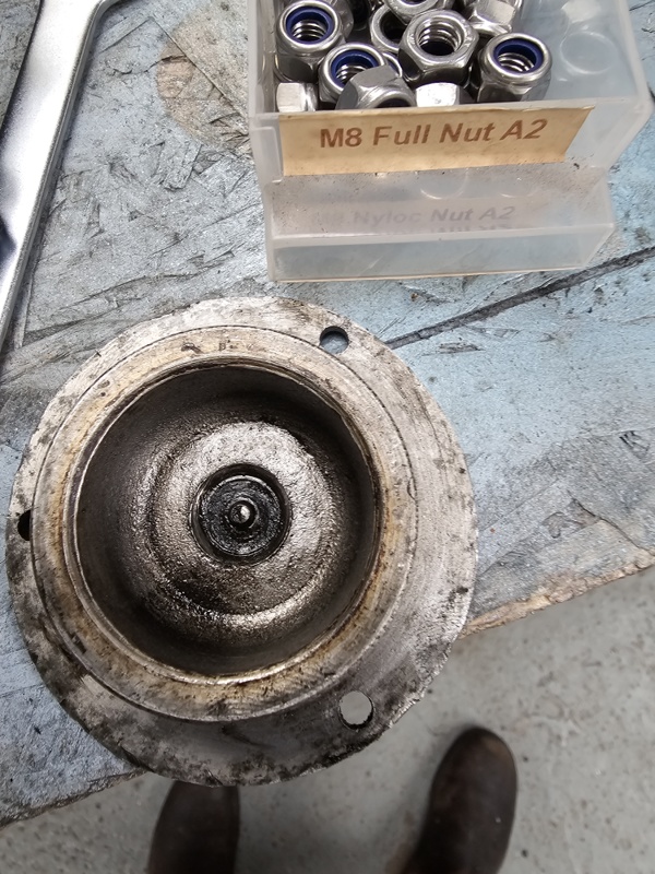

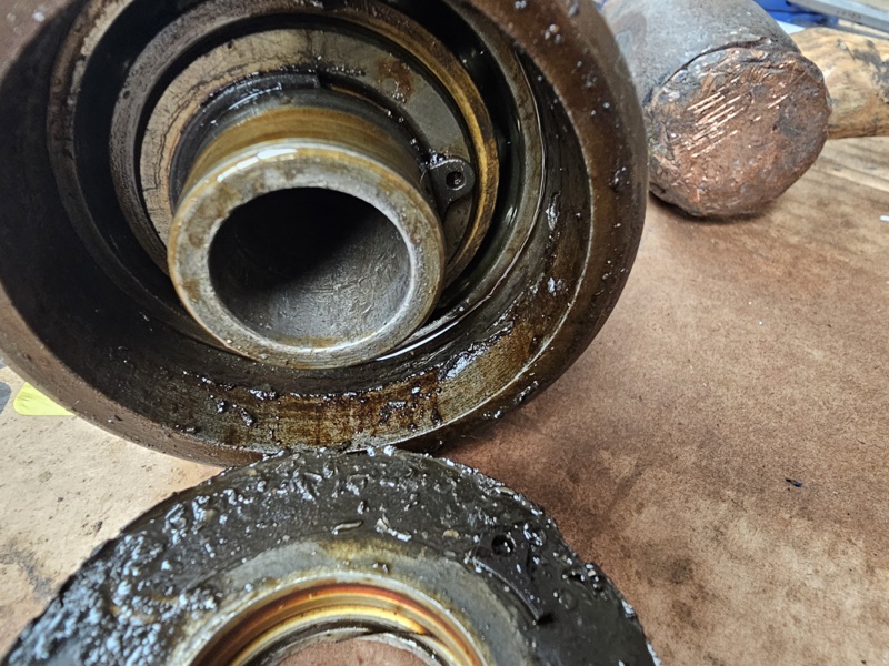

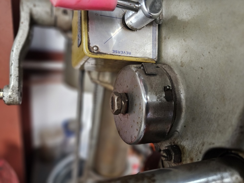

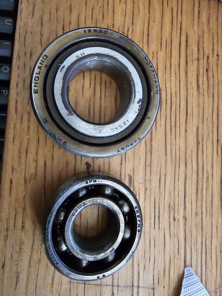

There are other design changes too. The cover on the front/top bearing is plain on this gearbox and the spare.

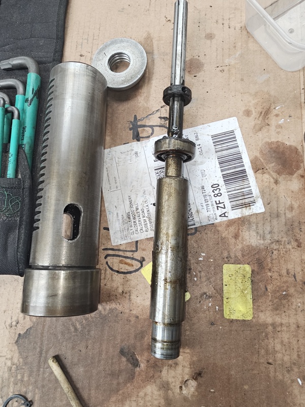

Inside the spare you can see where the quill hits it, this isn't evident on the current gearbox so maybe adjusted wrong.
On my radial arm drill that I refurbished ages ago, they have a redesigned cover with an oiler, presumably the top bearing was getting starved of oil, I have packed the current gearbox bearing with grease, but I may look at this mod when I refurbish the spare gearbox. I'll probably be retired by then so may have the time
