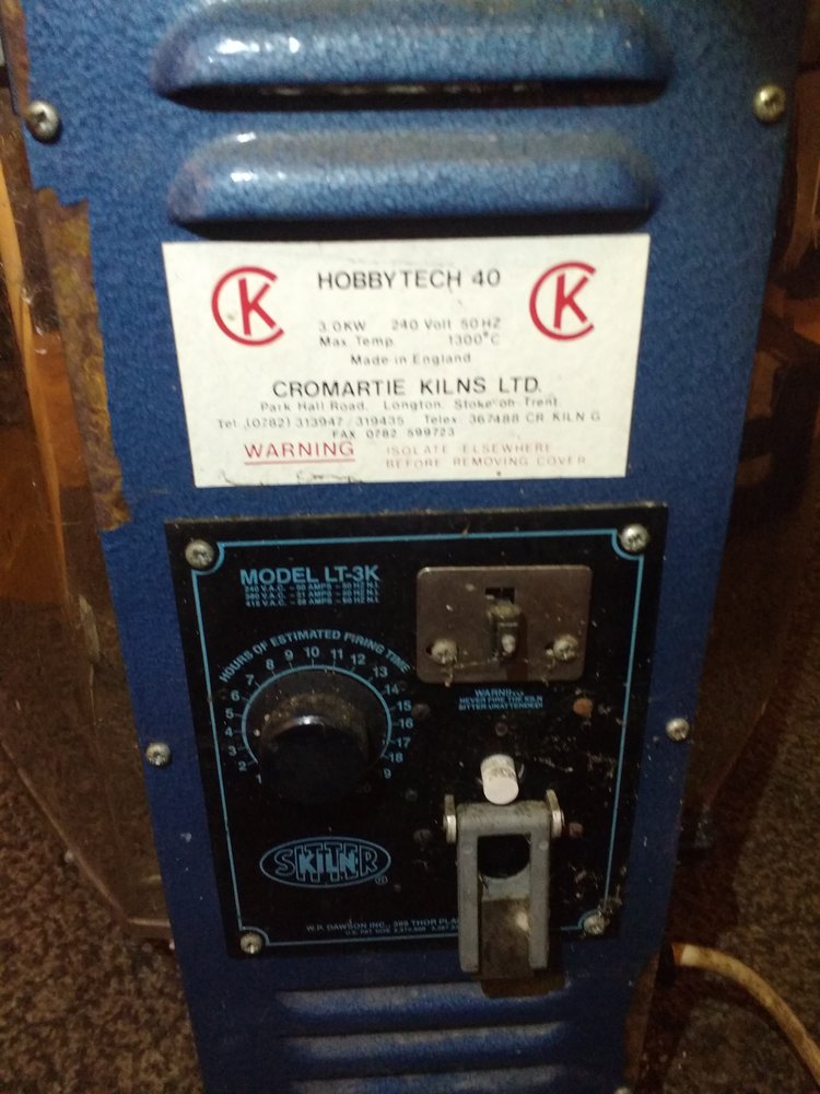

The main problem was as it started to rain, I turned the heat up, split slag, popped the element and had to pour early.
Im happy with the burnout but next time I'll start at 180-200c and try to retrieve the molten plastic to avoid smoke before going hotter.

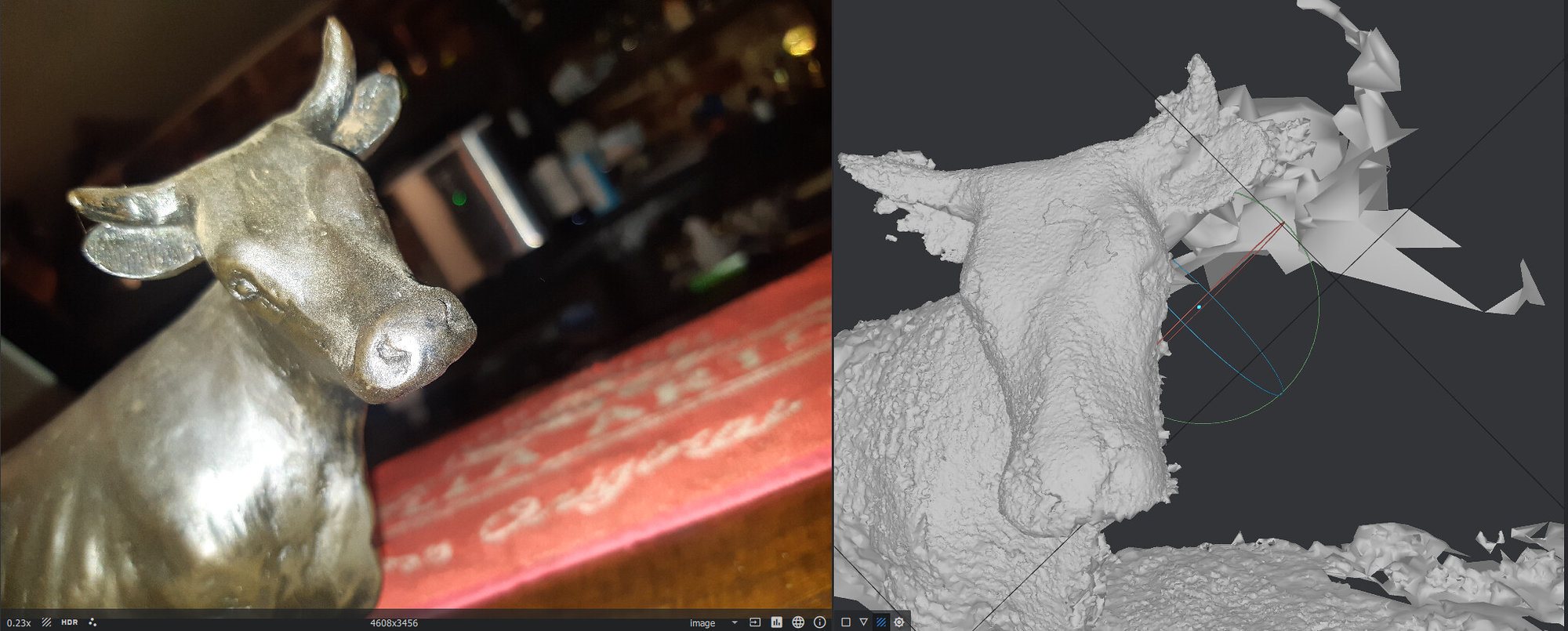

Also there is a bump/print swirl/wart on the cows nose, is that intended? as it came out exactly in the brass. Im quite pleased its catching the details.
