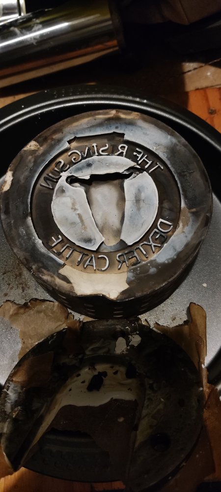

I have some borax but it would eat the cuicibles quicker, so I dont use it. I might try citric cleaning the nuts and graphite powder or a carbon source as a cover. However with a huge surface area of nuts, losing 10% is acceptae I think, should be much less when remelting solid bits.

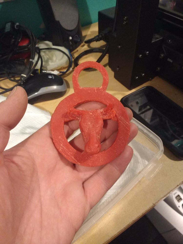

The 3d print will need under 170g of brass. The problem was my carved sand runners leaked and used more than I expected. A previous one was 350g.. A traditional plaster pouring tree would use less brass, but double the plaster - dont have all that much left! 2 or 3 more attemps.
Sprues are for filling, there is only one and it should be a very specific size.
Vents, yes they can be many, shouldnt be needed with porus plaster. 1/4" is way too big.
I may change things and try using the vacuum chamber for the next pour.

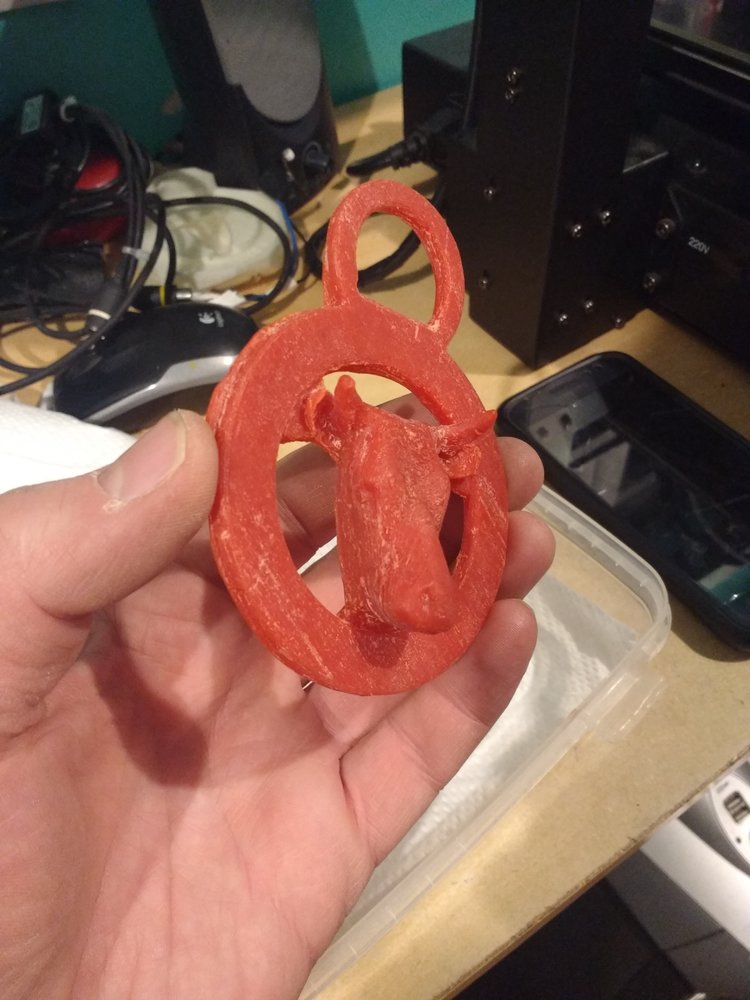

Turbulence is not desired. Slow is much better. With the correct excess of brass there will be plenty of head to get the air out when a porus medium is used. Its not an extreme detailed object like a grasshopper*to let the molten brass rush in and the air out quickly
