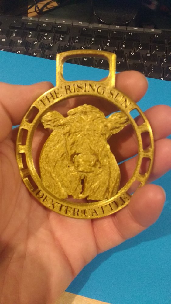

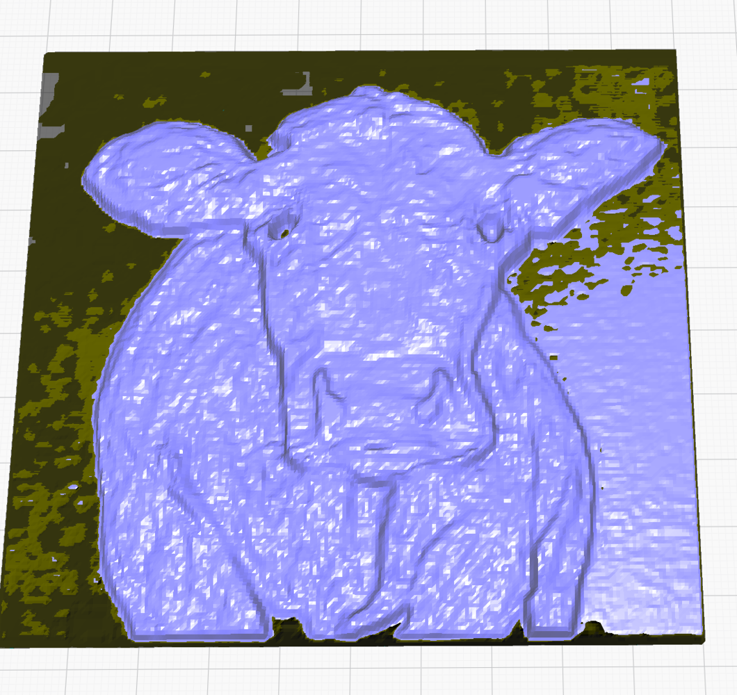

Could you not have chosen a different colour it looks like you've printed a cow's face out of cow pats![]()

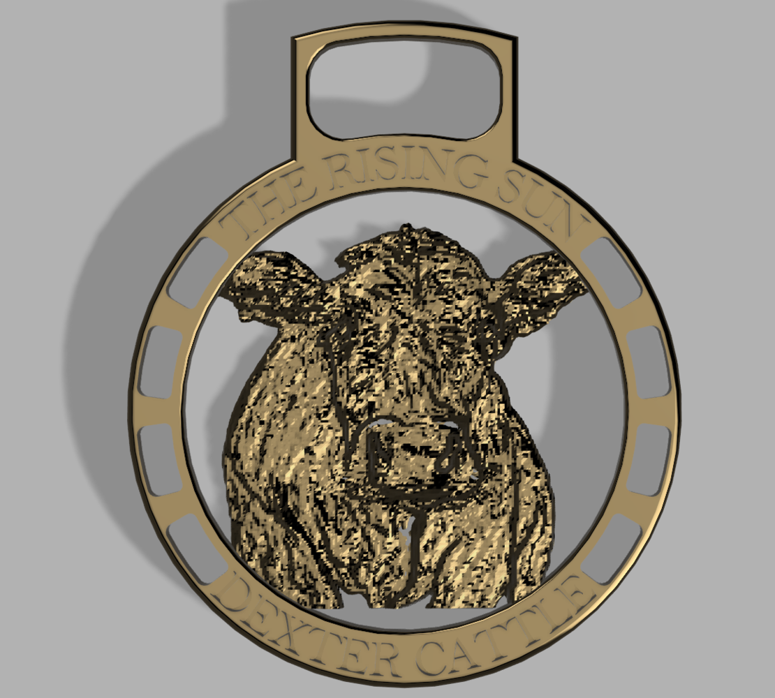

It's meant to enmulate the eventual brass!
Where is the shop and how much is it? Do you know if they do green sand?Still need to go and buy that investment powder...

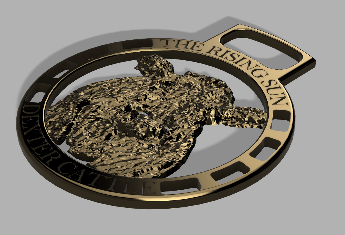

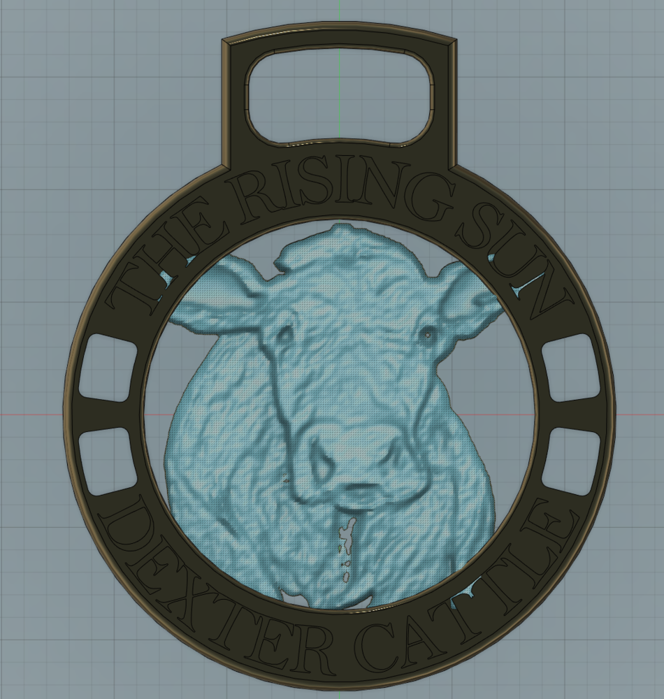

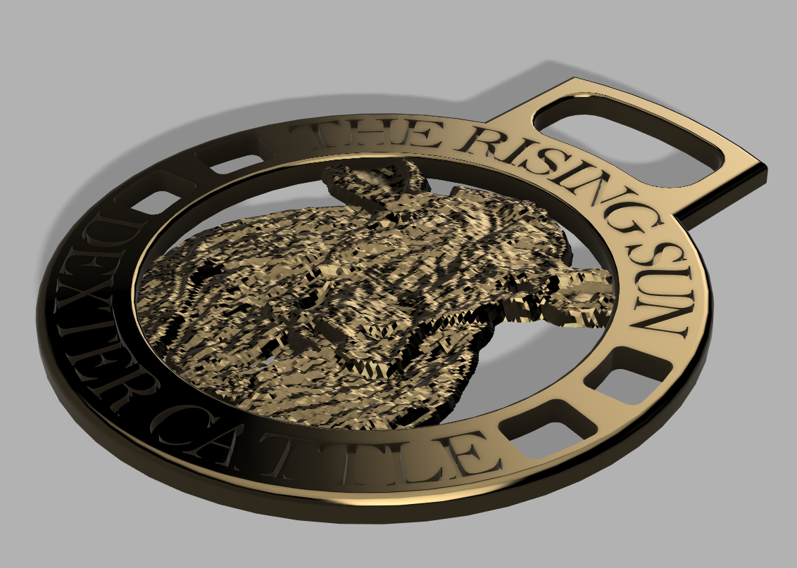

I think it needs the whole head to stand out more, as at the moment, it blends into the body, so you need to actually look at it to distinguish the head/ears/eyes, not just glance at it.The reality is somewhat less pleasing than the render! The cow needs work...around the eyes maybe?
Maybe it would be better in actual brass?
So close but no banana!![]()

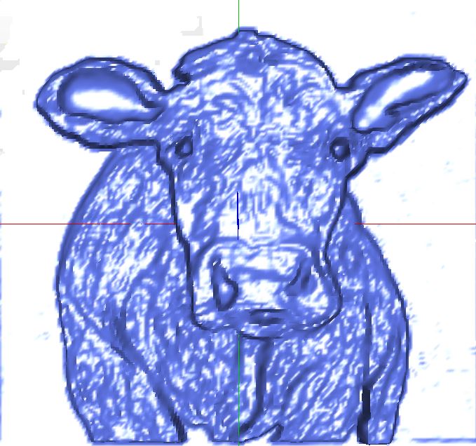

It may be easier to edit the original photo, and give more contrast between the head and body.
If you can make the contrast greater in the photo, the 3D algorithm should then give more depth between them.
If you send me the photo, I'll have a play.
