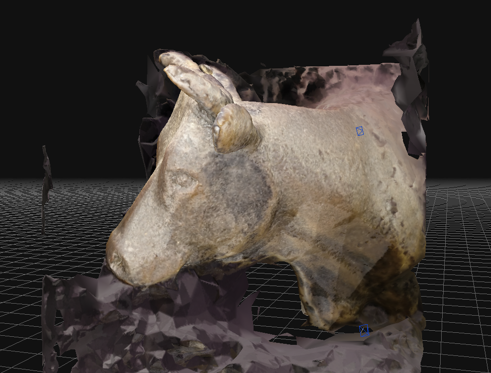

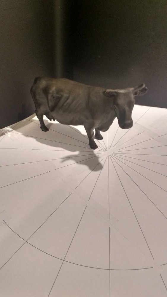

I think you can combine them as long as the software recognises the two cameras when you import the pictures, if not there is a way of combining two point clouds but I've not done it myself with Zephyr. Try it?Took the light box to the pub Saturday night and dragged No.1 son up to take cow pics. Bribed him with Rosie's Pig and the pub cat!

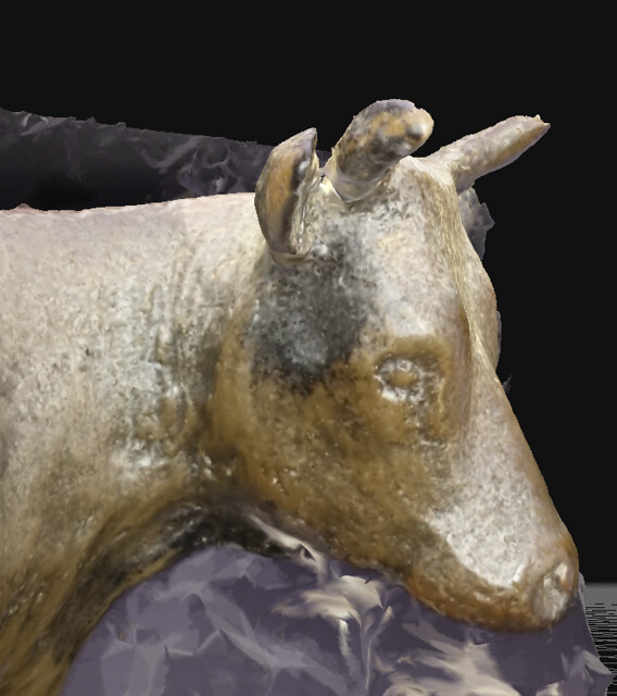

The best cow rendition yet but the other side not so good. Using the free version of 3DF Zepyhr.
Interesting how the program "rejects" some photos which you'd think perfectly useable.
It's like we're "missing" a couple of shots on the lhs of the head to stitch everything together.
@JMS1972 , can you combine pics from two different cameras (in our case phones)?
Next visit we'll take the lightbox and laptop and try and crack it.

Can you merge the two mesh's?@JMS1972 , what gives here then?
Fresh back from the pub, set the light box up on a pub table. This time we've managed to do the lhs decent but the rhs (good before) is carp:
Meshmixer or similar would be best...That's a facility in Zephyr?
I will have to wait until he who can surfaces.
