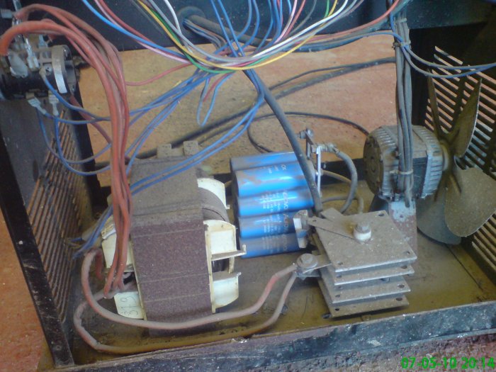

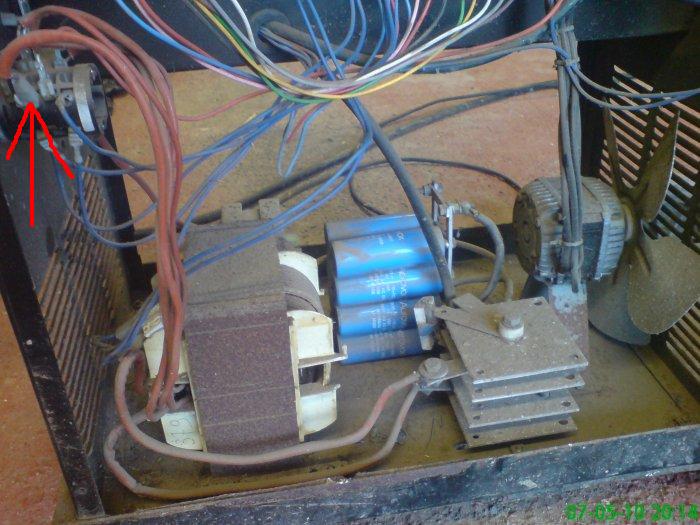

start by finding the 2 mains wires that go into the transformer probably one to the relay and the negative to the mains switch or somewhere similar take a photo and write down where they connect to (make a good job of that as it will only cause you more problems if you forget where they came from) then disconnect them both and connect them to your multi meter set your meter to resistance say 200 ohms and you should get a reading showing there is a circuit
