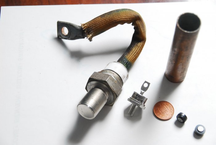

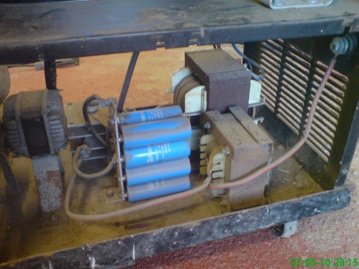

please explain moreIts the choke , gives you a more stable output on dc , there are some real cheap mig welders which dont even have a choke or one thats aluminium wound as an appendage on the main transformer . I would bin your diodes and get four big ones which could be mounted on the existing heatsink or make your own up using some peices of copper busbar , you could easily make something far better than originally fitted for little cost that will become the strongest link in the circuit instead of the weakest .
what rating diodes would i need for the job??The coil (reactor) is needed for short arc welding. Without it, the wire will hit the metal and a huge current will blast the wire away. Welds are messy and average current is low. Then the arc will have a low current. The choke ramps up the current until the droplet is pinched off the wire. It then maintains the current during the arc and causes the droplet to fan out.
My Miller had no choke, it was for spray transfer only (175 Amp and up.) Back in those days, that is all there was. Welds were cold, more spatter than weld and a crater at the end. Added choke and it welds nice down to 20A.
As for the diodes, it looks like one is shorting out as it gets hot. Probably best to replace the whole pack. Weldequip may be able to source a similar pack.
Otherwise it would mean getting 4 or more diodes and making one.
thats what im starting to thinkthere are various formations that i have seen so you could just copy it.
dont forget you will need to be able to mount them properly on the heat sink so they dont self destruct due to heat.
it might be easier to buy a ready built rectifier
so what sort of spec do i need?
on the rectifier now theyre in 4 pairs (8 diodes),would i need to stay like that??
intriuging sir dickThe diode on the left is a good one and I got 8 of these for £10 from a scrapyard , if you are lucky you may find they have not begun stripping the equipment they came out of so you could get the heatsink as well but if not then use large bore copper water pipe squashed in a vice and drilled then bent in a U shape , I prefer to use scrap copper busbar , make your own insulators again using material from the scrapyard , you can make your own rectifier pack for £20 that will far exceed the performance of anything you can buy commercially ( unless you are willing to pay hundreds of pounds). These diodes will run at 250 amp continuous without generating a lot of heat and are complete overkill but if its costing so little then why not and you only need to use four of these . The diode in the middle is 85amp 200V and got 4 off from Farnell for approx £12 delivered , they will do but they get quite hot and need a good heatsink and they wont last forever . The button type on the right is claimed to be 75amp and these are fitted to a lot of battery chargers and welders etc ( the versions with a lead attached ) , they get too hot even carrying 40amps continuous and are mainly not very reliable , it was seeing crappy equipment fitted with these that got me interested in welding equipment , am not saying you cant get good ones but I only have experience of them failing and along with poor quality protective devices that dont protect causing transformers and other items to burn out .
once i twigged what was what inside it wasnt to badDai, Congratulations on your success with the troubleshooting, tracking down the fault and fixing it !
Even when new, those diodes were rather wimpy for a 200A machine. The wires leading to them are very thin, and now look damaged by overheating. If all 8 diodes still work, you could try resoldering again, using copper strip in place of the wires. Diodes can be damaged by heat during soldering, so you may be able to rig up a "sandwich" arrangement where contact is provided by pressure instead.
Even if you fix or replace the rectifier, it may also be worth checking other connections where you may be losing maximum amps - by resistance - such as on the earth return lead.
