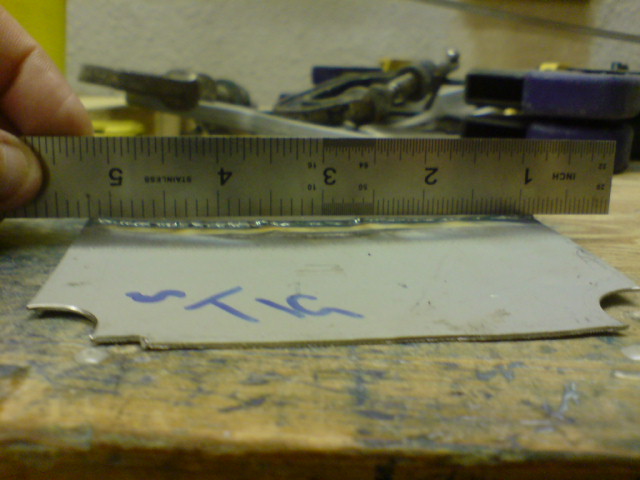

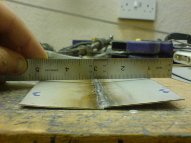

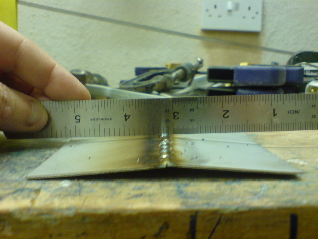

so the first attempt was to run a bead straight across and the results weren't pretty, with the heat blowing holes in the metal and it I then tried to fill the holes with weld the distortion increased (big blob on the left).
and the view from above
and below
and the distortion

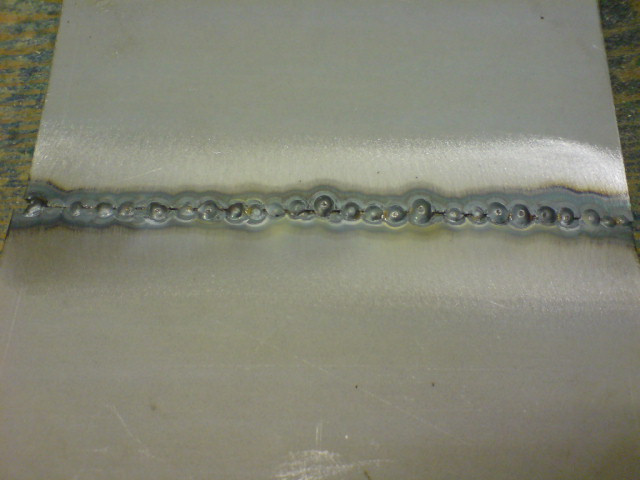

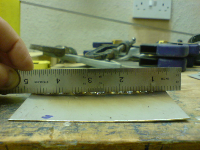

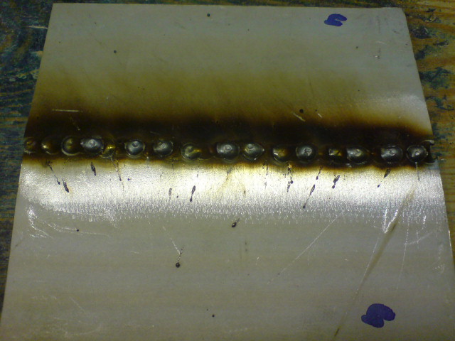

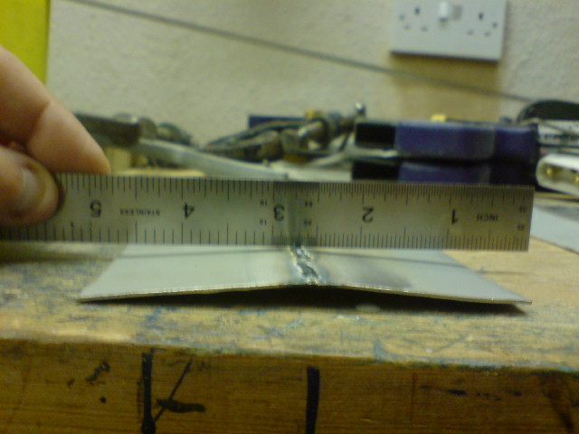

so then I tried again using the same settings but this time pulsing the trigger, by welding one tack, waiting for a short while (less than a second) and doing an adjoining tack and repeating this across the join
the view from above
and below

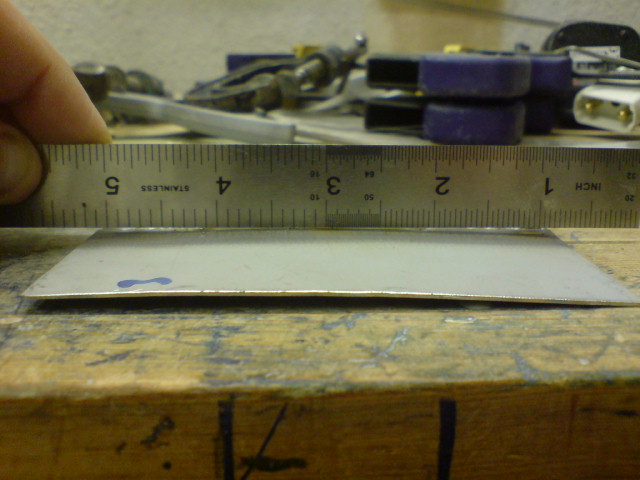

definately looking better, but still with distortion
