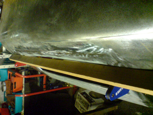

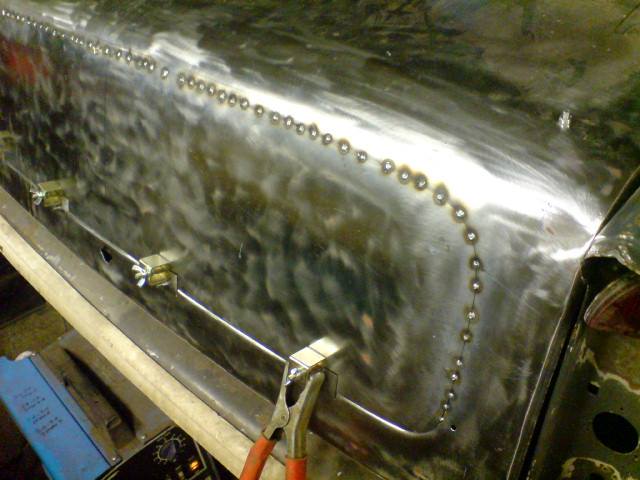

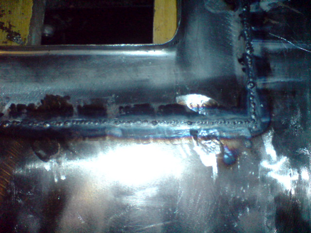

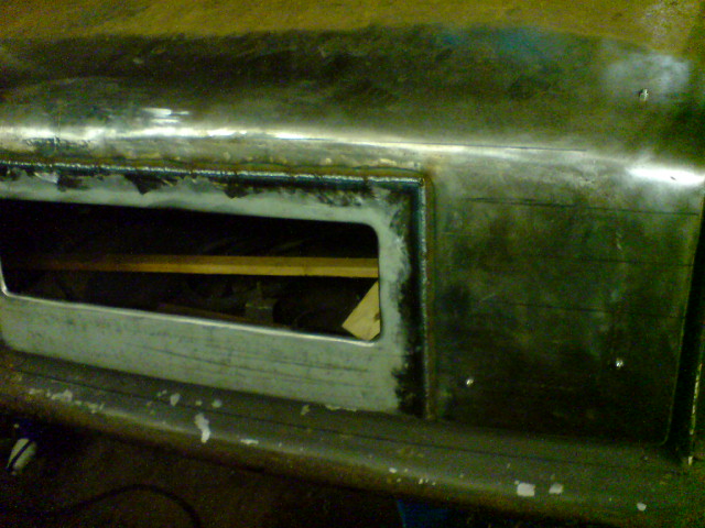

thanks for the reply guys, I think on my original welding the distortion could have been increased because I was welding very close to a section that would have been stretched to get the shape on the original boot lid and the heat from the welding may have released some of the built in stresses.

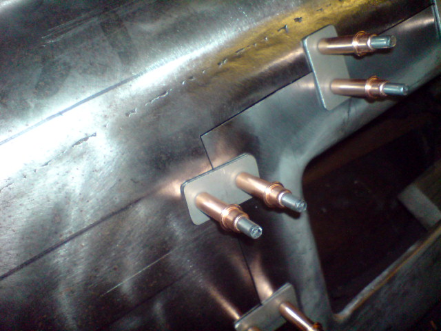

here's a picture of the me welding up the boot lid before I cut the number plate recess out, and its looking much better at the bottom before Ive welded it

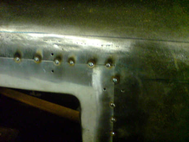

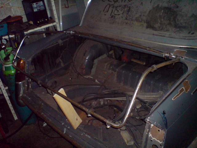

and here is a standard boot lid

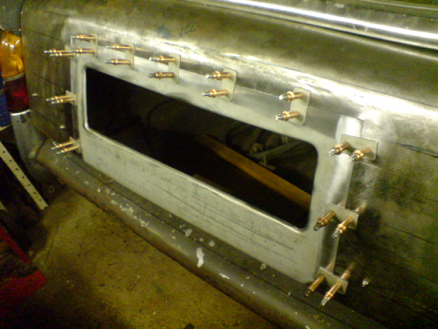

its looking like my welder is welding too hot on its lowest setting, so Im thinking about modifying the welder to have a pulse function to lower the heat input. when I say pulse it will only be on and off but thinking along the lines of having a longer first pulse say 1 second to build up enough heat for the first tack and then to pulse on and off at 1 pulse a second but with variable on/off times to control the heat input. pulsing circuitry can be done fairy easily with 555 timer chips and I'd just need to use the connection from the trigger to operate it and then have the output from pulse circuit to operate the relay on main board (which is what the trigger in the torch handle does).
does this sound reasonable to have a play with, trying to automate the pulsing that I did with the trigger by hand?
