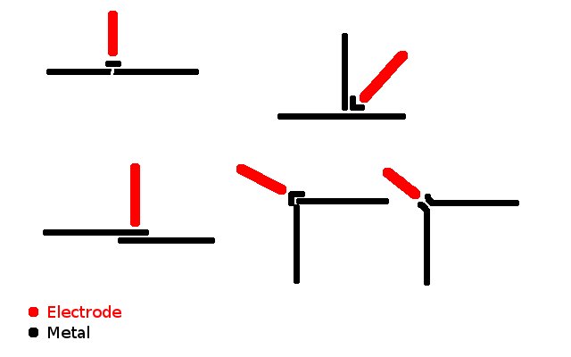

George... I would have thought, you would have had better results, by setting up your joints differently...
Which begs me to ask the question: Given the rule of "diminishing returns", how do you expect to learn, & improve, with your choice of set-up?
Knoba - many thanks for your very helpful diagram and suggestions. I will definitely try those approaches. To answer your last question, I hope to learn and improve by my mistakes and via useful inputs from kind people like you.

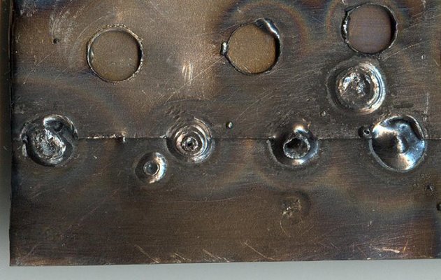

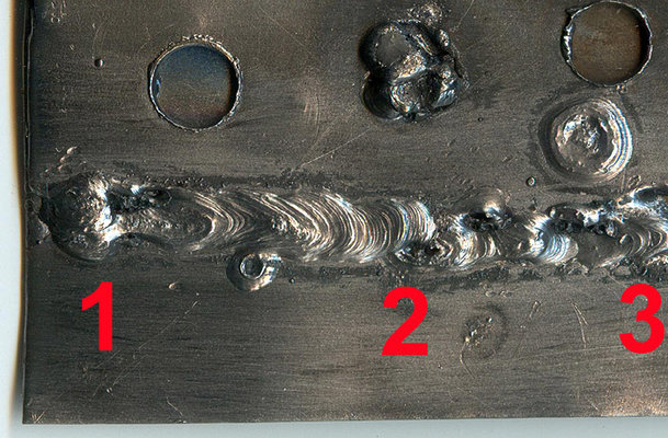

oilcooled - has your sister already tried arc welding thin sheet steel? If not, perhaps you could ask her to confirm whether your confidence is justified. I'd be very interested to see photos of your sister's welding, or yours, if you have anything useful to contribute like shenion and knoba.
Also, should I continue posting here on this 1mm sheet project, or open a new thread?
