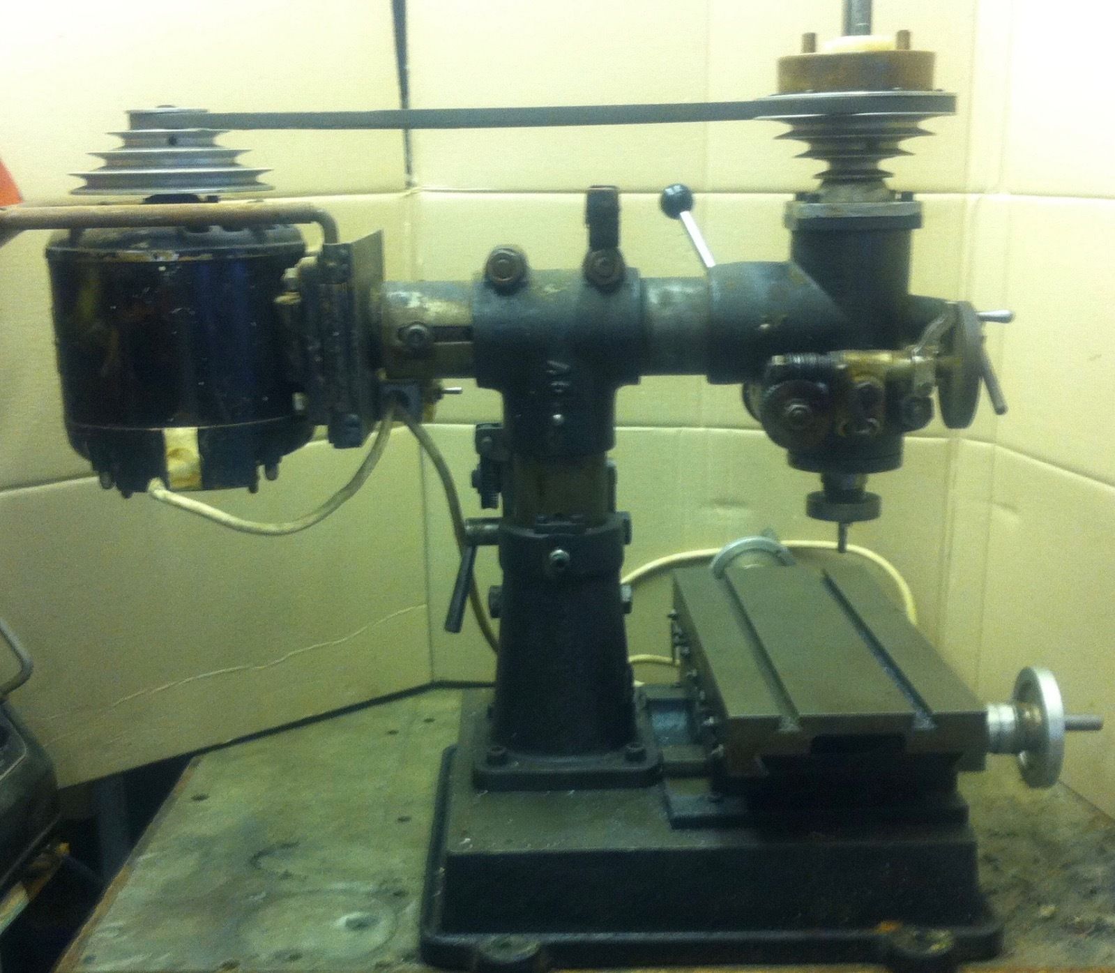

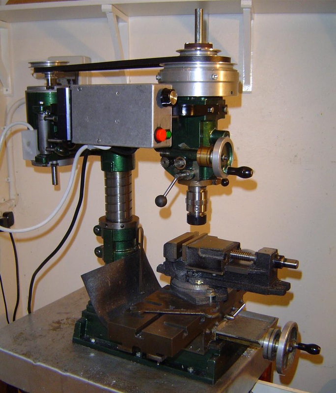

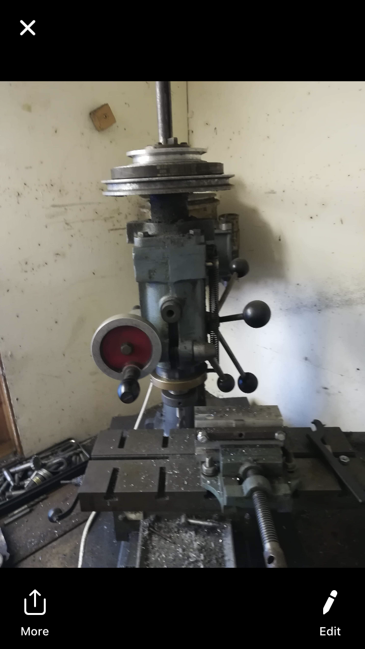

Indeed the spindle nose is myforg thread. The drawbar Is 1/4" so you need to make a fitting to hold a 3/8 or m10 mt2 tool holder
The vertical movement is adjustable but the original design allowed the post to swivel, which limits the working mivement to 2" on the quill.

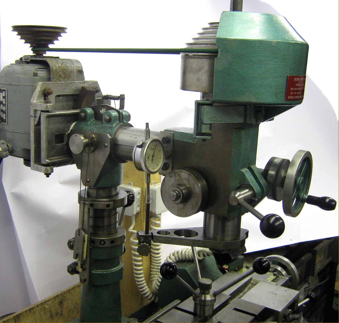

the dore westbury 2 is a better machine than number one
so to help you out

It doesn’t even look like a mk1 the pulley on the top is differentmark 1
mark 2

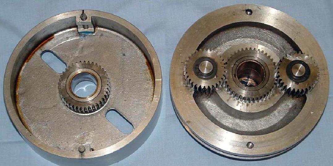

the extra gears part is this
I was referring to the brass looking thing on your picture I hadn't noticed the pullyfrom that view no but spin that pulley around and appears to be mark 1
everything else is mark 2 not mark 1

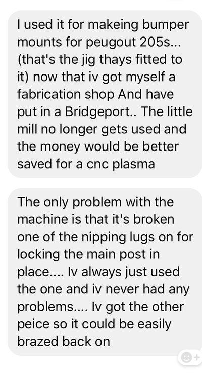

Realistically they are both out my budget
It looks like it's got a round column which can sometimes give rigidity issues.
