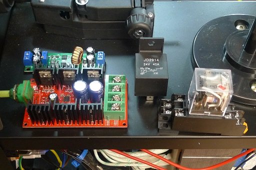

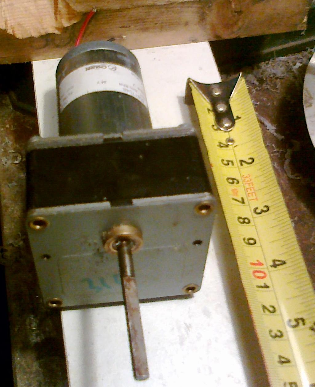

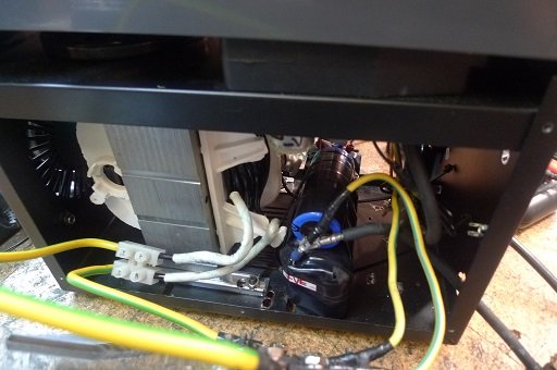

Ref the motor speed control. The motor in "normal" operation (connected to the feed unit/gearbox) will run at a very fast speed and the gearbox reduces this down a lot. Motor rpm = probable 1000, final output from gbox rpm = 20 rpm ! The DC geared motors on the equipment I work on have a 3000 rpm motor and three possible gearboxes of 48, 210 or 310 output with lots of torque. see pic

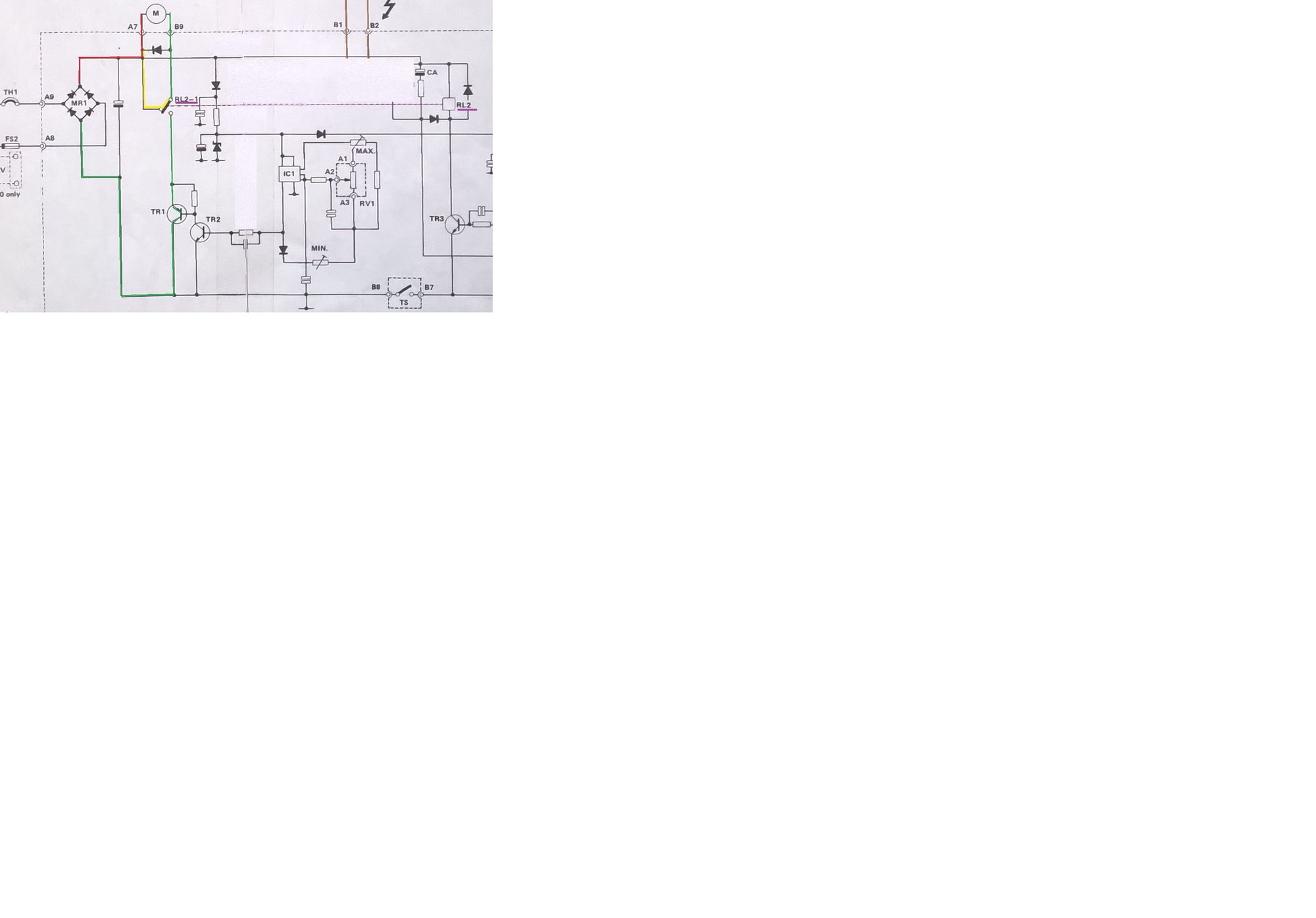

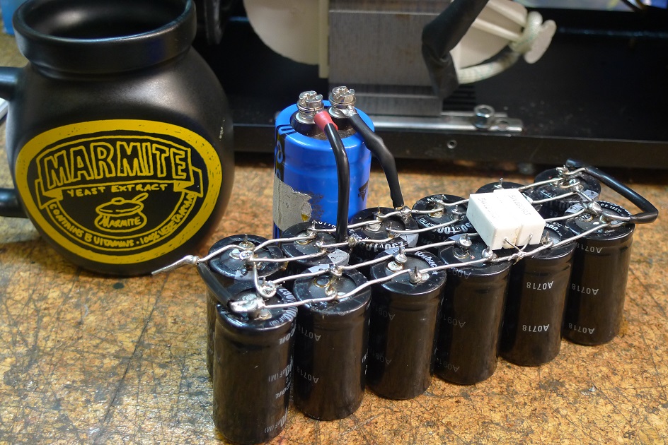

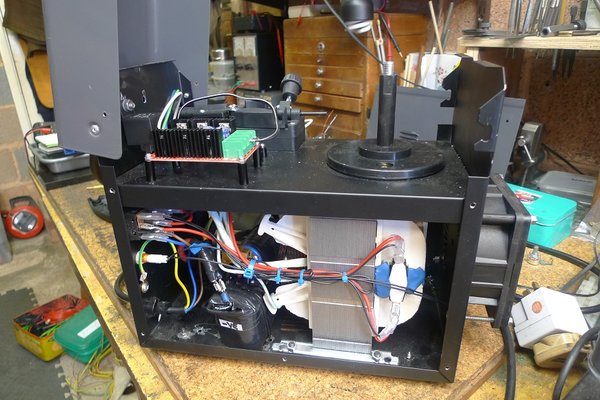

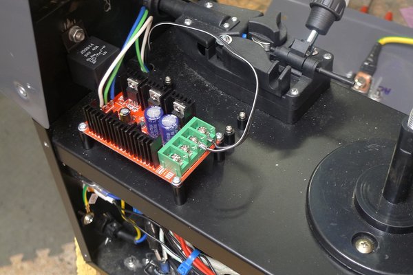

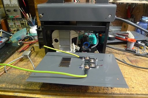

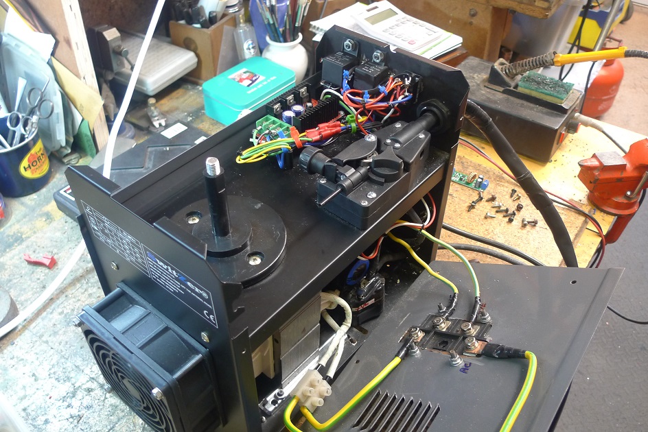

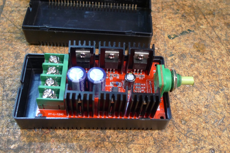

The MOV should be across the diode pack output. If you look at the pic in post 16 up and to the right of the top white circle is a light brown disc device, this is the MOV in that machine. Looking at the 2nd and 3rd diagrams in post 10, they are shown as an oblong device with a stepped line through it at an angle. Clarke seam to fit them before and after the diodes, go figure...
. Note also if using the Clarke diagrams that they sometimes have a center tapped transformer (pro 90) and at other times a standard transformer (150 TE)

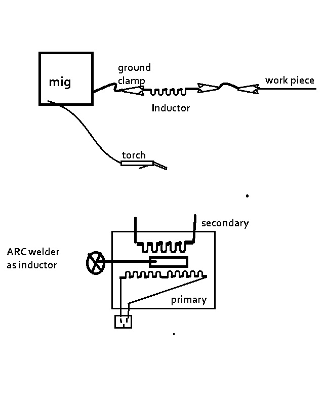

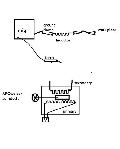

With the inductor you should be able to experiment "externally to the welder with the number of turns using an old car jump start lead connected to the work return lead. Ref the wall wart. Fit the socket on the outside and run it's thin DC lead into welder until a better sized/shaped psu can be got.
. Note also if using the Clarke diagrams that they sometimes have a center tapped transformer (pro 90) and at other times a standard transformer (150 TE)With the inductor you should be able to experiment "externally to the welder with the number of turns using an old car jump start lead connected to the work return lead. Ref the wall wart. Fit the socket on the outside and run it's thin DC lead into welder until a better sized/shaped psu can be got.
