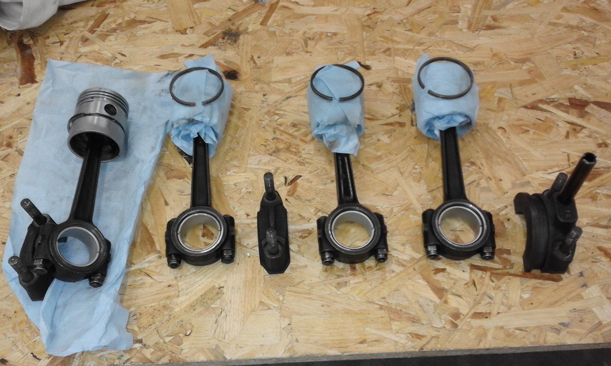

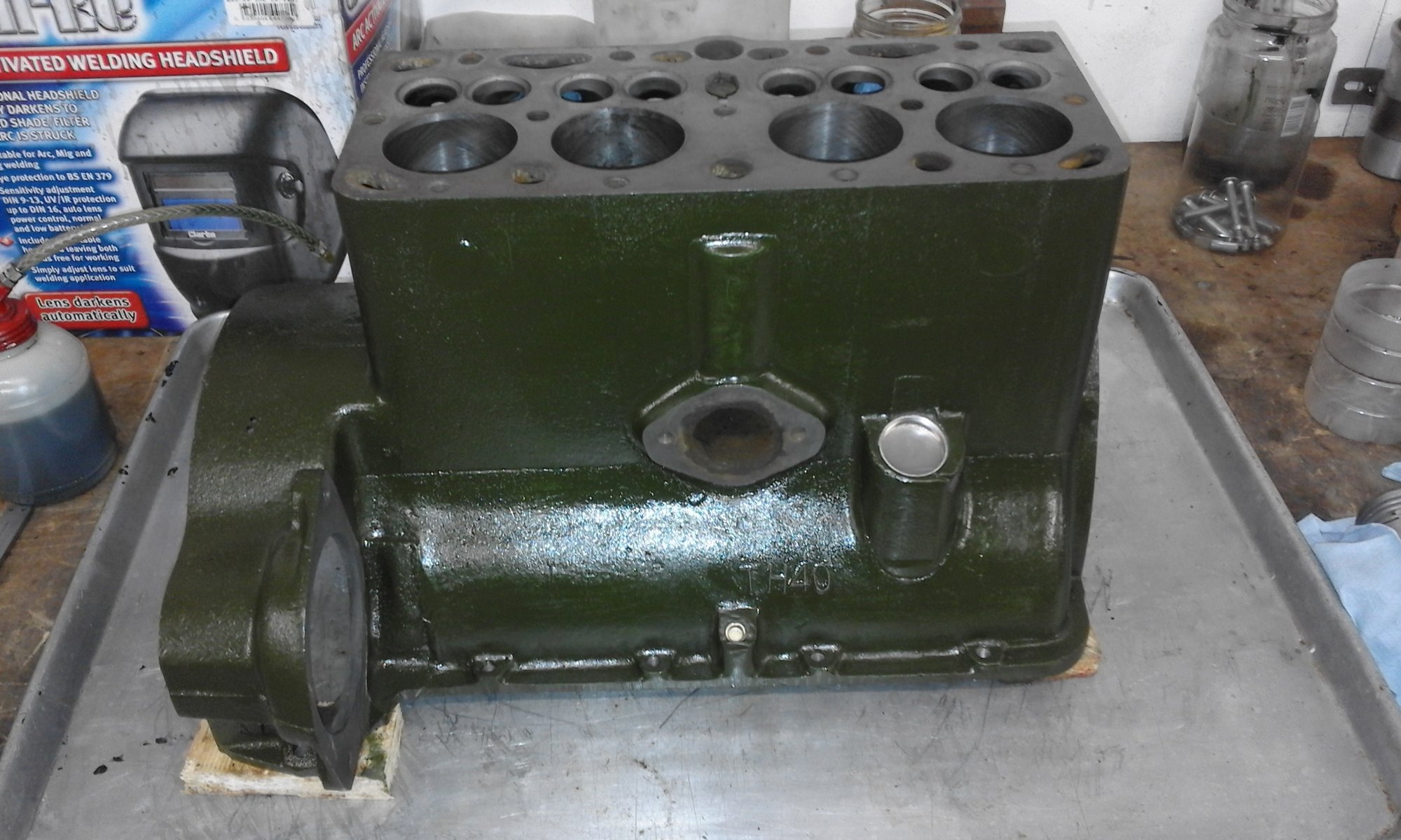

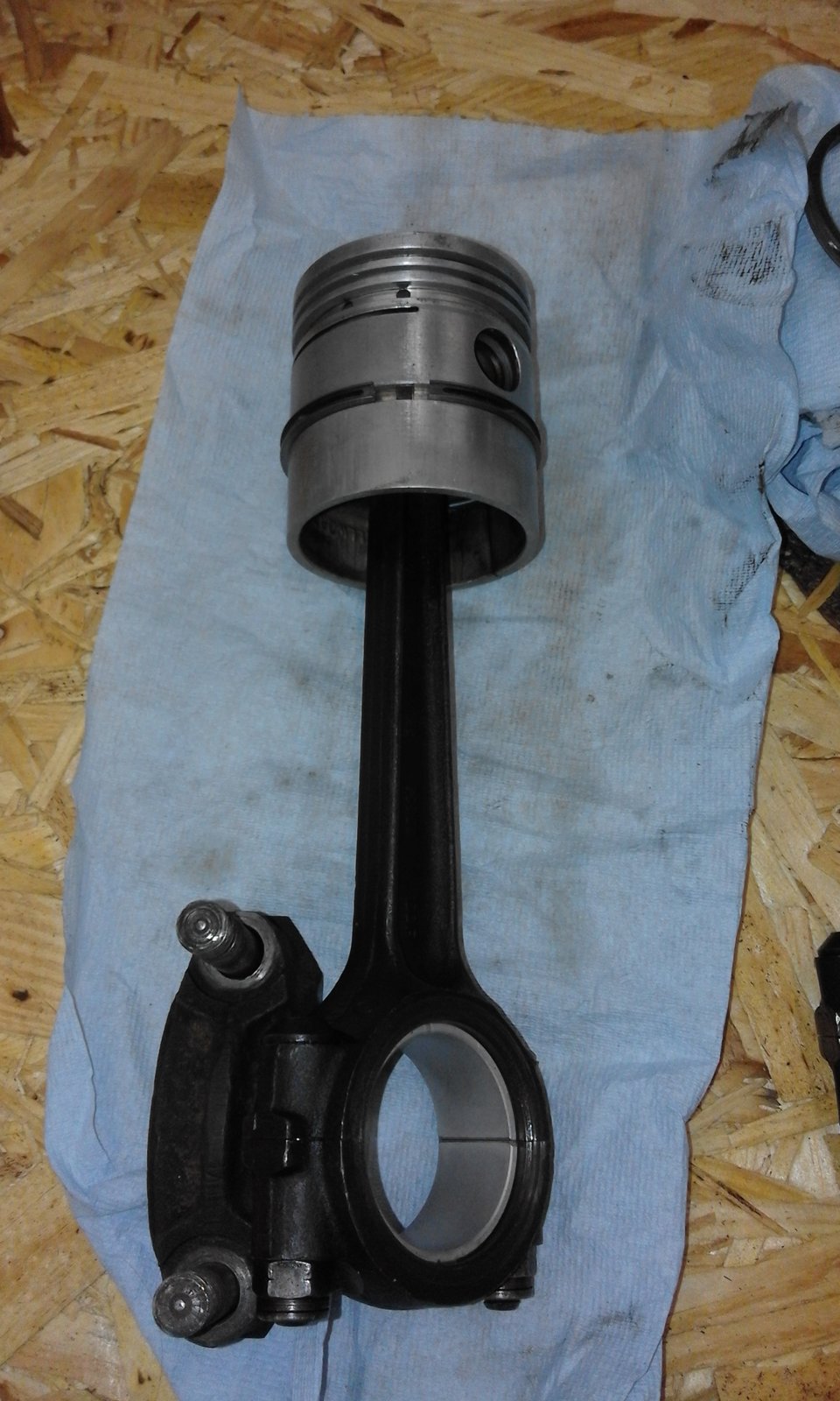

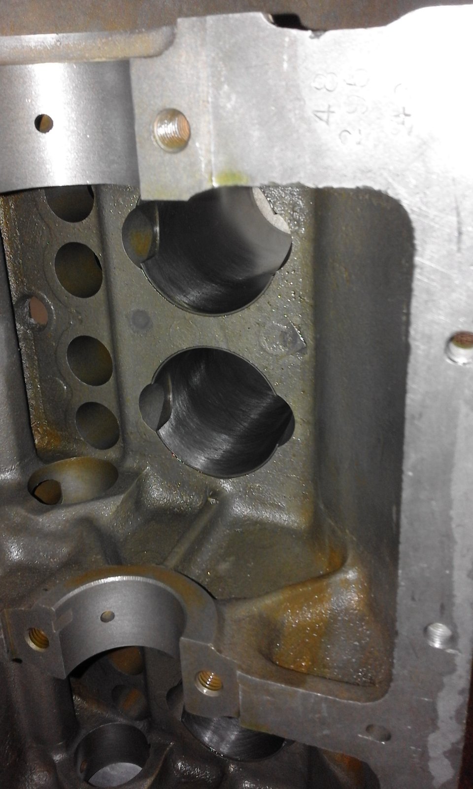

Can you not feed the ringless piston up through the block, fit rings and drop it down?
Just do the second bit - ie push piston through, fit bottom ring, push down, then repeat with the top set?Just fit bottom ring, push the piston through & fit top rings then use a ring compressor in the normal way. If your concerned about it, this might be your best way.
