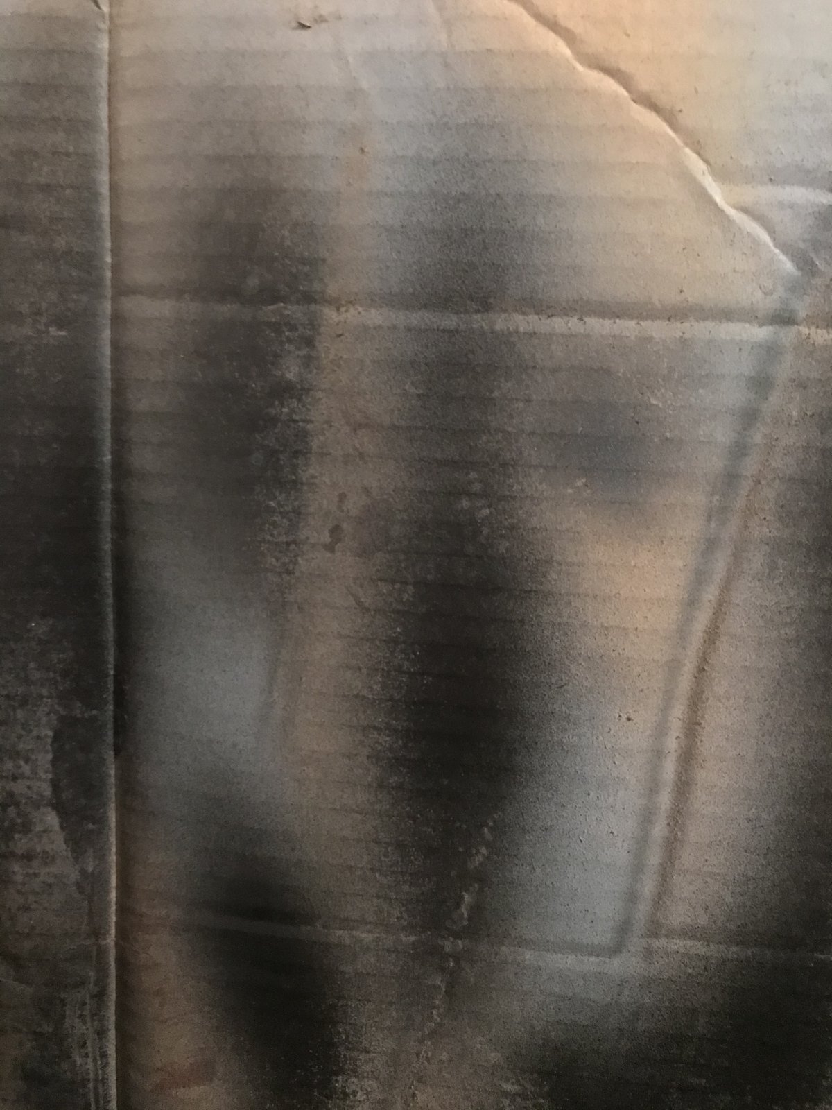

All my test areas on cardboard look like the far left unless I hold trigger for 2-3 seconds. Just wasn’t getting the wet coat I needed. Thanks.Try this video from ppg about setting up a spraygun. They did have one that was a bit more detailed.

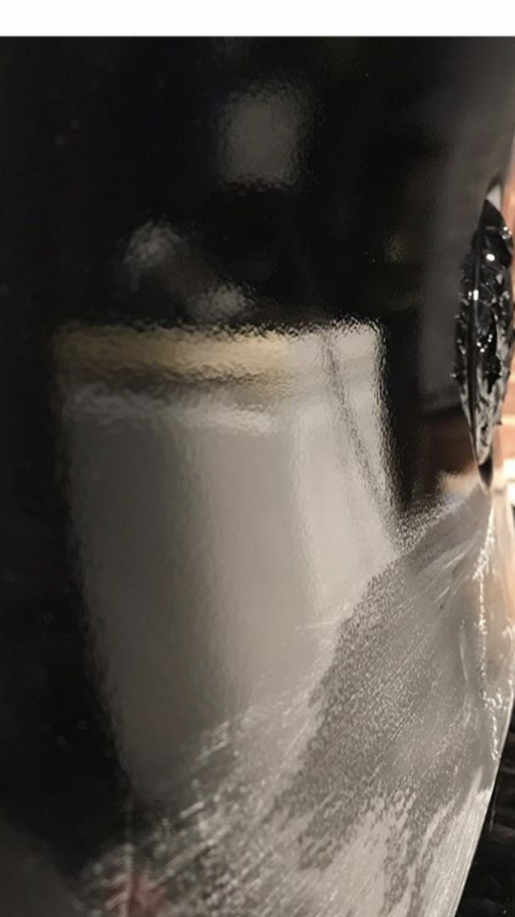

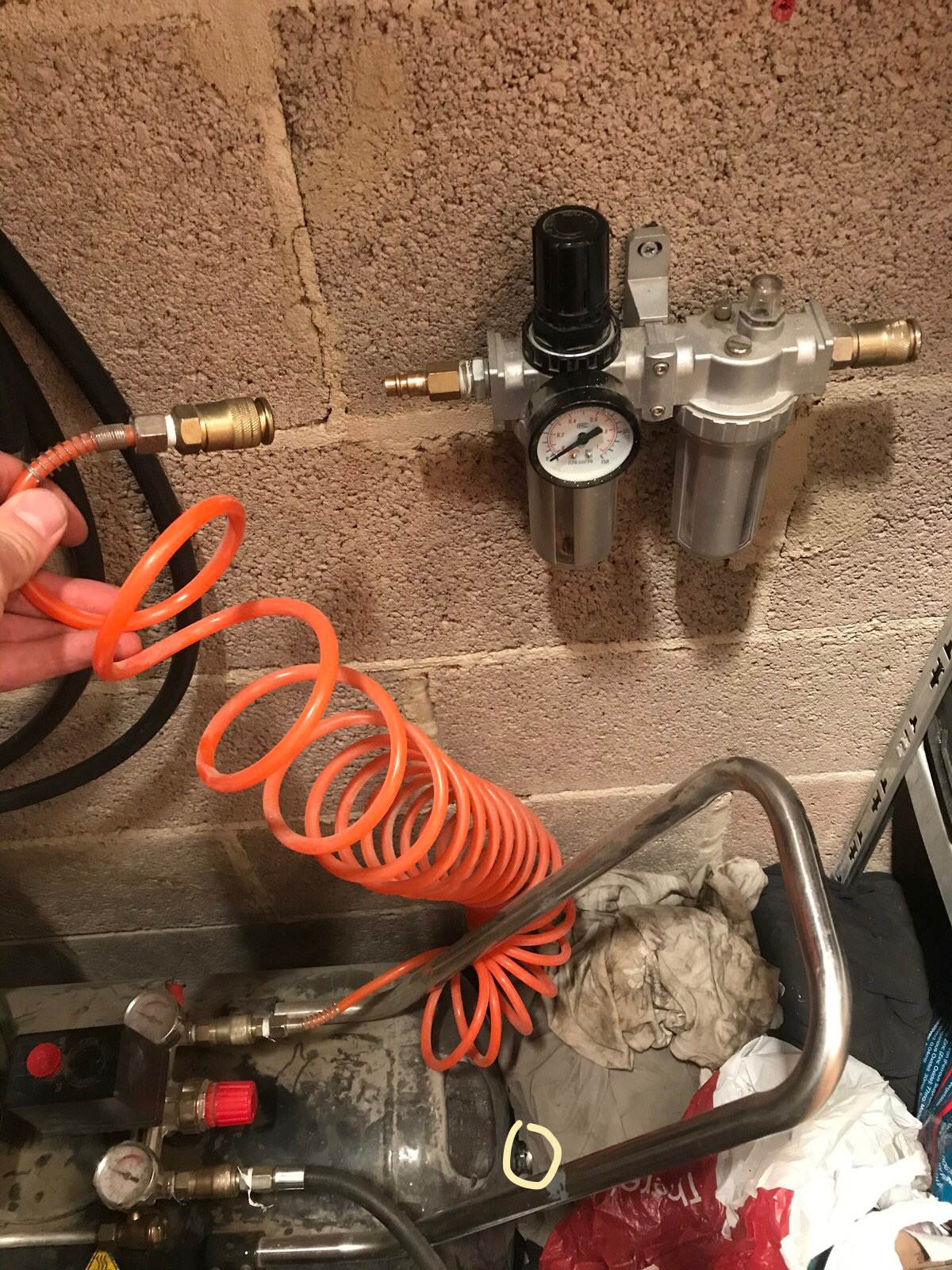

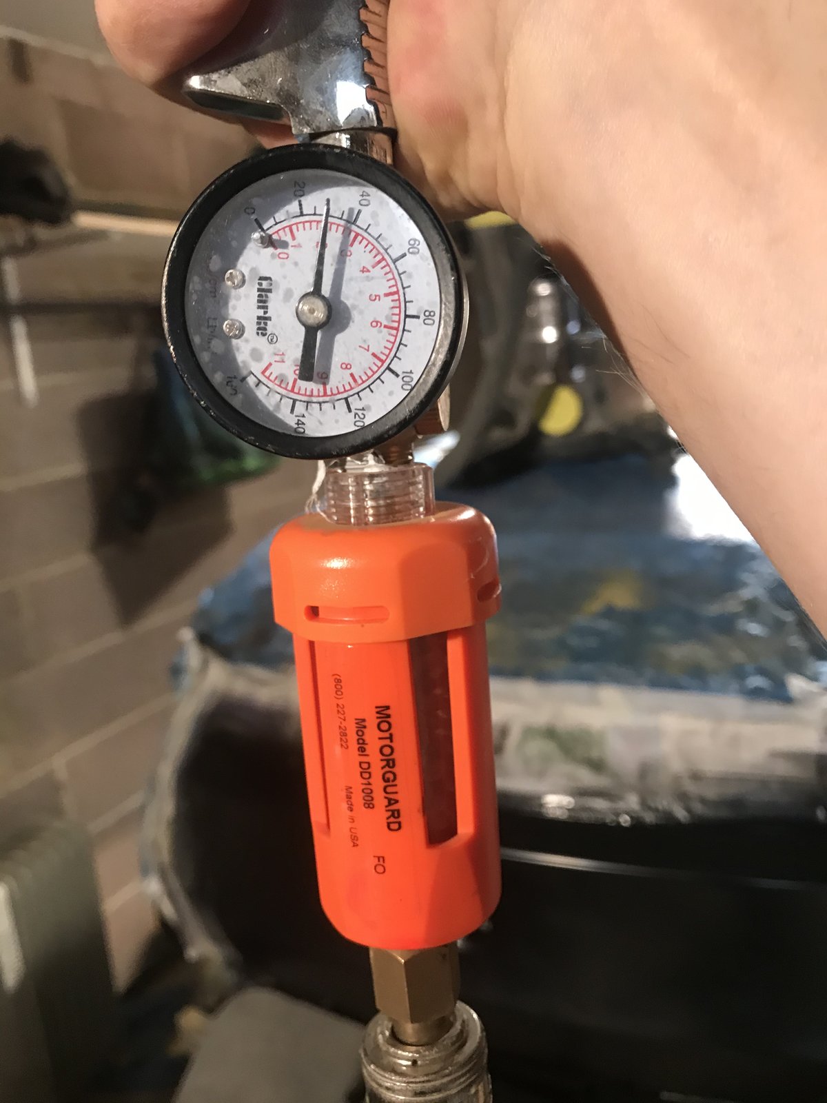

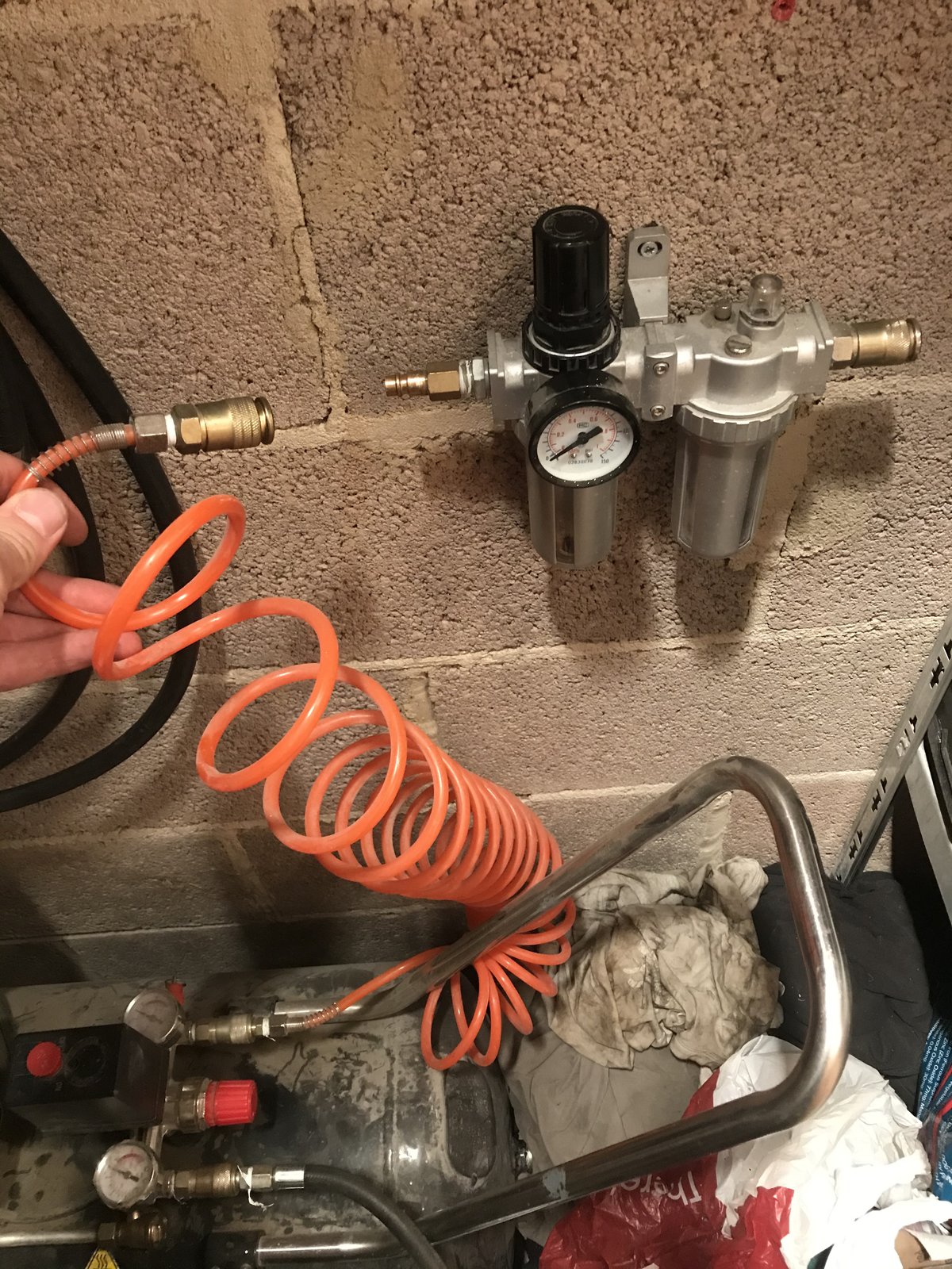

I don’t know if it’s thinners that have caused some of the issues for sure but I have blooming on a test panel with 120% as well. Maybe it’s just where I pilled on too much paint trying to smooth it all out to no avail. I just broke my regulator trying to get it past 60psi. Perhaps I couldn’t get enough pressure because of the small coil hose leading up to it. I know those coil hoses are rubbish for trying to gun off bus wheels etc at work. I’ve got the hose running directly to the desiccant filter and the mini regulator on my gun now. Finally getting 30psi trigger with 80psi input pressure.2bar should be a good starting point but you may find adjusting air pressure can help with finish. I’ve never used bar coat but would too much thinners cause the reaction you have as it looks like you have lots of basecoat applied if it’s taking a long time to dry

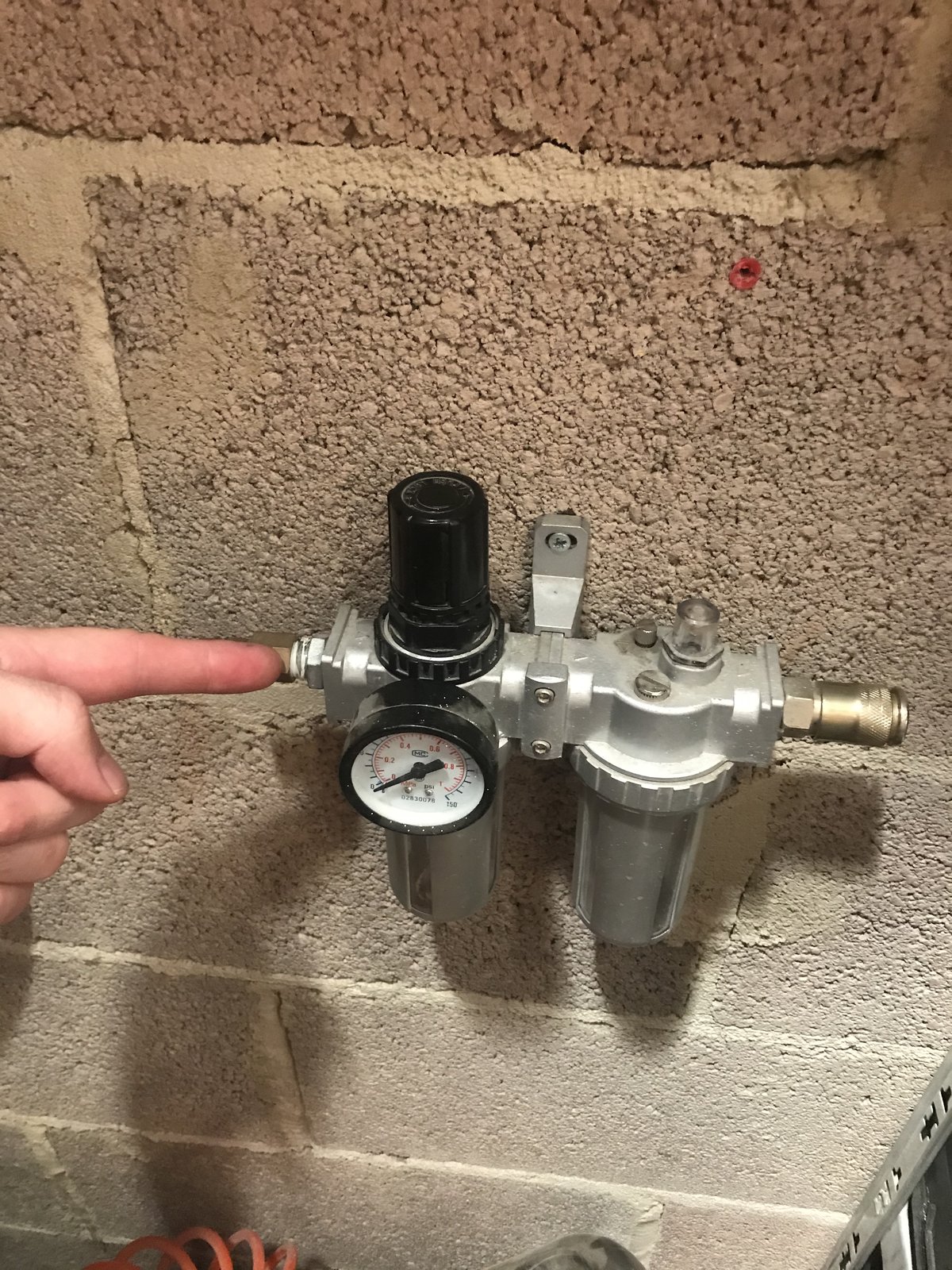

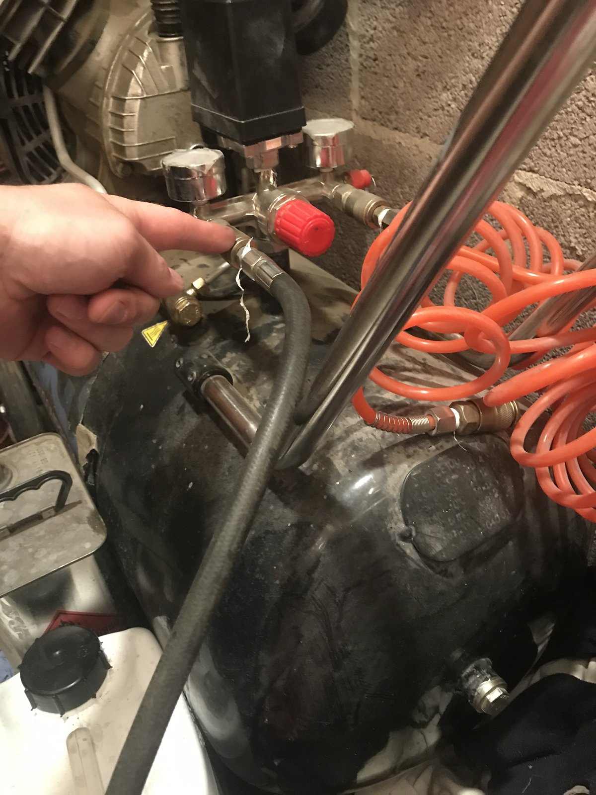

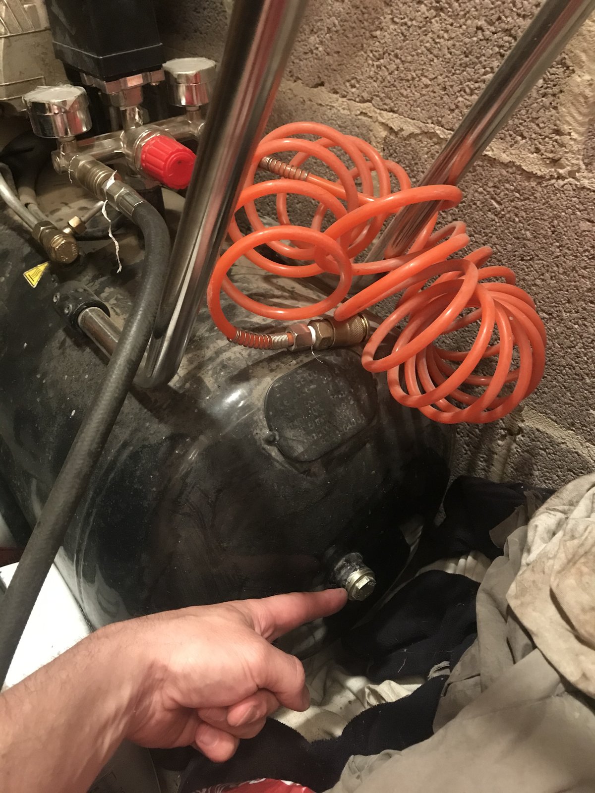

I don’t have a clue how to connect it to the end of the tank? Is there a spare plug I can remove from the tank then? I’ll have to have a look.Rather than connect the regulator on the wall to the regulator/manifold on the compressor connect it to the end of the tank. View attachment 228452
Replace the hose with something less restrictive if possible

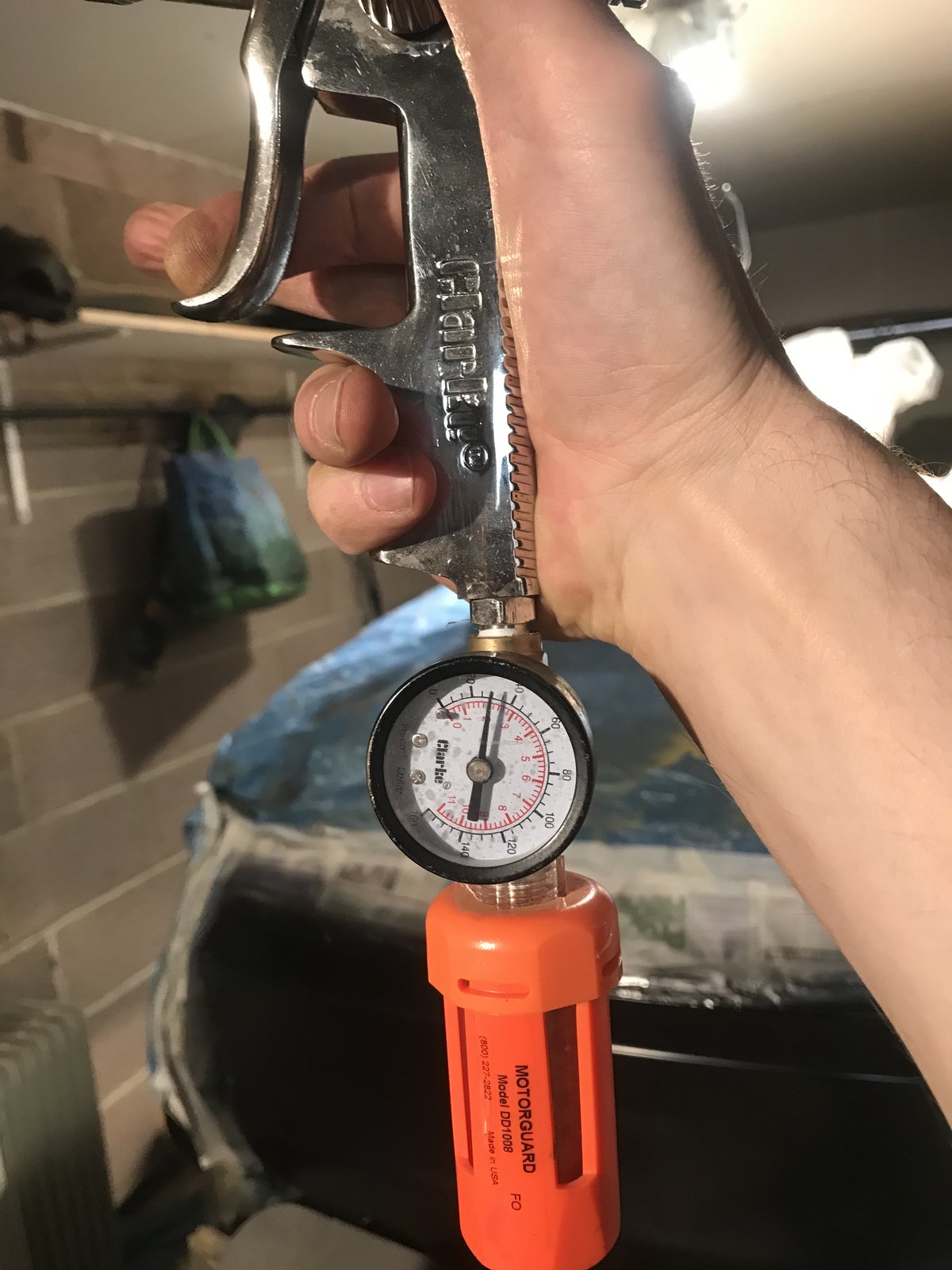

Top right is indicative of what I was getting if I pulled the trigger in for 1 second. The other 3 spots took 2-3 seconds to build up. I’ll retry at 30 psi.show us your test spray pattern on the wall, we'll be able to see from that where the problem lies.

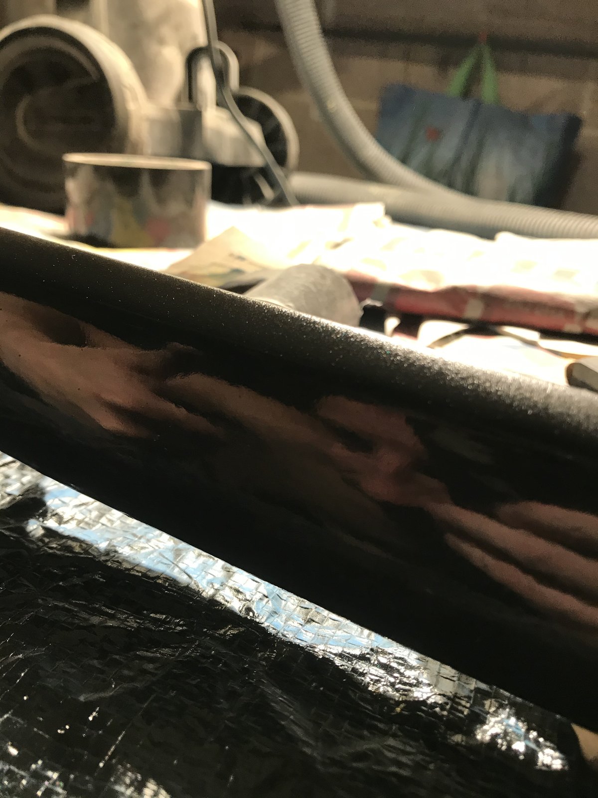

Thanks for the help guys. Whacked the pressure up to 30psi and I now have this type of finish with 1k products. About the same amount of orange peel I’m seeing on a lot of cars. It will do with the cheap gun I’ve got. Finally I can see my reflection without having to cut and polish.
I’ve got some tiny solvent pops across the surface but they can be cut out a week or two after I spray the boot. I’ll just make sure I do a few coats of lacquer. I was having to slow the gun down a bit to get coverage. I wound out the fluid needle but it doesn’t want to give me a great deal more paint. I might leave it to flash off for 15-20 minutes between coats. Give it a bit longer for solvent to evaporate. Bit longer than 10. I’ll have a play around again tomorrow.Definitely lots better.

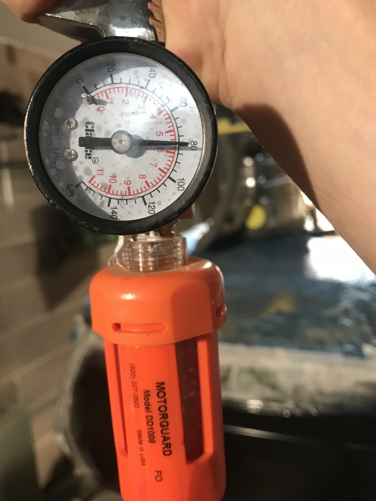

No. It will let you do a coat of paint before it cuts in again. I’ve got a desiccant filter at the gun for now. My new regulator/water trap arrived. Finally. I can’t fit it directly to the tank yet because I need a 1/2” - 1/4” reducer. I was spraying 3 ft away from a flood light. The thermometer was showing 23 degrees and that was no where near the roof of the car where I was spraying. The temperature could have been over 30 up there. I felt hot when I was sanding it there. I waited about 10 minutes between each coat so it may have been too much heat causing the solvent pop.Does the compressor run constantly when spraying?
