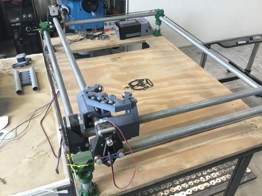

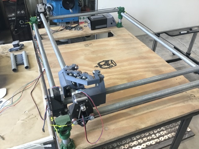

Hello! Can you help? My MPCNC has a backlash of 2 mm axis z. If not laziness, share STL under the thrust bearing and the size of the bearing for ordering, as well as the blue T8 coupling, please.
OOOOOoooooHHHhhhhhhHi, try this - https://www.thingiverse.com/thing:4079935
Bearings are F8-M16 and coupling is just a 5 - 8mm
Anything you want to know that I havnt posted here feel free to ask. Really need to update this
Cheers that'd be great. https://www.prusaprinters.org/prints is a good alternative for thingiverse btw.

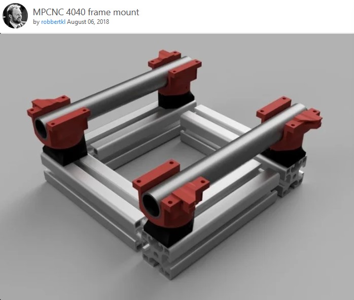

I've a leadscrew, coupler and nut on its way from amazon to finish the Z assembly (when I printed it all it was M8 threaded bar)
But now I've seen this: https://www.thingiverse.com/thing:3036995
And I remembered I saved a load of 4545 from the skip a while back so I'm printing new feet now too. Probably worth printing the mid-span supports as well. Gaaah it never ends![]()

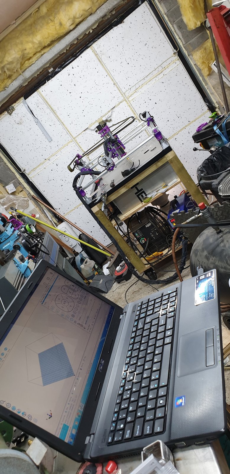

My current plan is to get the tube first and then start printing the bits and building the machine

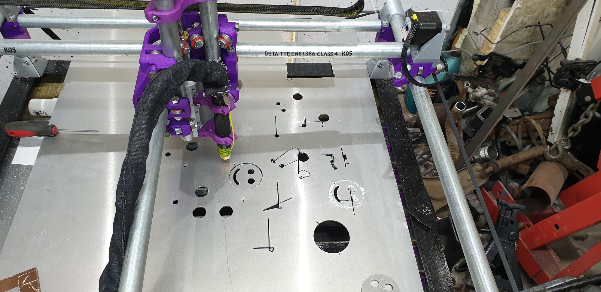

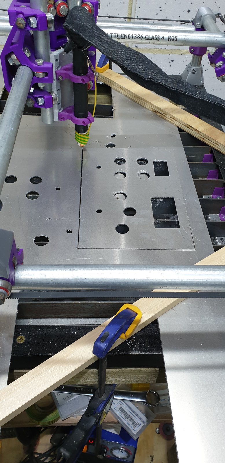

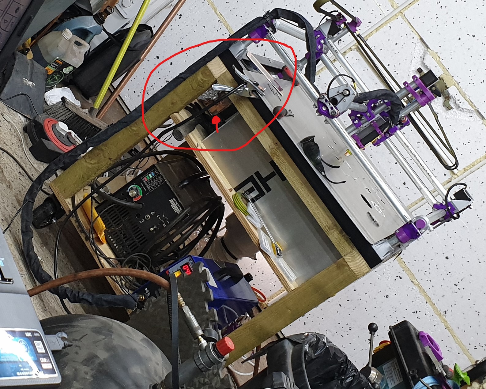

it either crashed and just froze as the whole thing reset of got random movements as seem above.

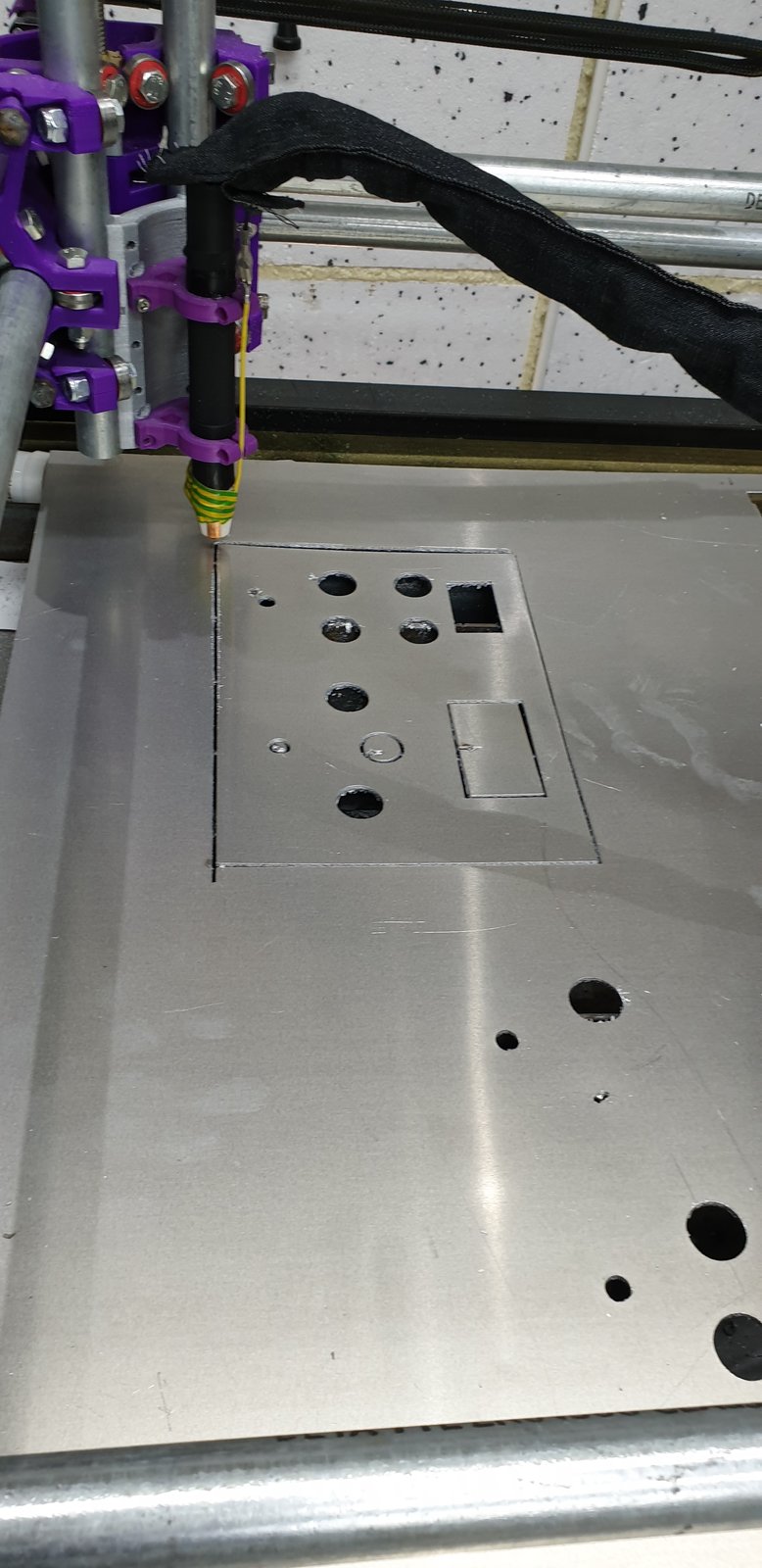

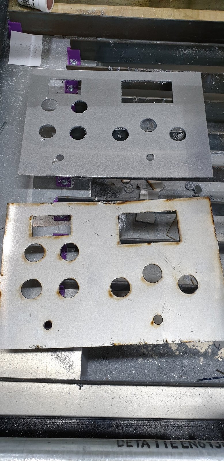

sort of, plate warped and the torch got stuck, lost steps and its a bit trapezoidal
very impressed it cut the entire plate on the pilot arc! needless to say the pilot arc wire was very warm after that.
i forgot how annoying i find windowsthe G4 commandFound a post saying to add the command G4 S0.7 to the cut start command, this is supposed to start the plasma and pause the program for 0.7 seconds to let it pierce, sounds good, didnt work! But think in hindsight its because i wrote g4 s0.7 think capitals matter![]()
