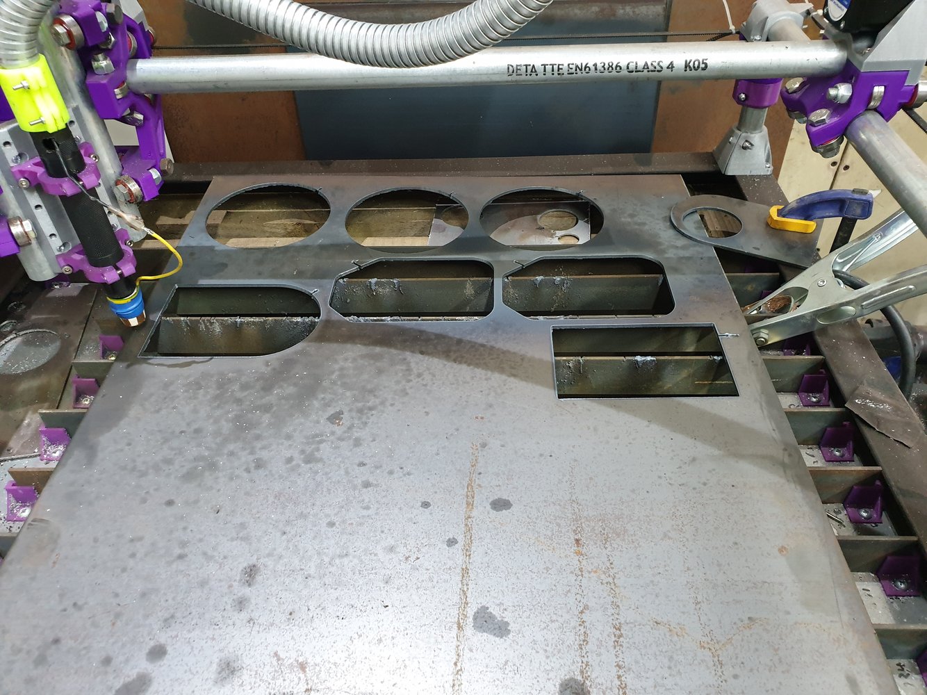

Are you adding that manually to the code or are you getting estlecam to add that?
What are you using to switch the plasma on and off?
As i have got to the stage where i can design something in Fusion 360 export it as a DXF and then draw it using a pen
So next is either a cheapo router or get the plasma to work
Normally a G4 will use the P word for the time, so G4P.7 but it may be the S word on that control.
For switching the plasma on it would normally be M3 and to switch off M5 but again the control being used may have weird commands being used.
Edit
Some controls may require leading 0's such as G04P0.7, some may also work in ms so G4P700 would be the same 0.7 seconds

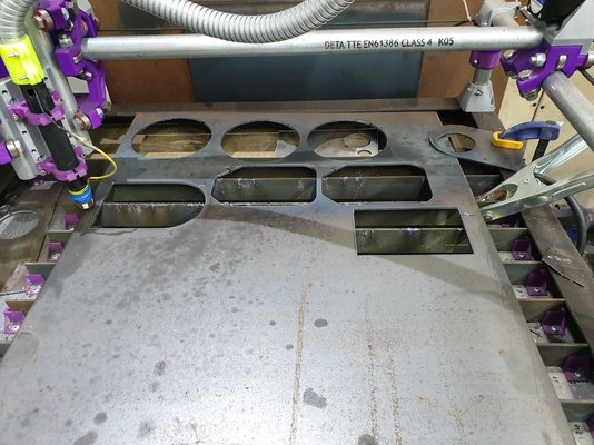

maybe luck? Maybe the kopex helped
I'll take it anyway, now a bit more confident to try some other parts
