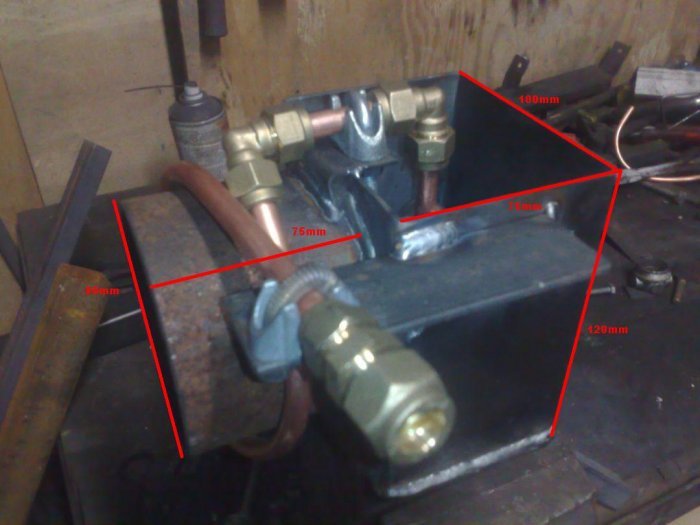

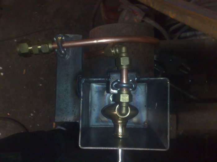

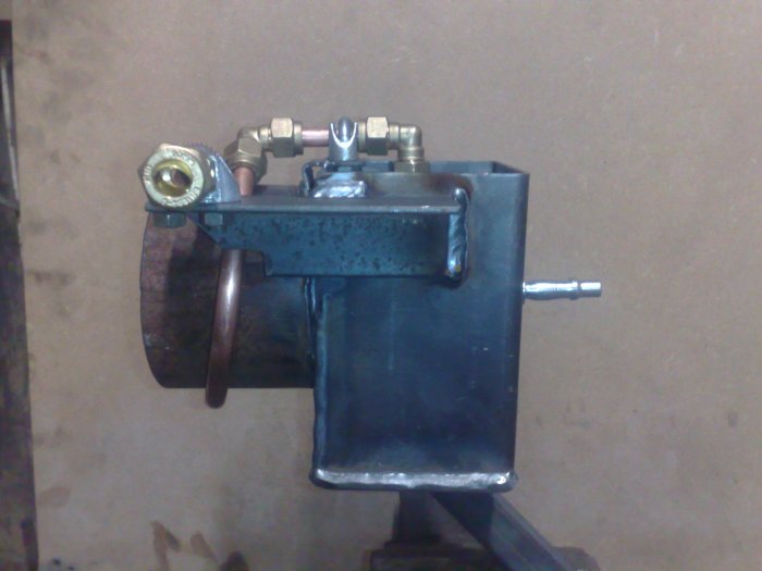

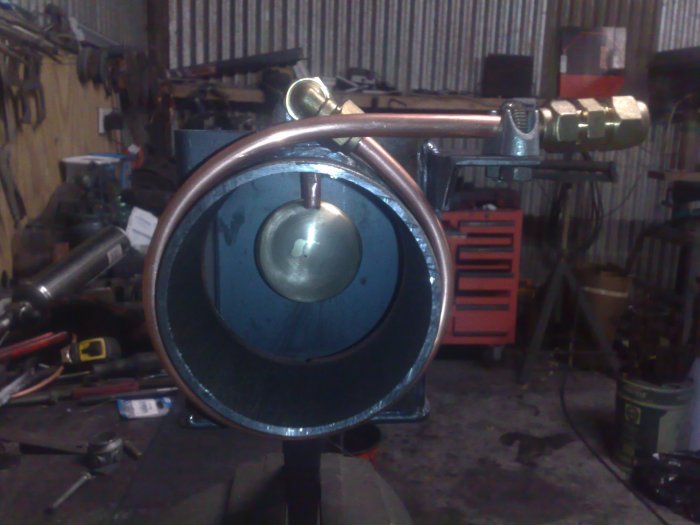

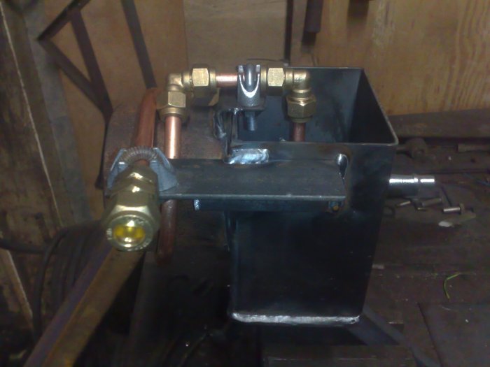

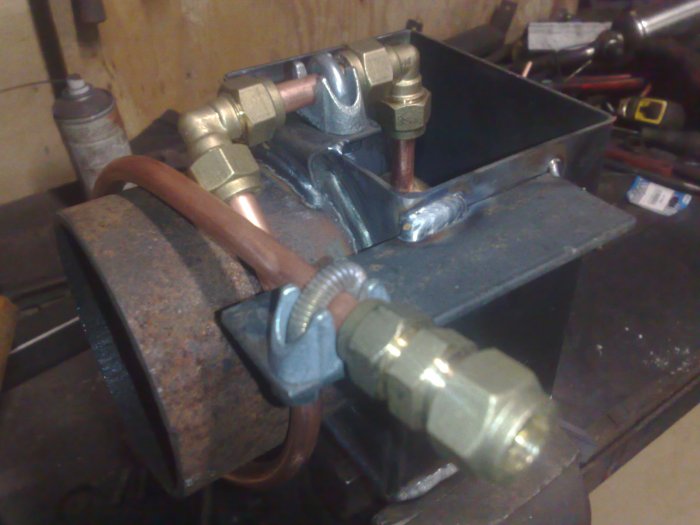

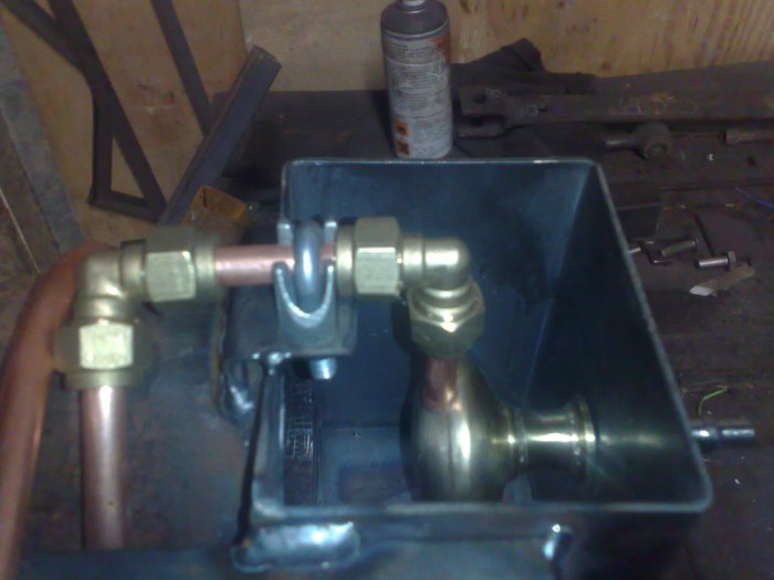

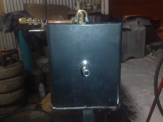

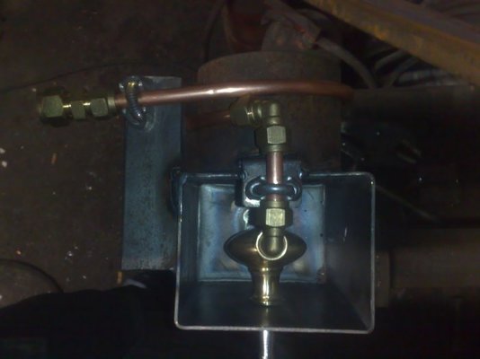

If you do it with one of those nozzles you'll either have to use a siphon type or pre heat the oil.
Thank you for the warning. Do you think the difference is the oil type, or the mechanics of a factory made burner, i.e. how they get a mist and you couldn't?
