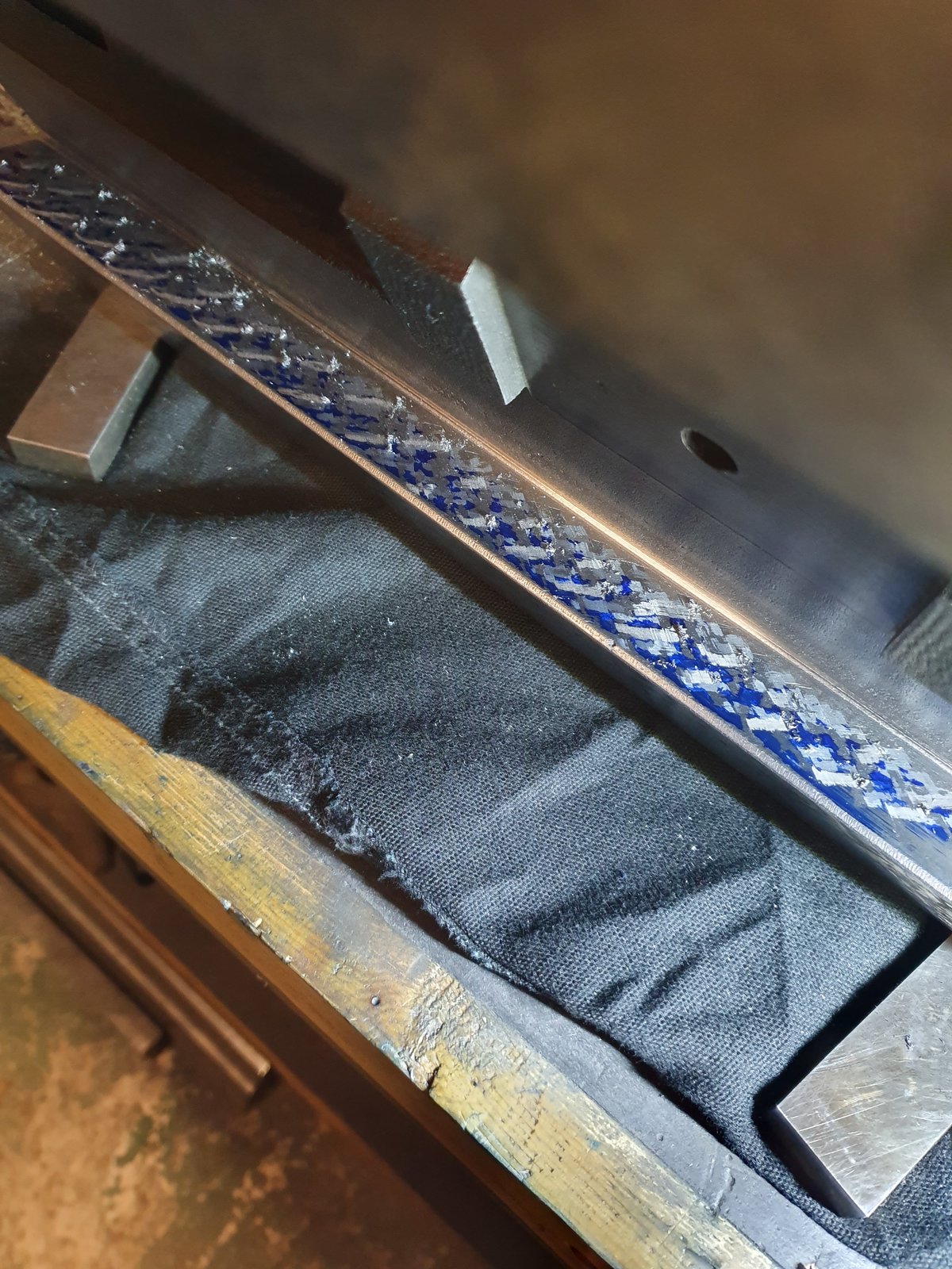

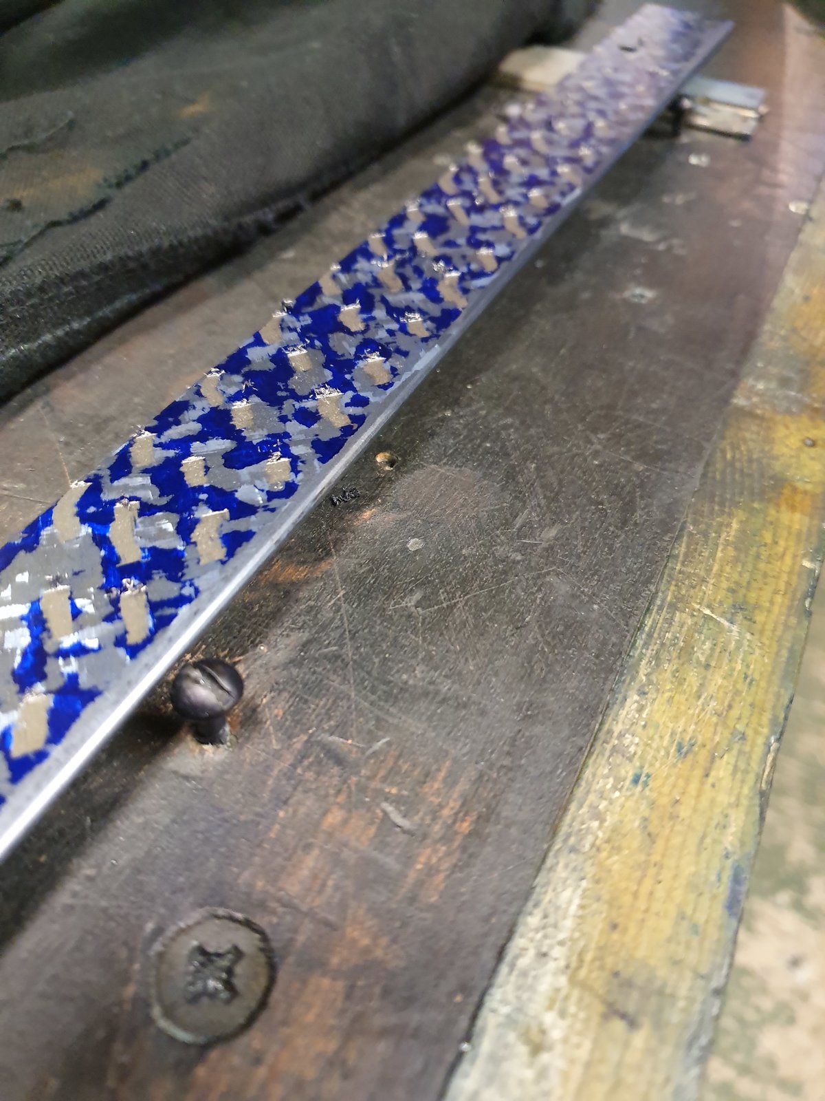

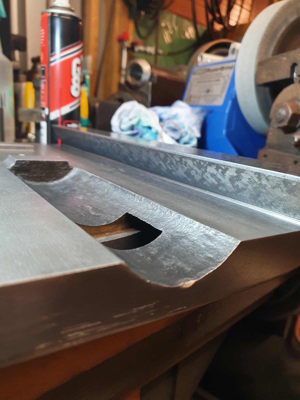

That's that relief cut.
Thats a old one
I like coburn power scrapers, but I would as I apprenticed 200yds from where they were made so thats what the old timers had!
Never used one though, as old george mole (ex Herbert and my mentor)said ‘don’t use that boy you’ll just ruin it quicker’
If I could find a coburn Id sell my biax
File misery?That's that relief cut. View attachment 203218 View attachment 203219
I cut them by hand with a Manchester rapidor blade. Takes a while as you can imagine but you get a nice cut and about the right width. I then lightly stone the cut edges.File misery?
No. I do these by hand with a man rapidor blade.How did you make the cut ? Horizontal mill ?

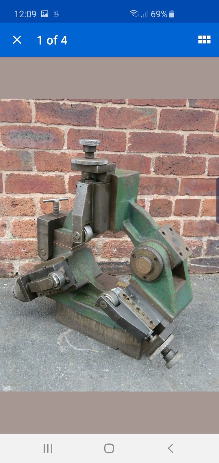

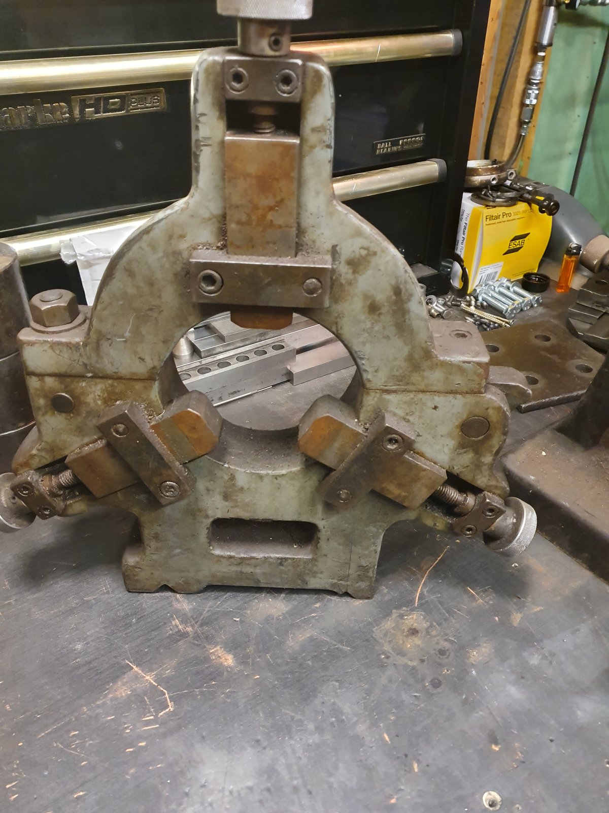

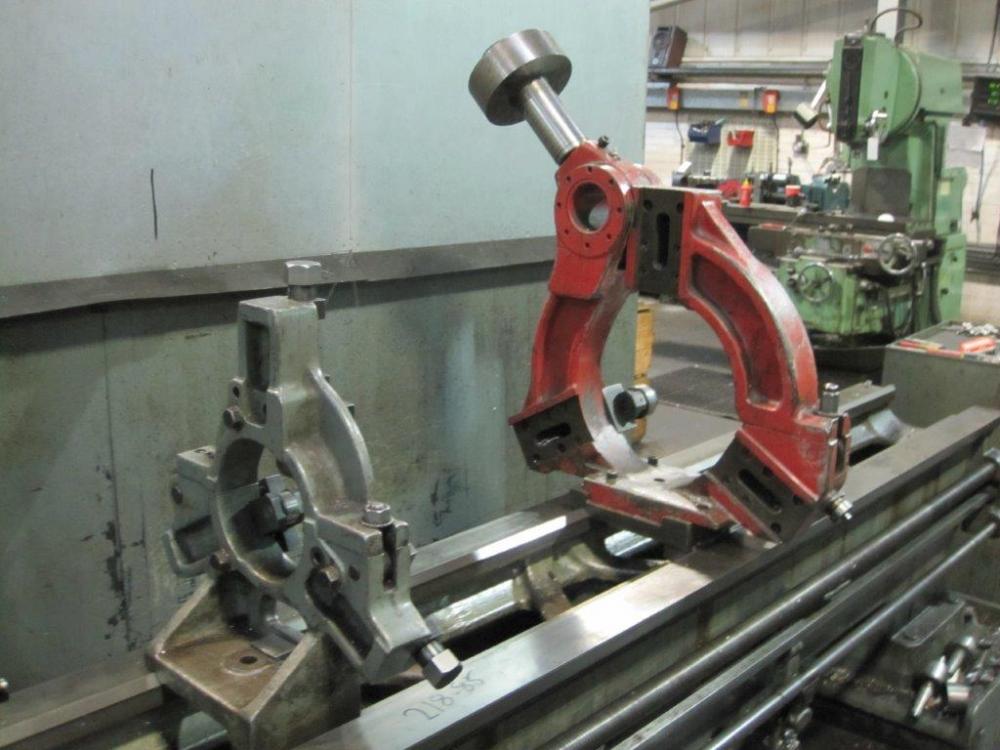

Yes there is plenty of meat in the detachable block to get it st correct height. The bed is 350mm wide of the Harrison. That steady will look really good on there. I noticed there are four bolt holes on the side of the new steady. Not sure what they are or where originally intended forThe detachable base should make it easy to fit but still look right, also looks like it would have originally had a counterweight fitted to the hinged top section?
Ah yes. I see now. Think you are correct. I will do some more research now I know what I am looking at. Thanks for the picture.I found a picture of a large diameter steady for my DSG that I would like to track down and it has a counterweight to make opening to top section easier:
Not sure if that was the intended purpose of the 4 holes, but it seems to fit the bill or possibly for a stop to prevent the top section hinging back too far?
So I have acquired a steady with some real metal and a bit more hardcore...it will be here this week.
Yer. The new steady is my xmas gift to myself. I will give it the treatment over xmasThat'll save you giving the 'wrong' one your meticulous attention by way of refur'b.

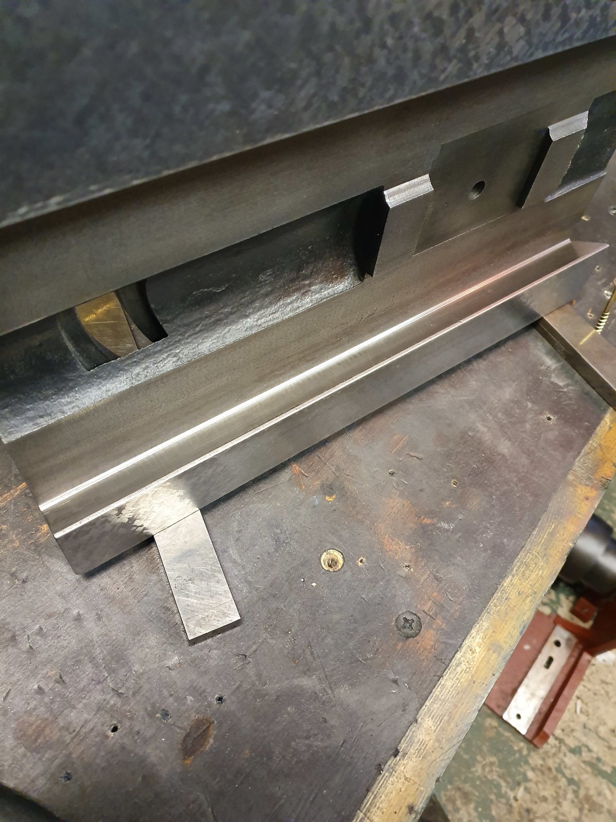

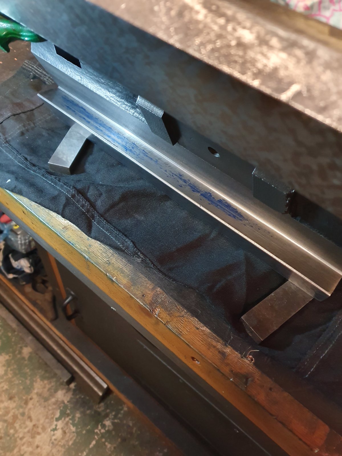

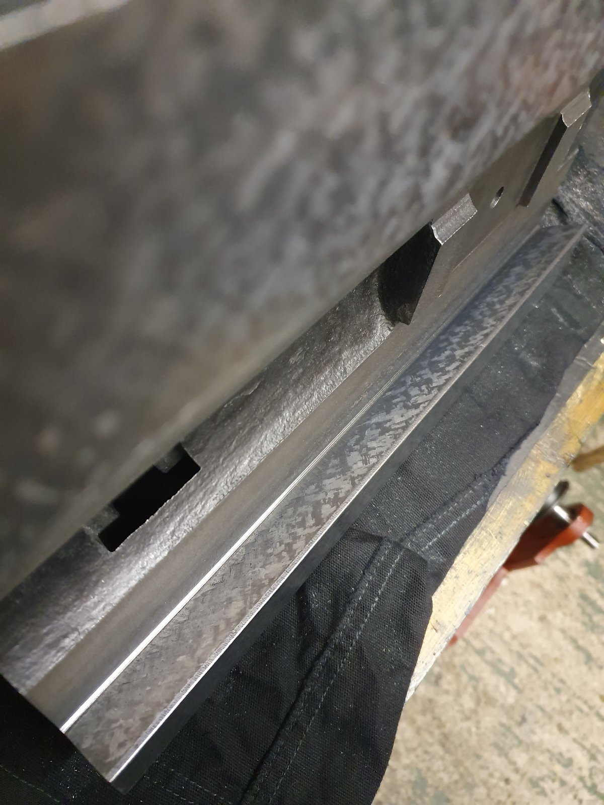

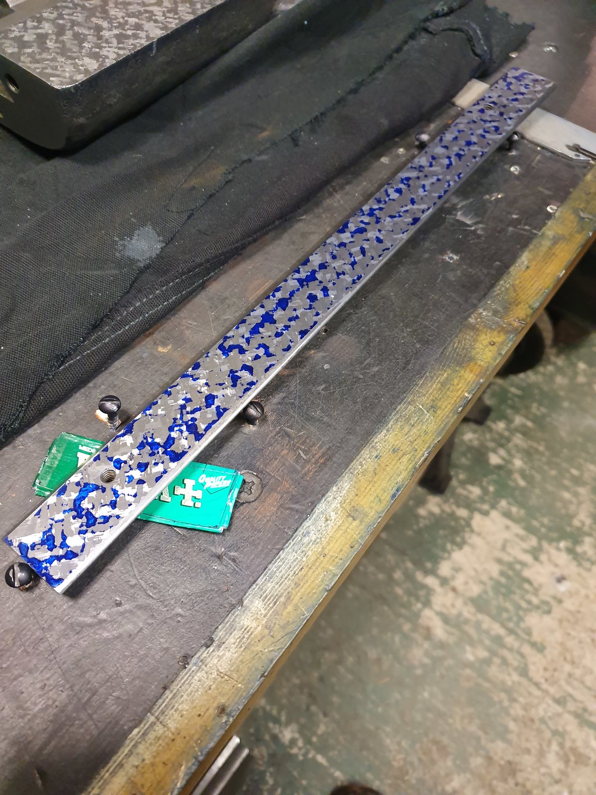

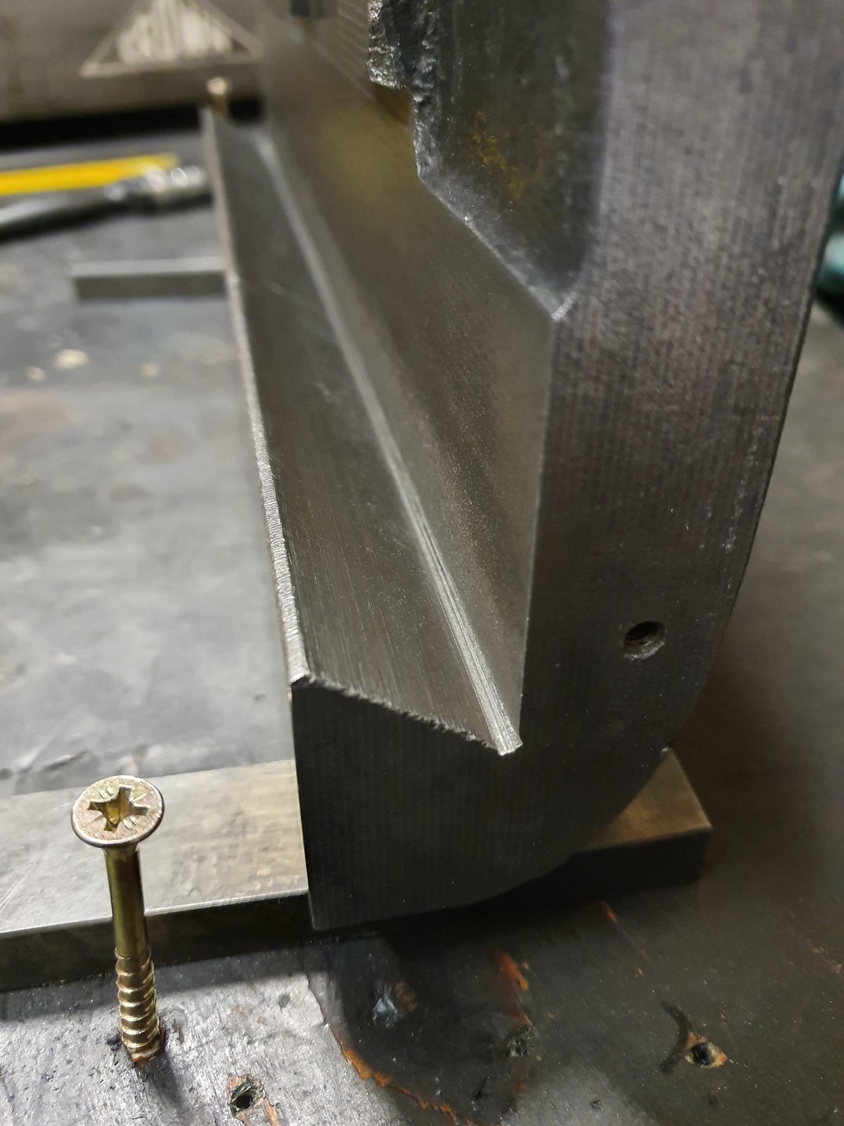

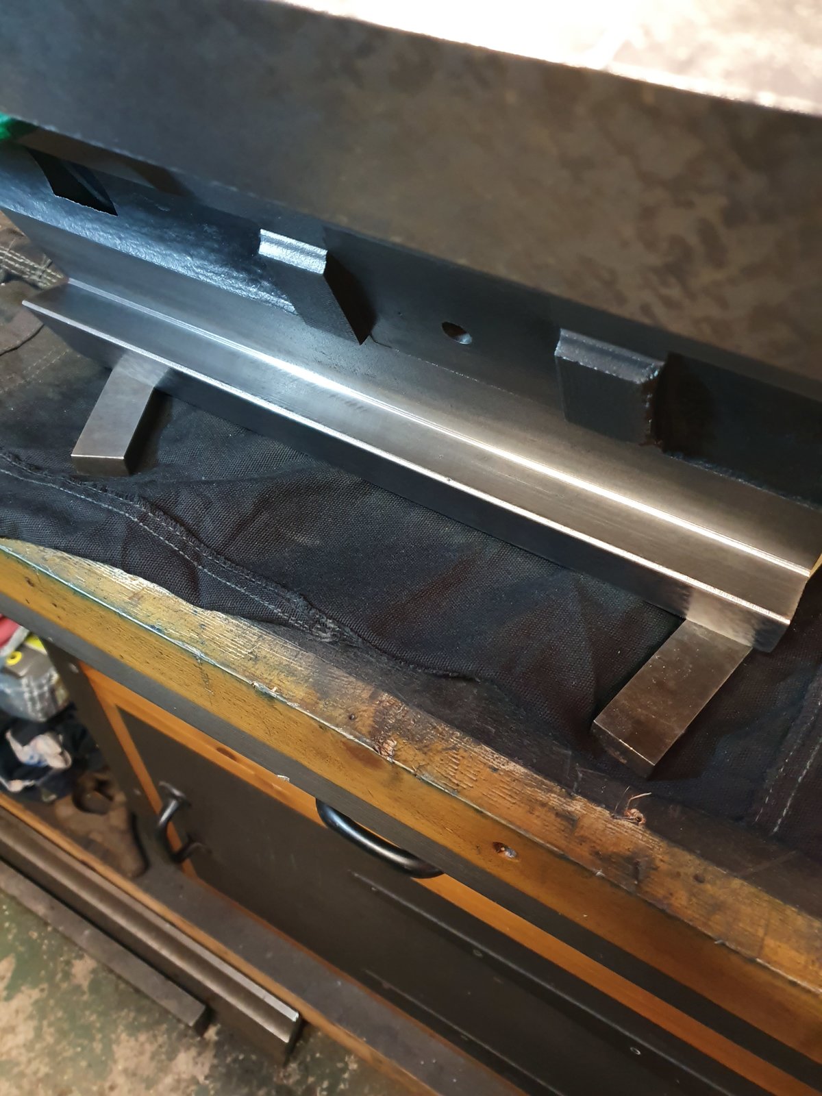

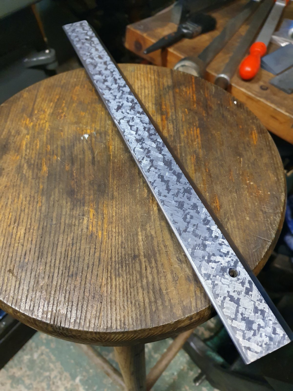

Today I plucked up some enthusiasm to finish the gib strip. Have been feeling a bit crud this last couple of days so I am a little of beat. Not overly happy with the finished piece but its flat.View attachment 203588 View attachment 203589 View attachment 203590
