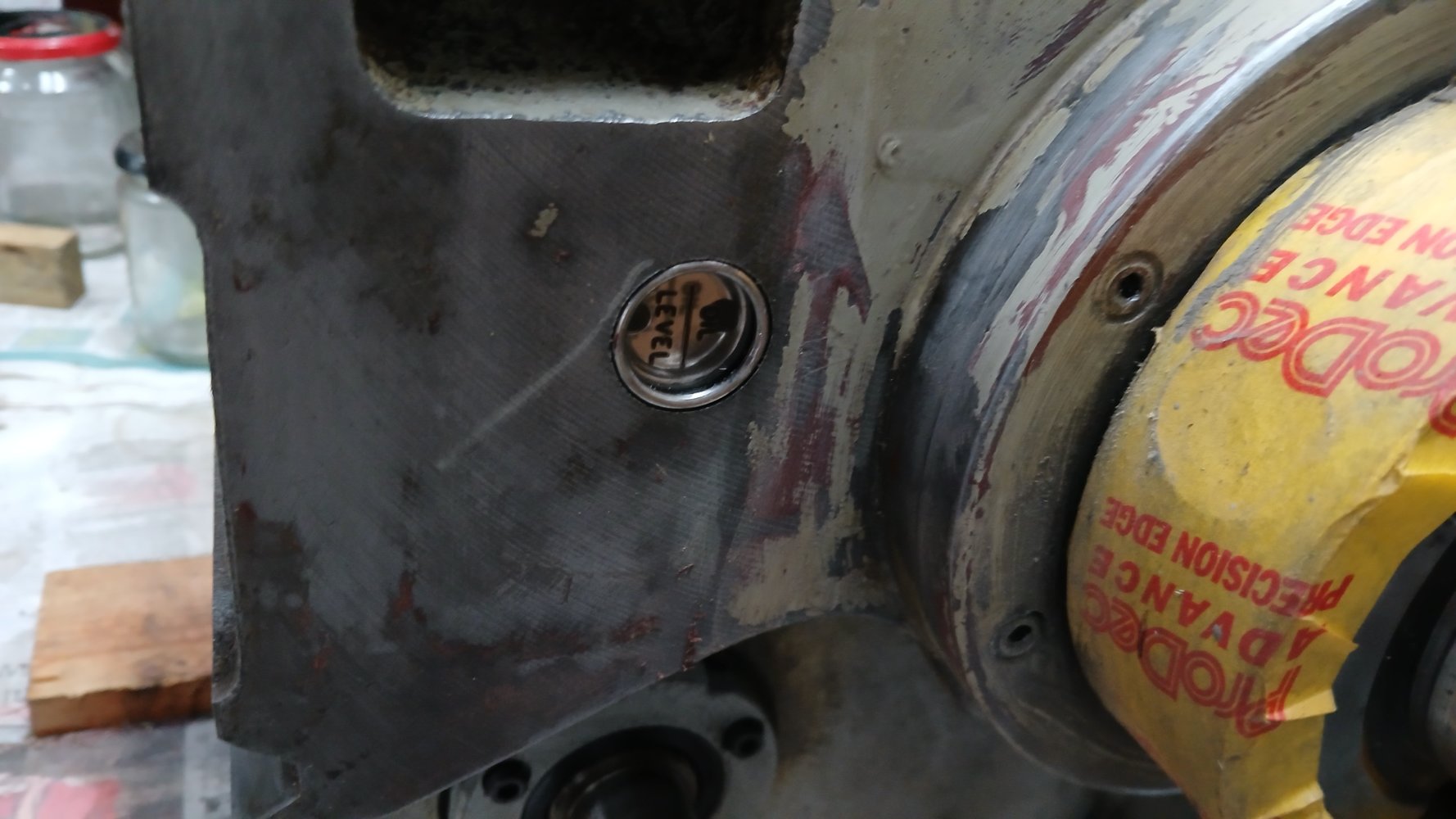

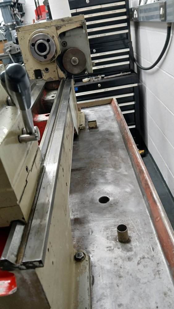

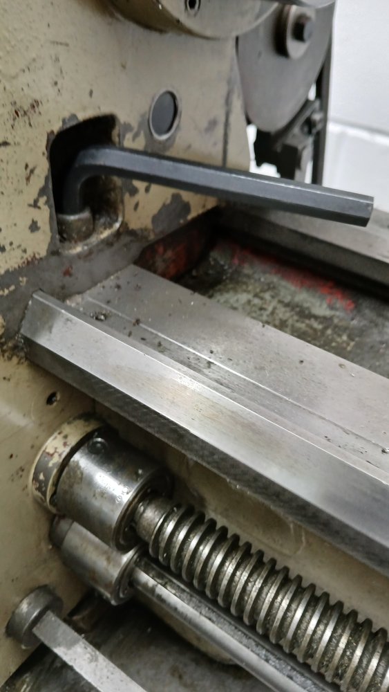

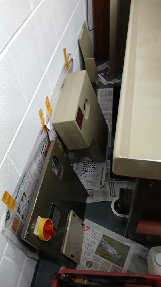

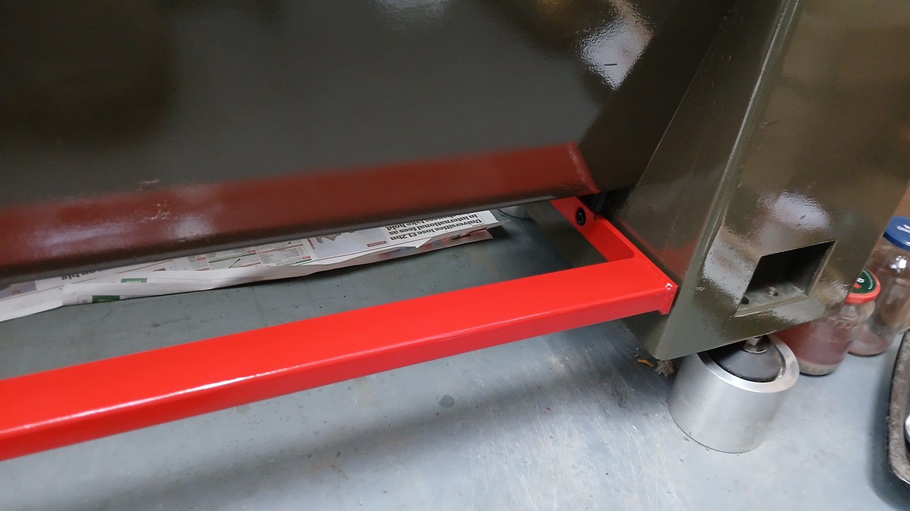

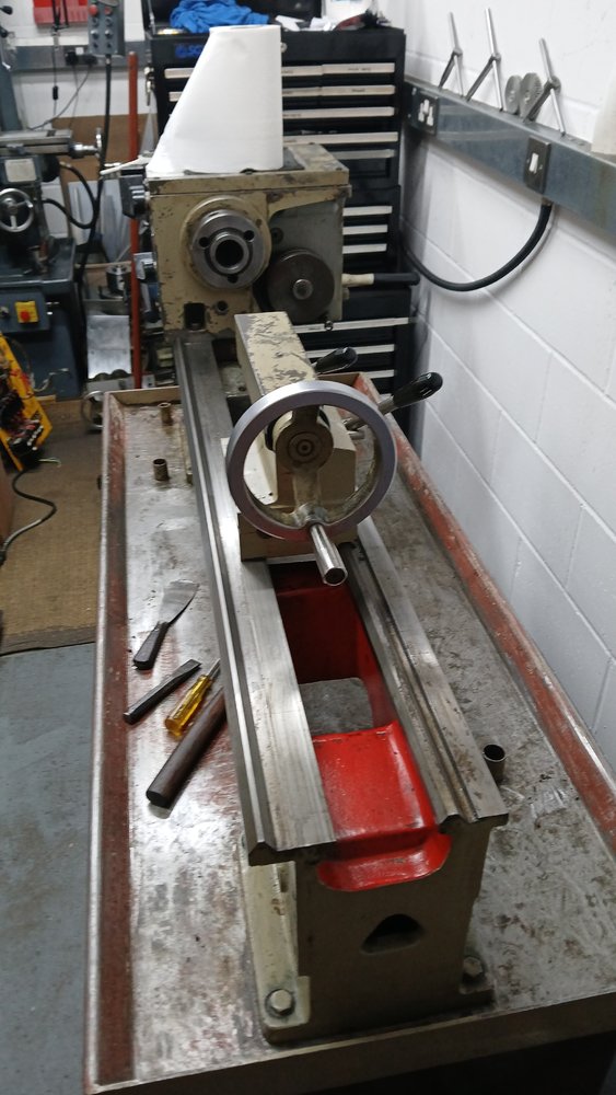

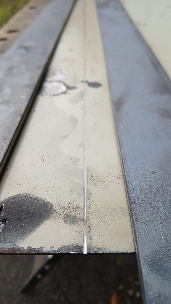

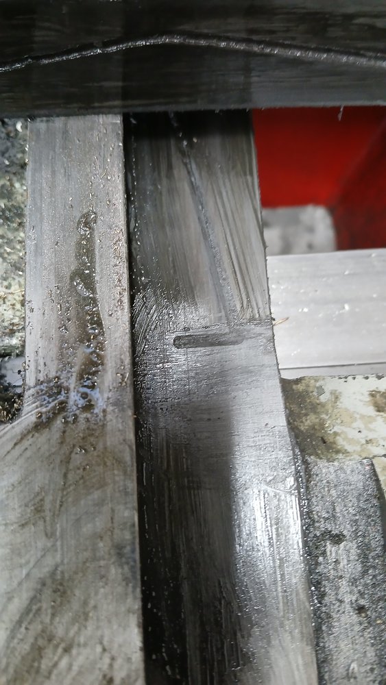

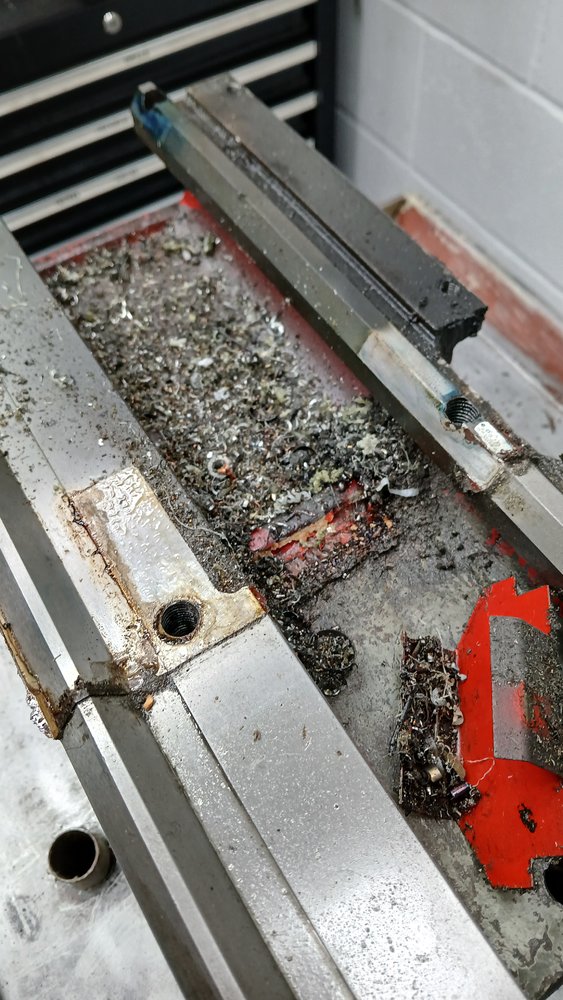

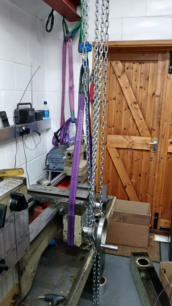

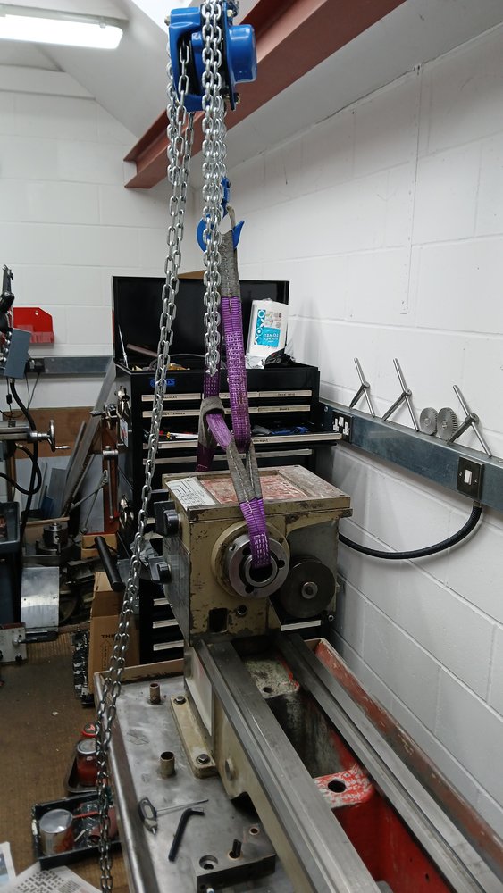

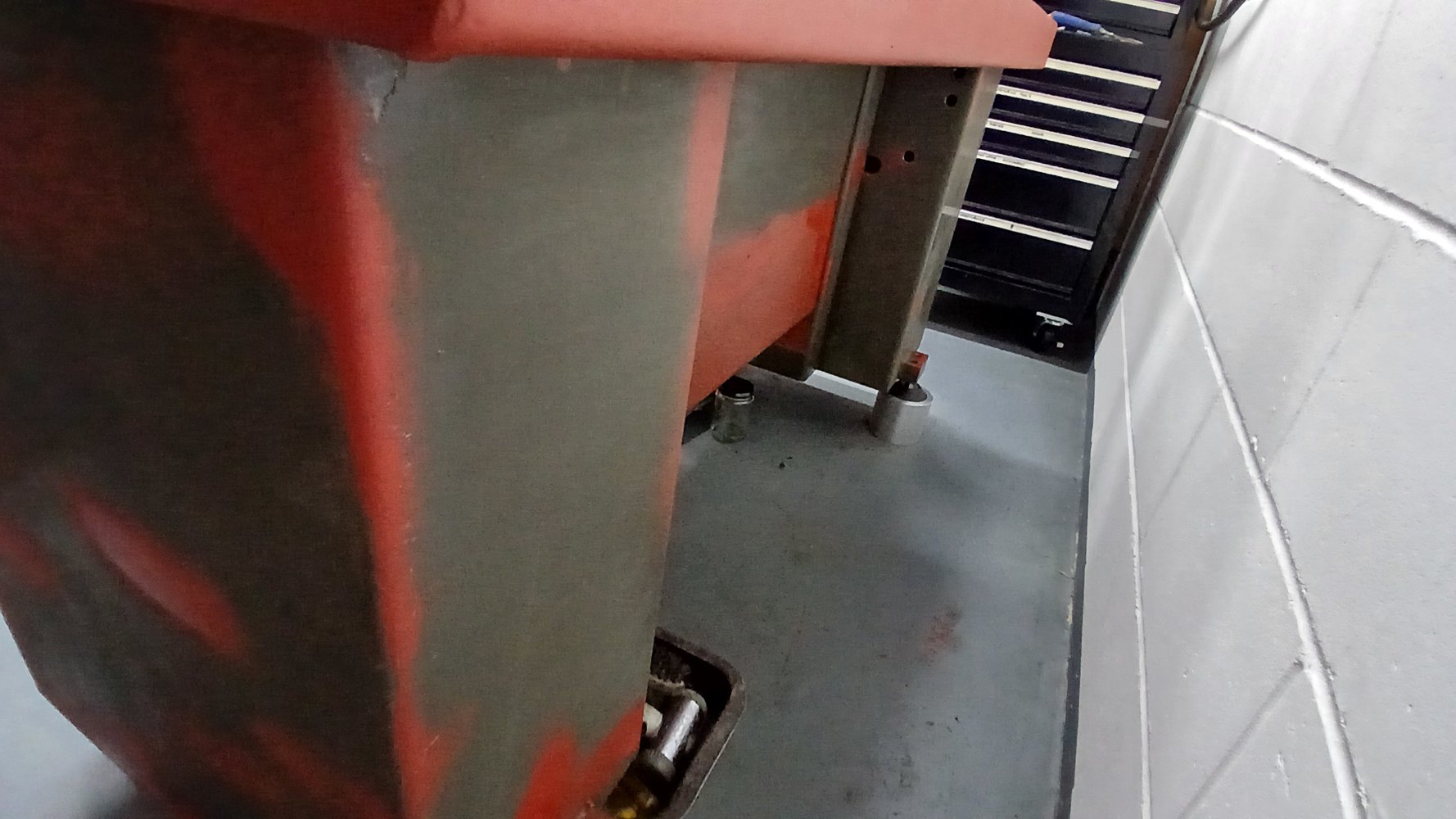

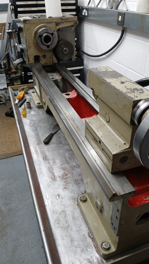

I've spent some more quality time with this lathe now, taking it to bits to clean it and check for anything that's not going to work as it should. So far, so good. The ways are as good as I thought they were:

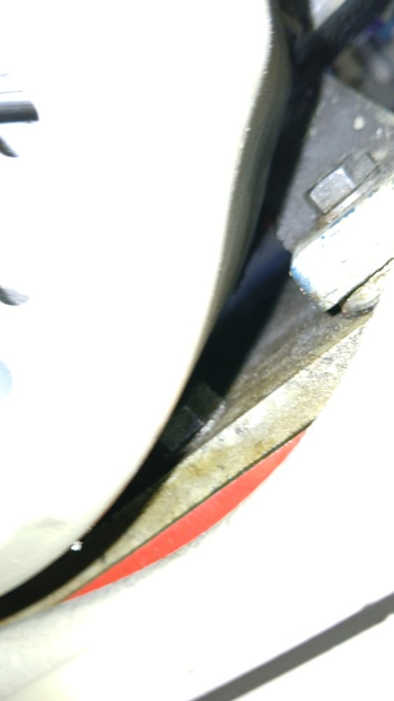

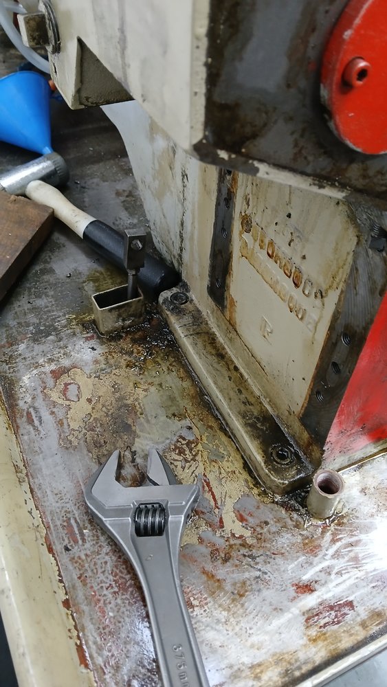

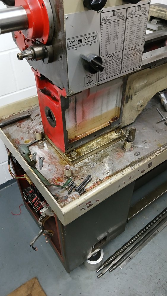

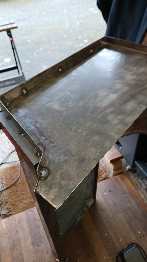

The allen key in the caphead screw is one I've modified to enable me to lift the head off. I'm going to give the lathe a decent paint job. Once it's up and running it'll not get another. Removing the head will make life easier to clean the bed down and eventually refit the motor first. There's s*d all room to get a spanner in to the motor fixing bolts. The bed will stay attached to the base, no reason to remove it. This is a view of the access to the rear securing bolt head (the bottom one!):

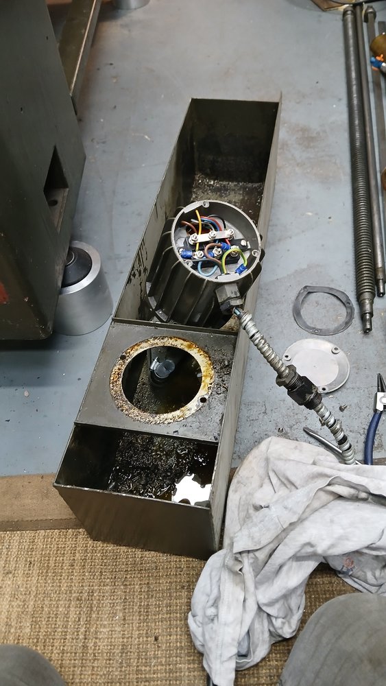

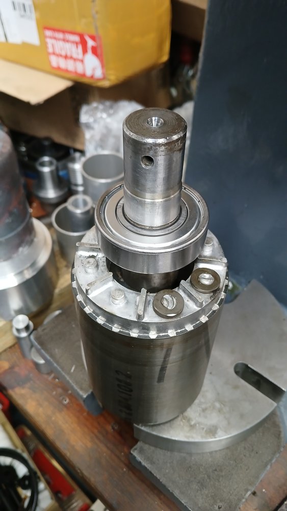

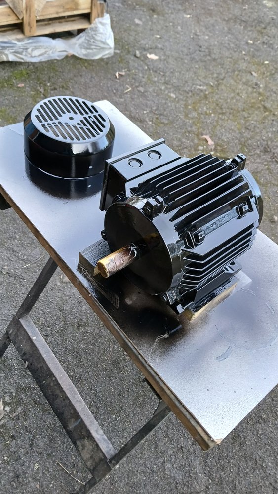

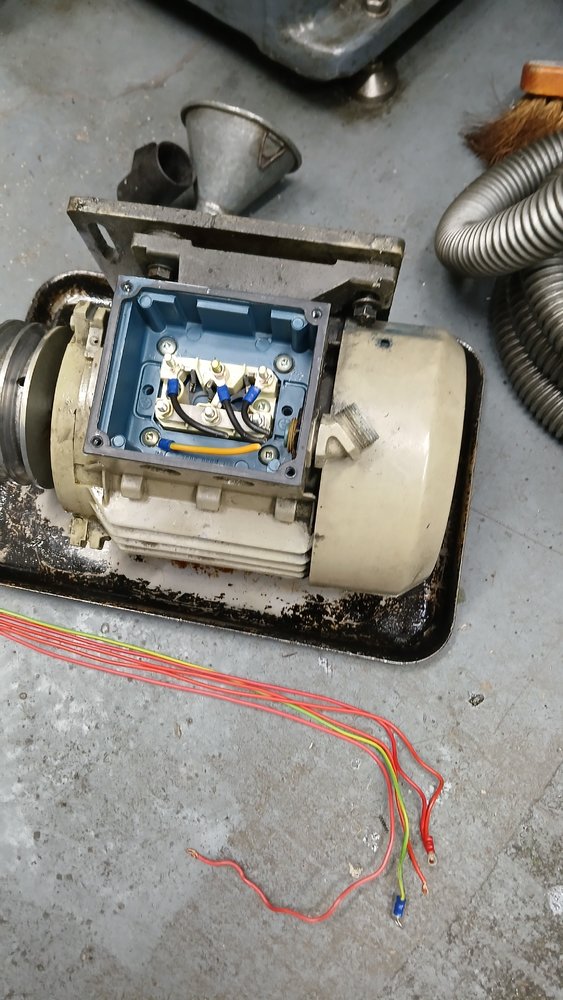

The motor is off:
and the motor has the reconfigurable links to convert it to delta:

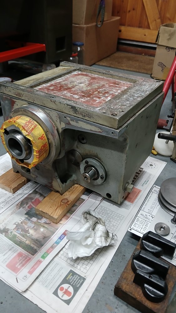

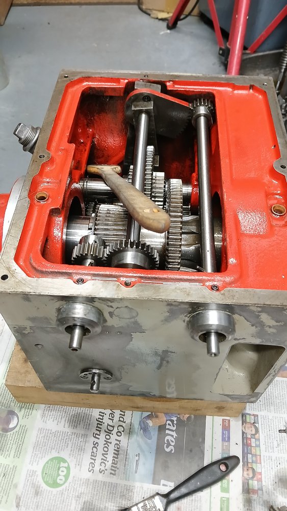

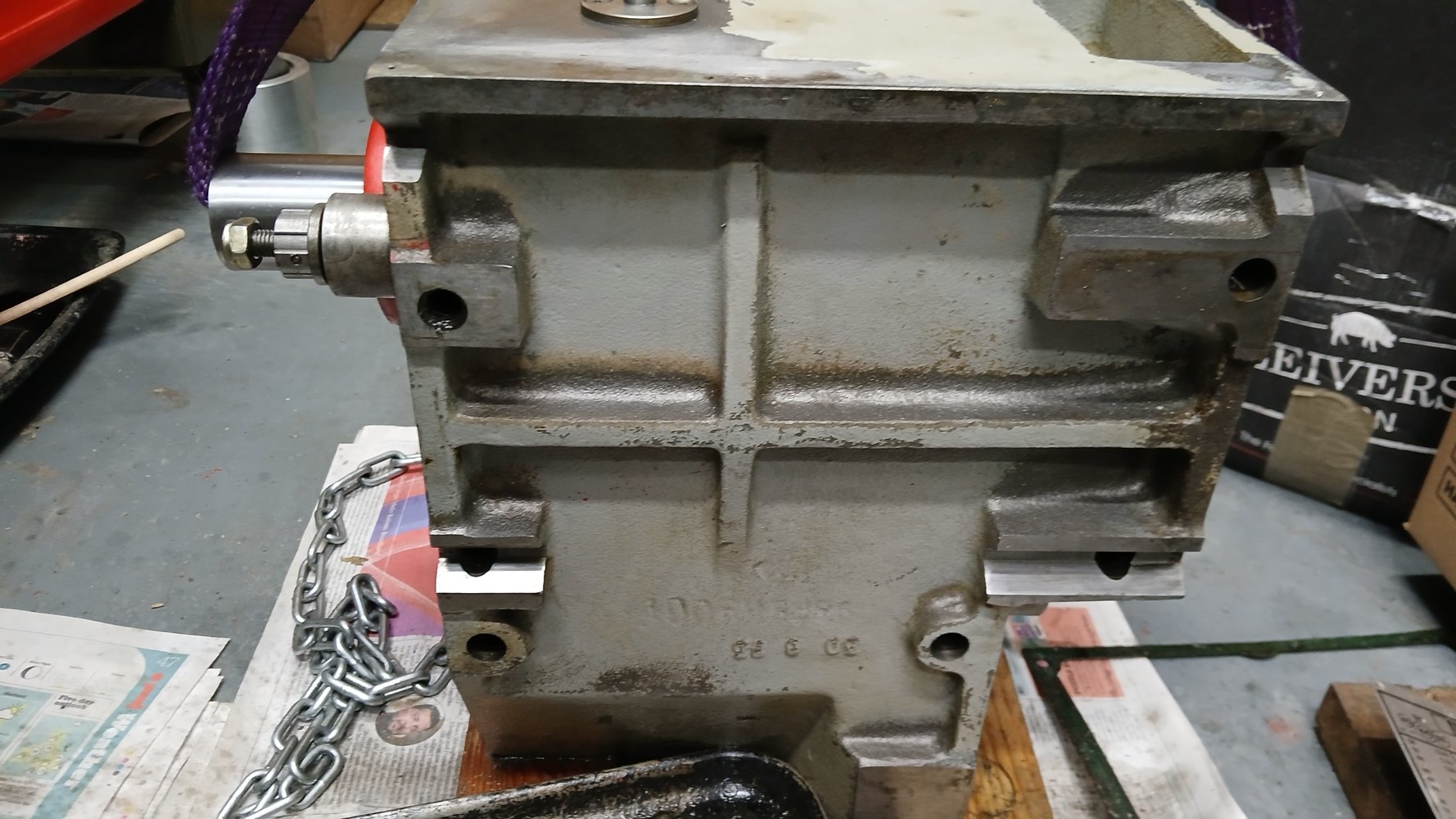

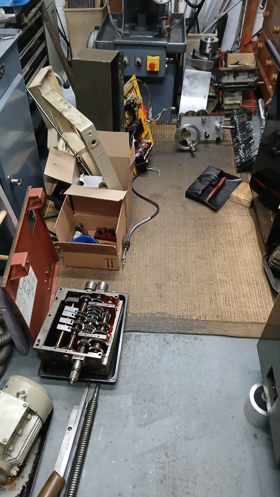

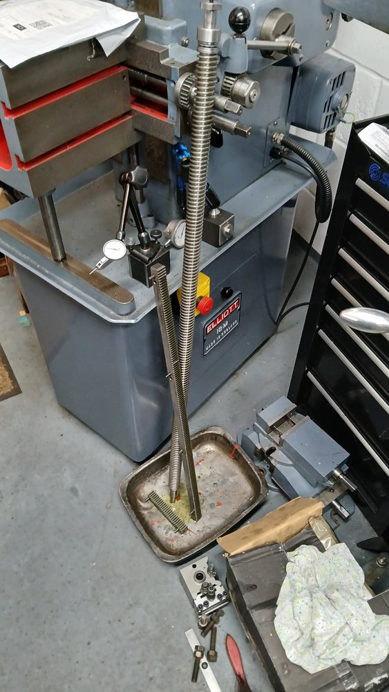

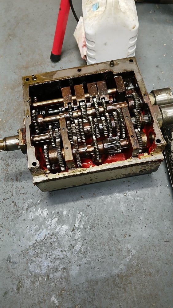

I drained the feed box oil which looked old but ok. No sign of coolant ingress. The feed box was then removed for inspection and cleaning:

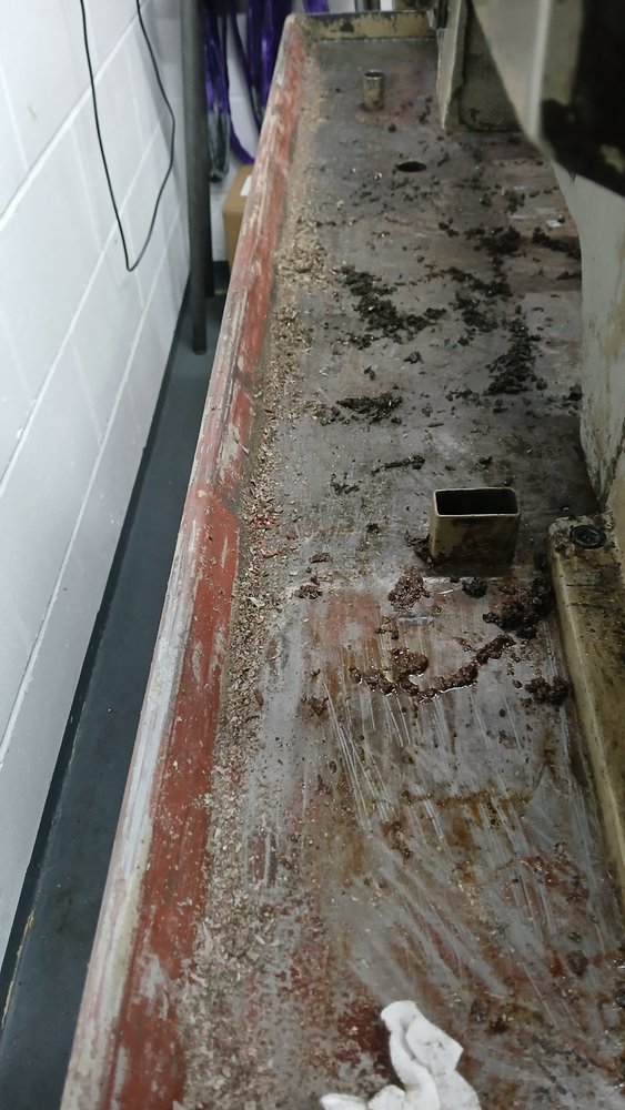

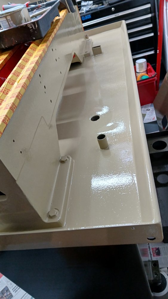

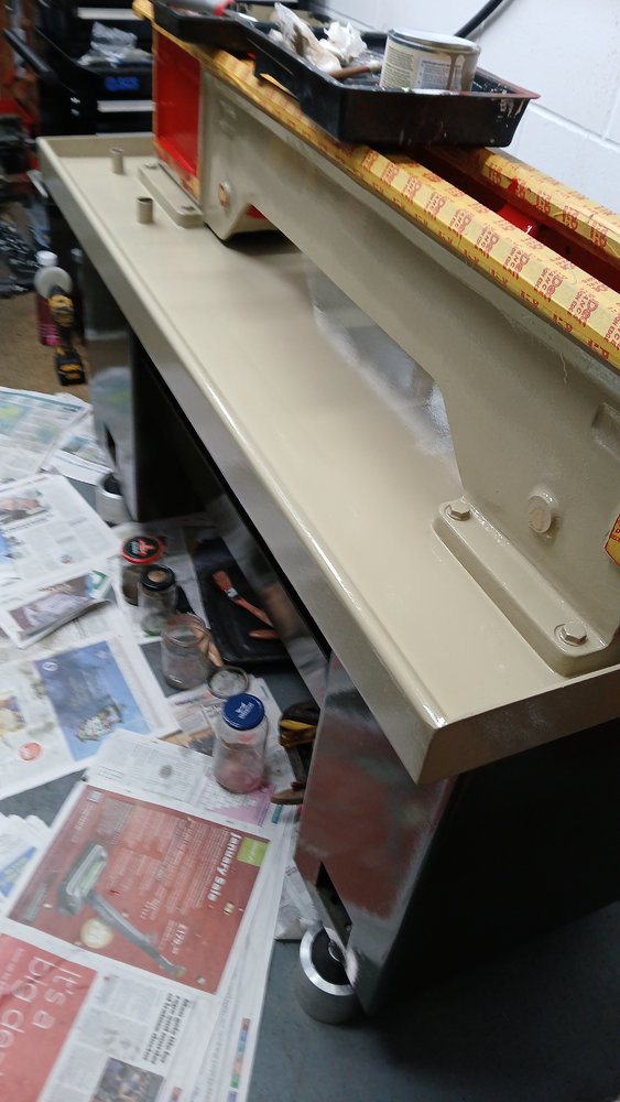

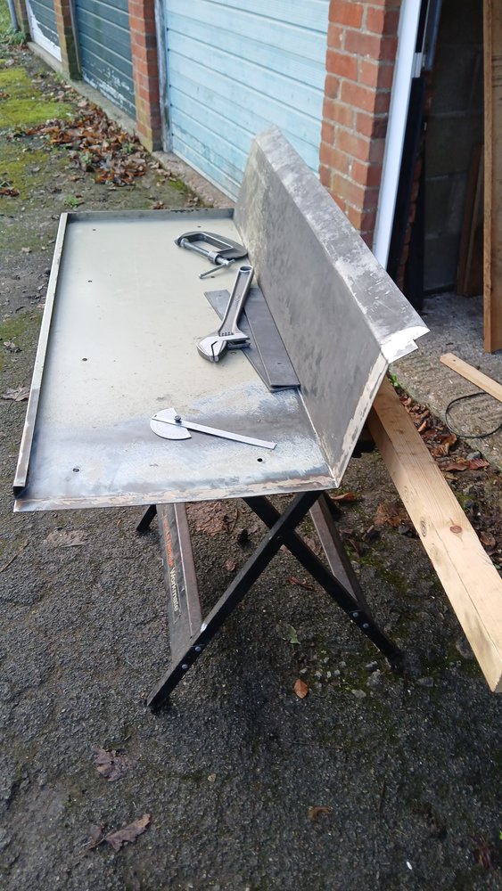

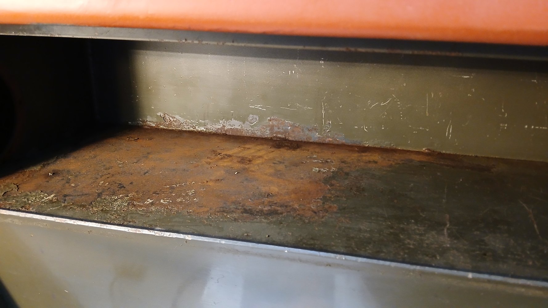

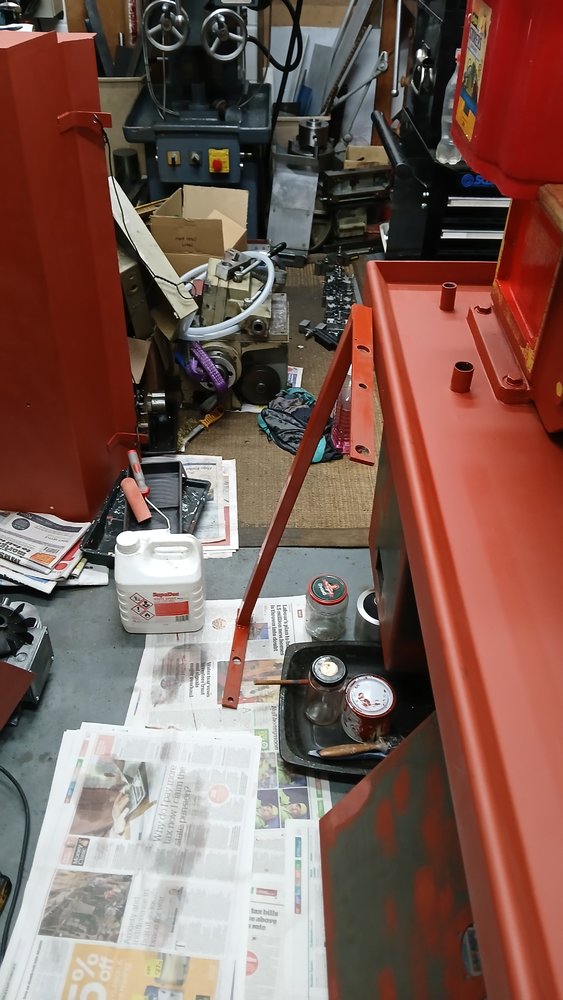

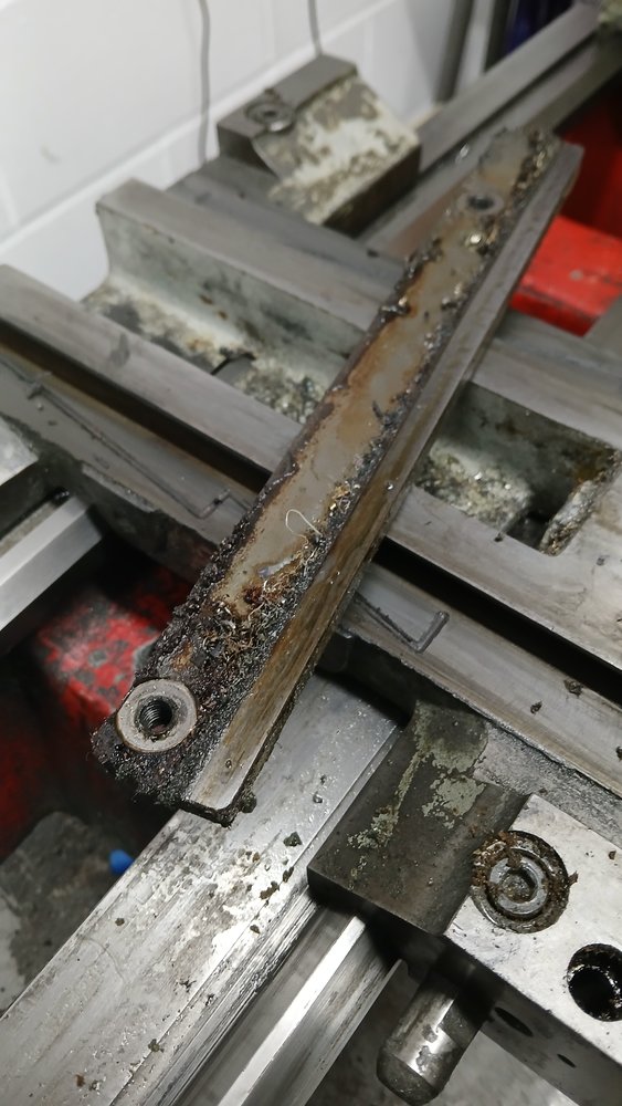

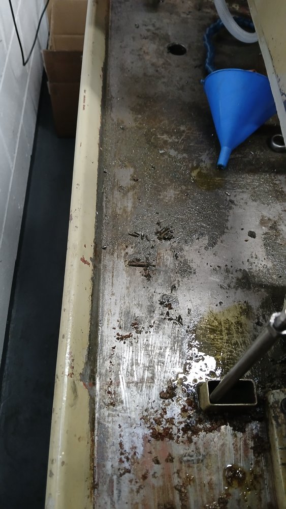

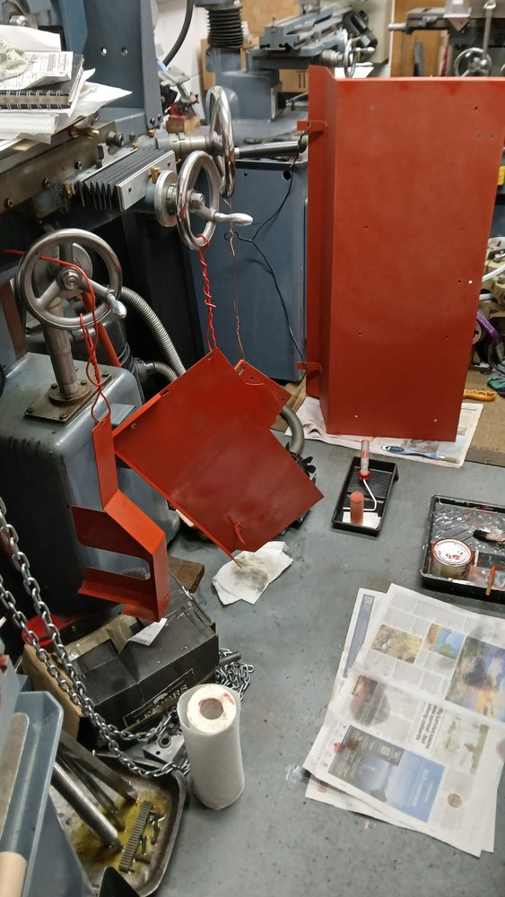

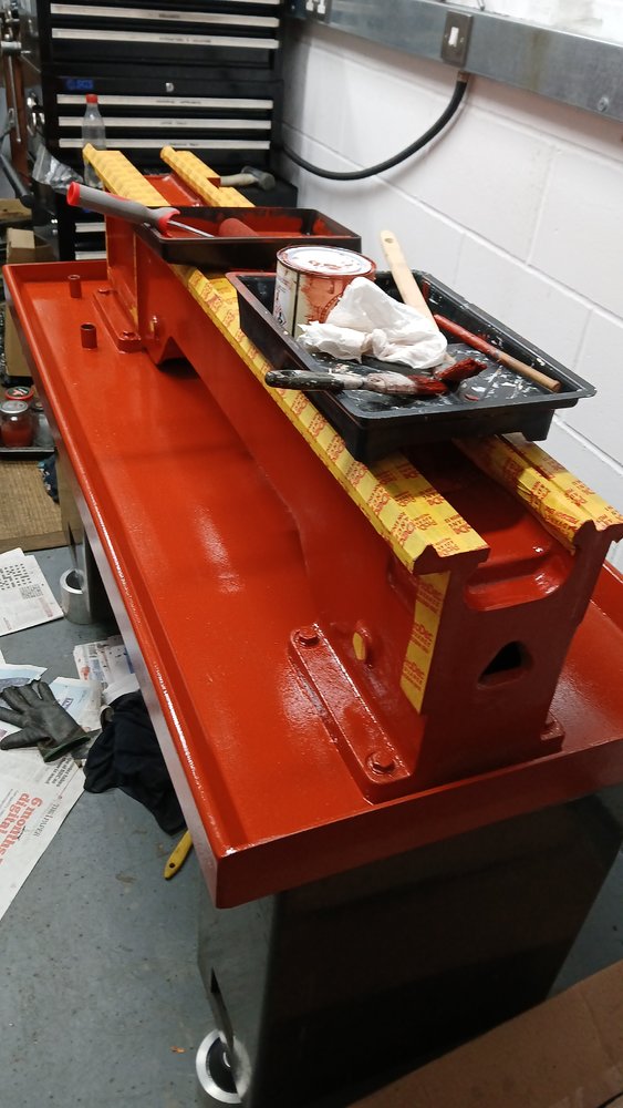

The bed needs a lot of cleaning up to prep it for paint:

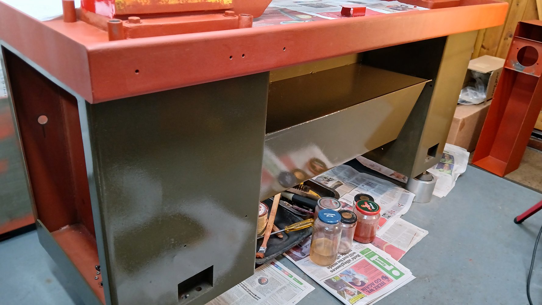

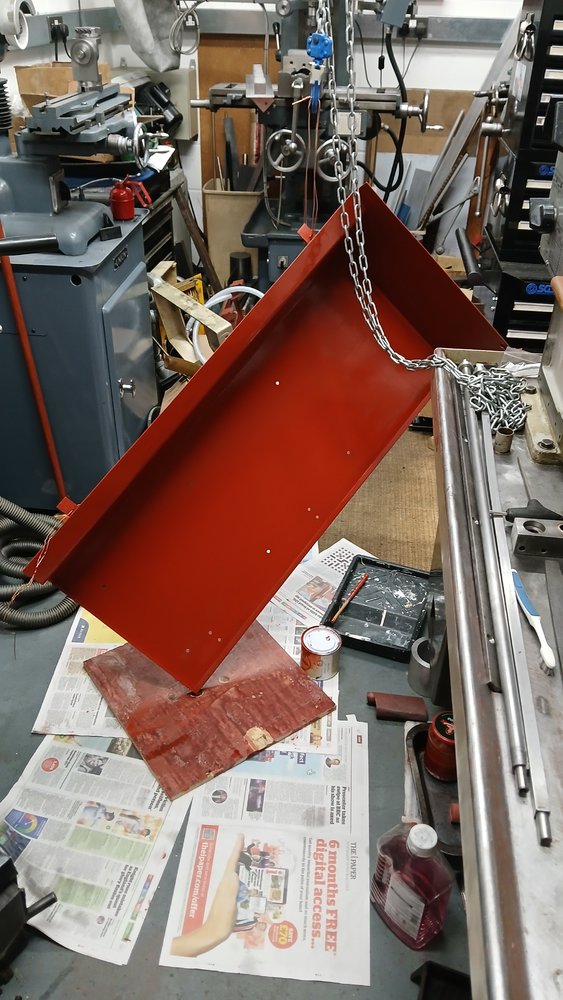

I'm going to paint the base as well, whilst the lathe is in bits.

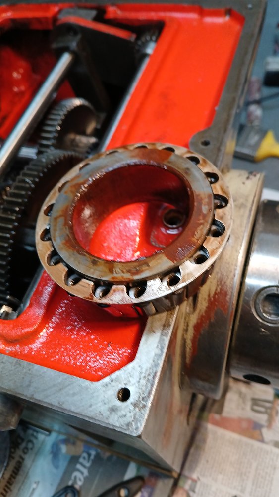

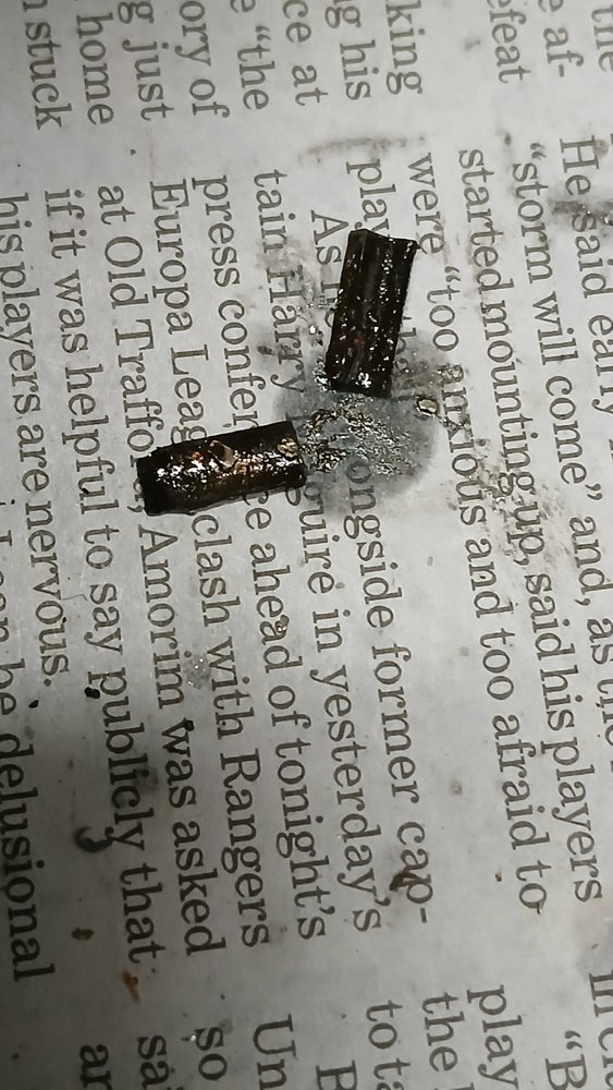

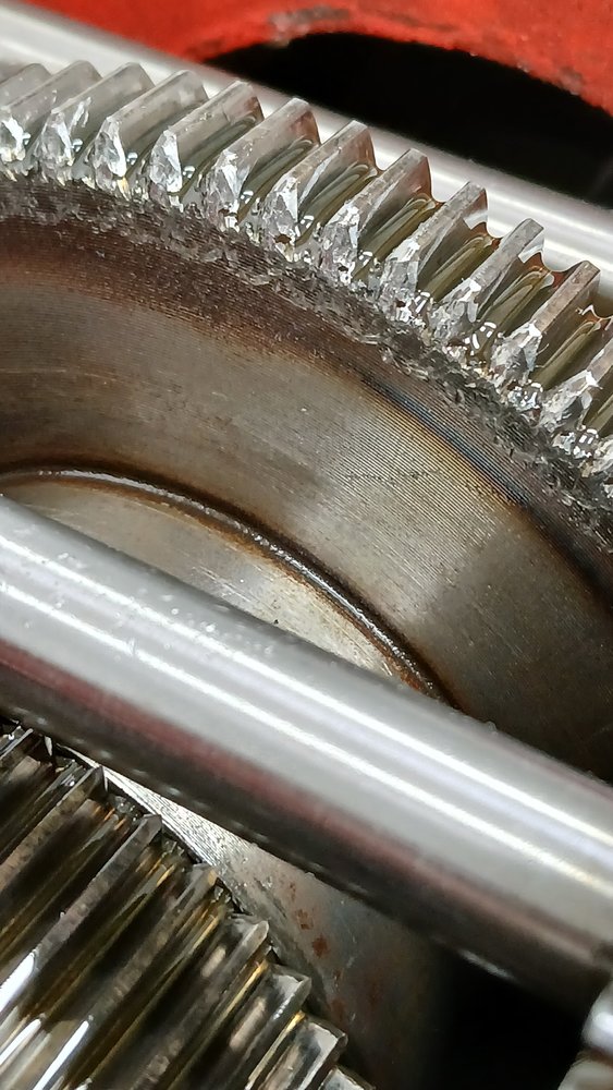

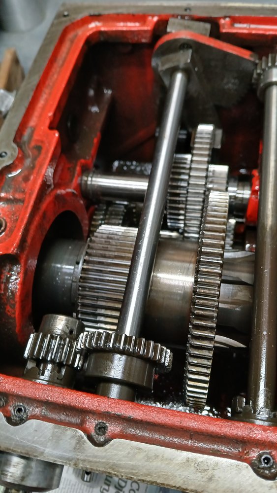

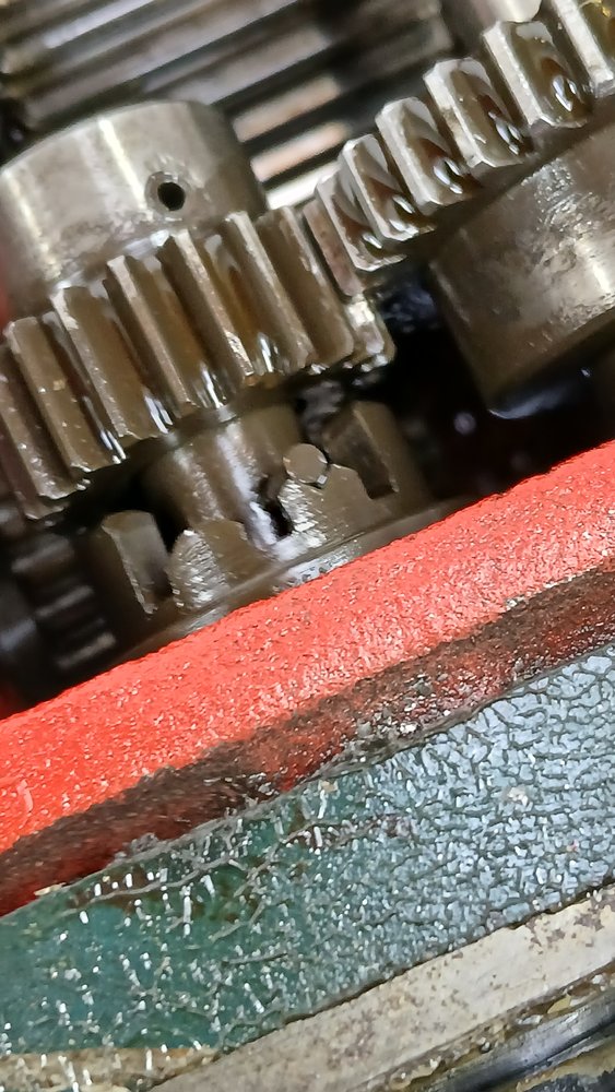

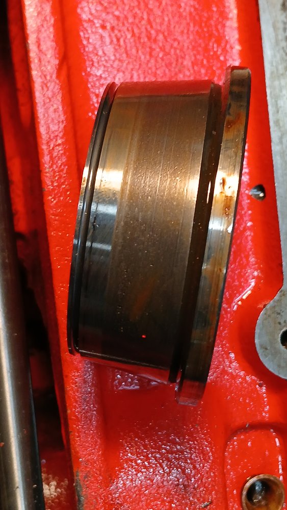

Headstock oil looked similarly old but otherwise ok. The head will get flushed with paraffin, scrubbed out as best I can without pulling the spindle. The worst damage so far I've found is where someone's tried to engage the low speed range with the lathe going:
Other than the leading edge the rest of those gear teeth are fine. I found the missing bits attached to the magnet on the drain plug. Fine metal dust, not chips. Interestingly, unlike the longbed this one is replacing, the high/mid/low speed range selector has a detent for the neutral position:
