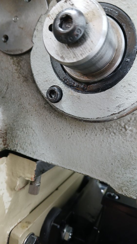

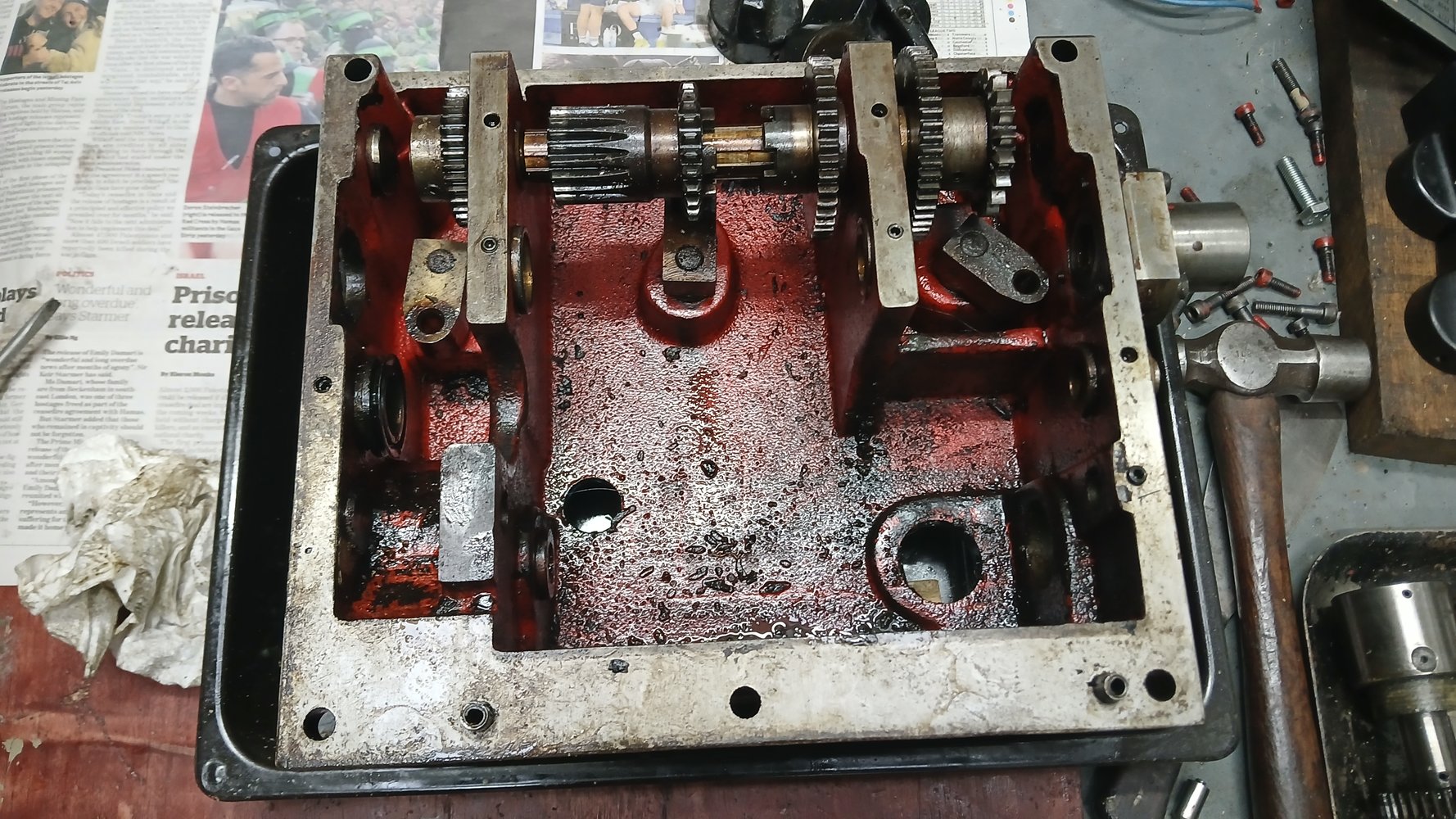

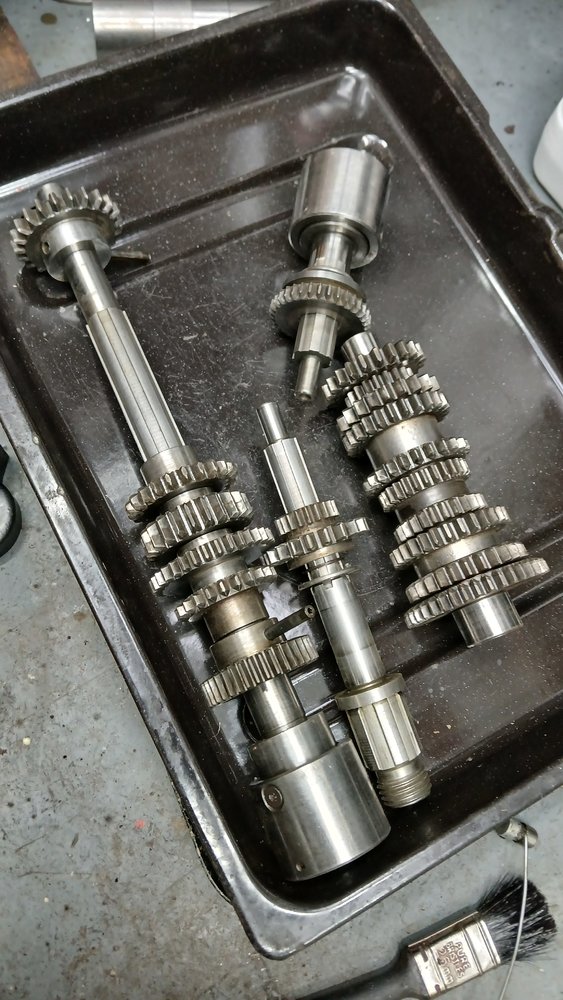

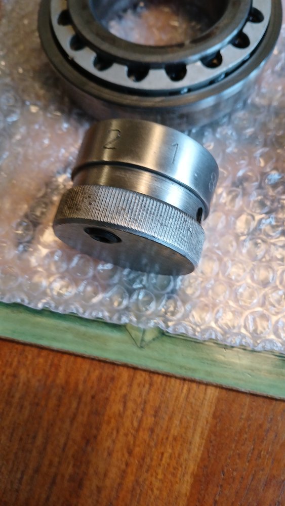

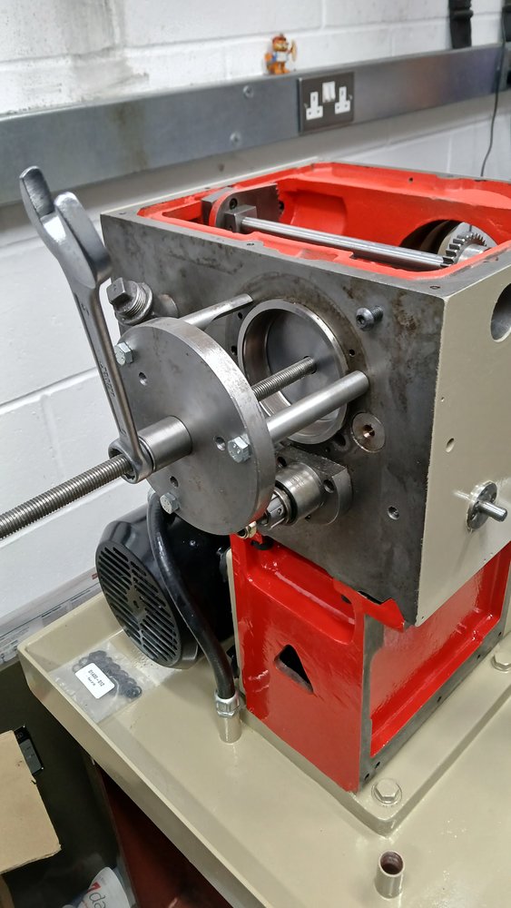

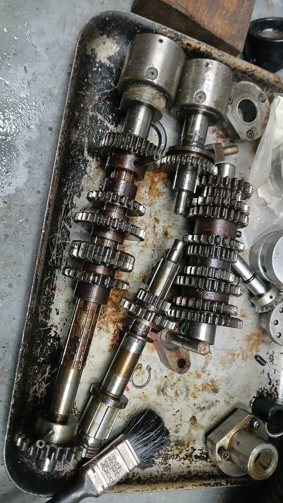

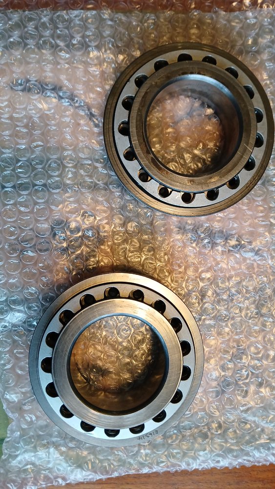

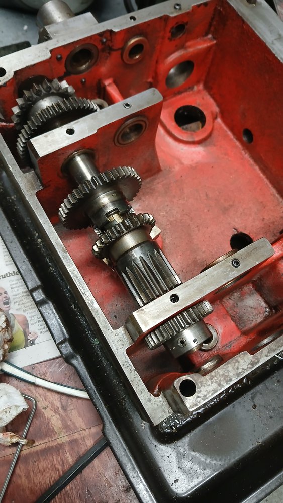

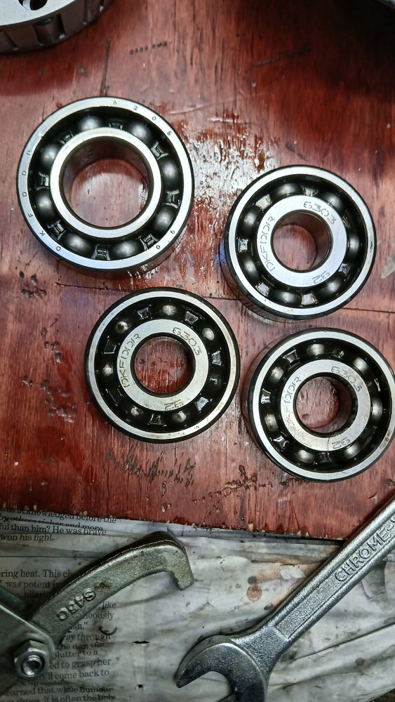

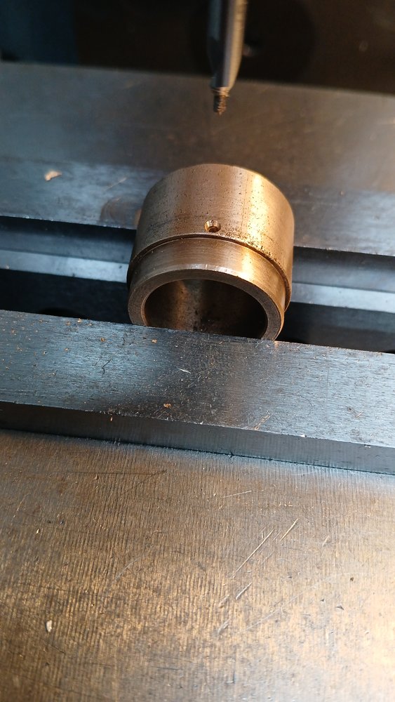

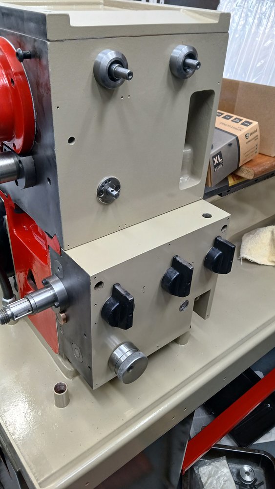

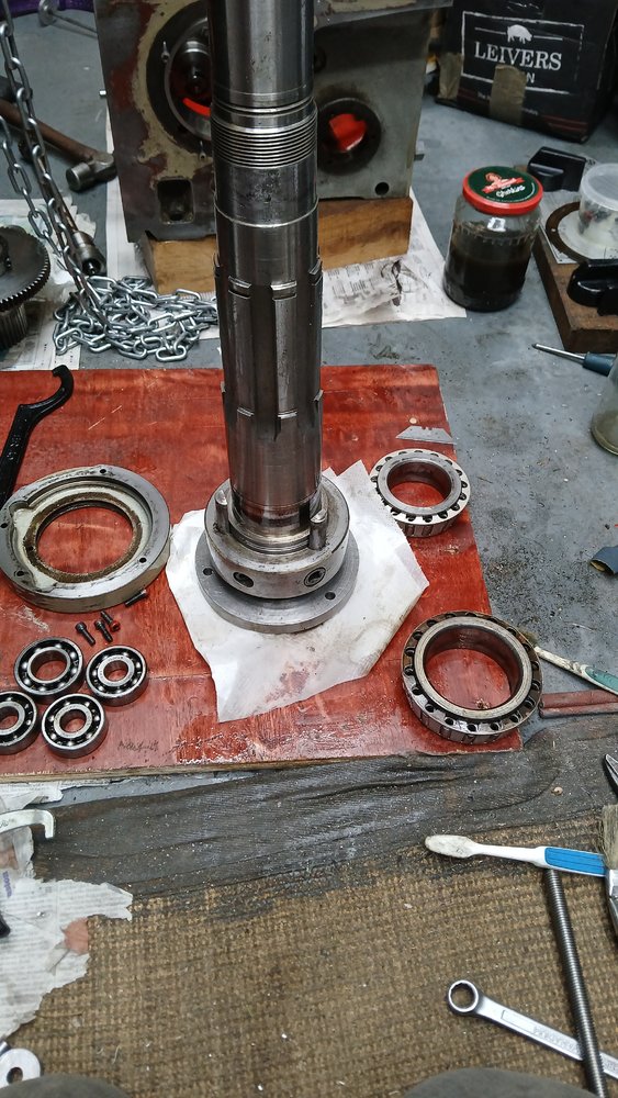

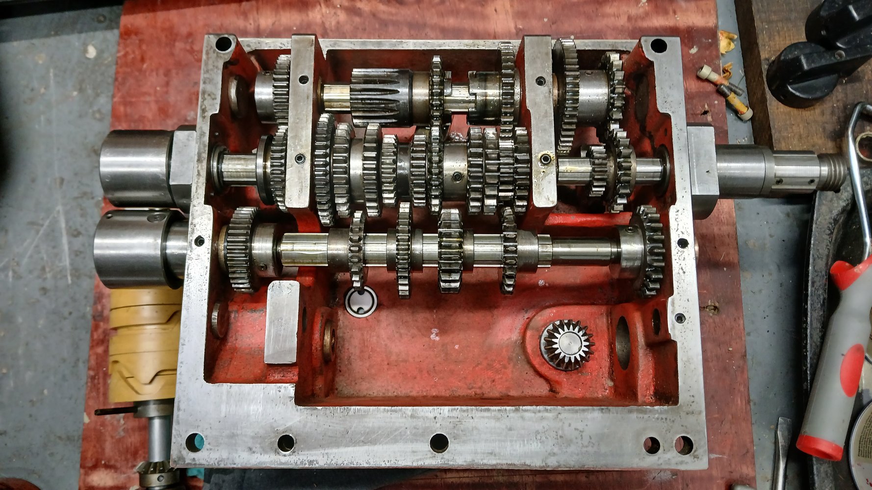

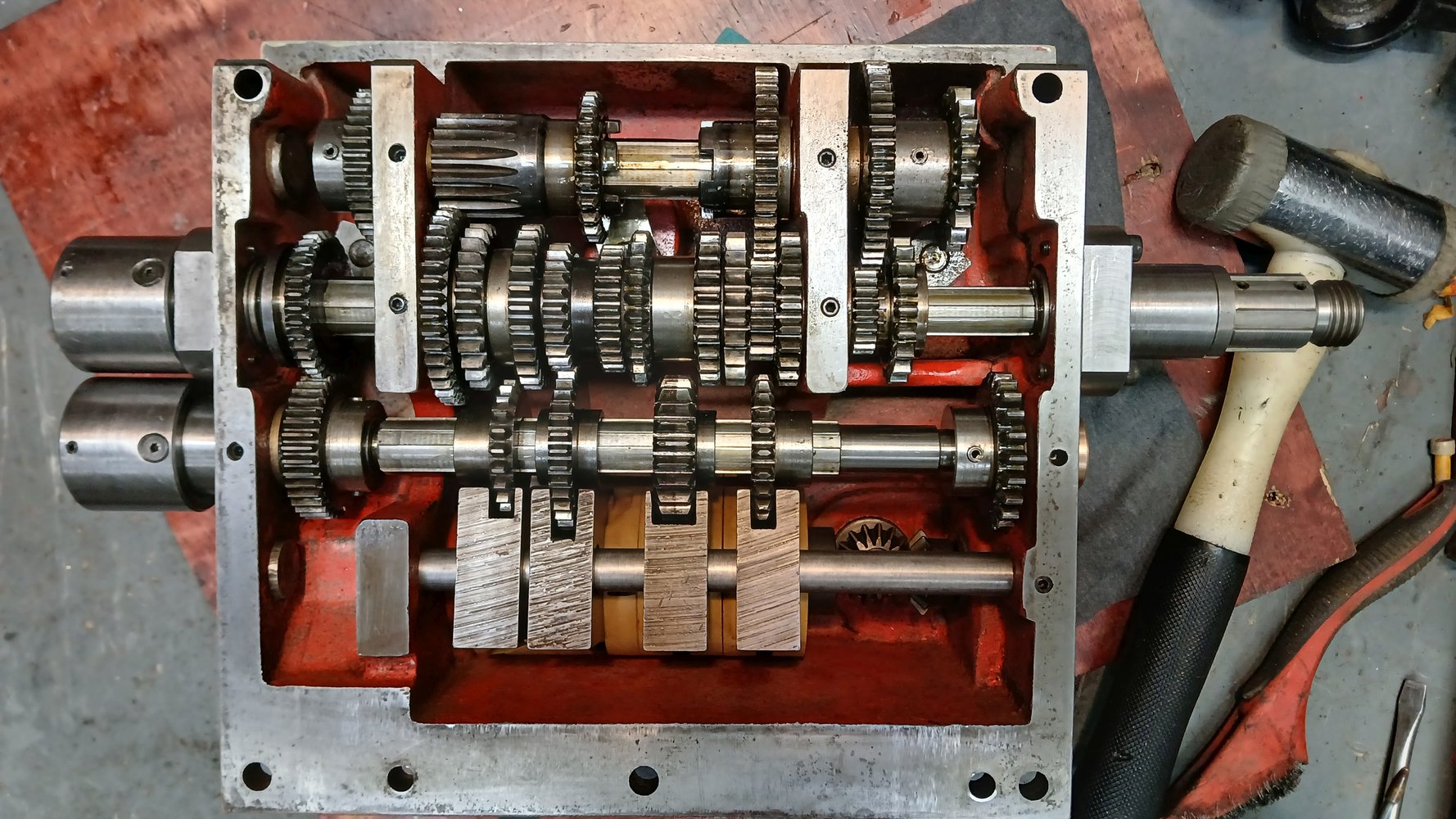

Another day, more progress. There are 2 shafts in the headstock which have ball bearings, both of these are a bit noisy. So while I'm trying to sort out what to do about the rear spindle bearing, I pulled both shafts to check the bearing condition. Result - each shaft has a rough and a not so rough bearing. These are the offending items:

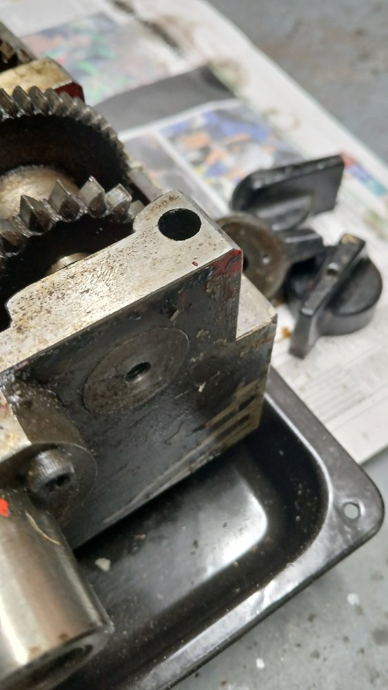

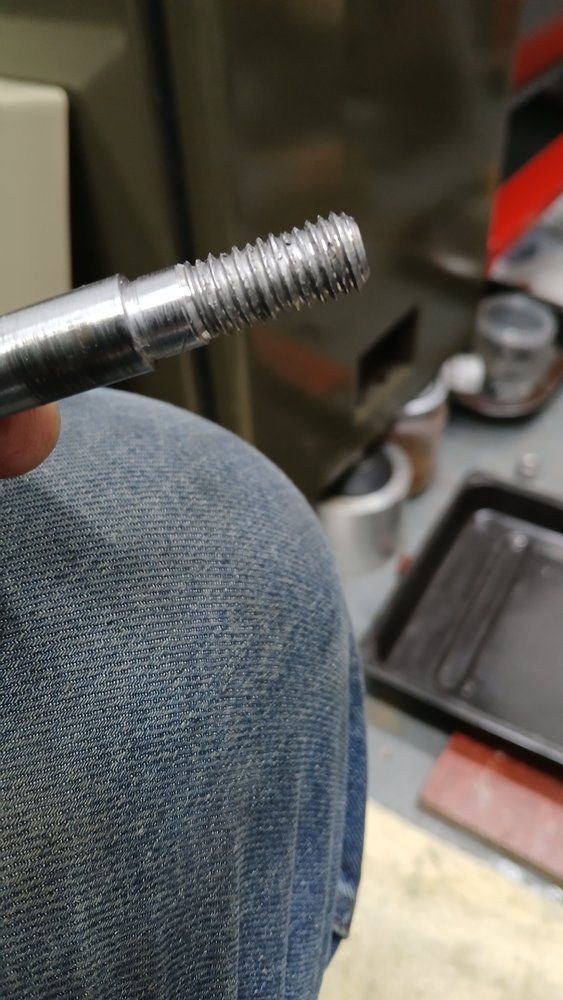

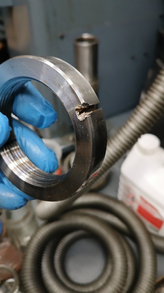

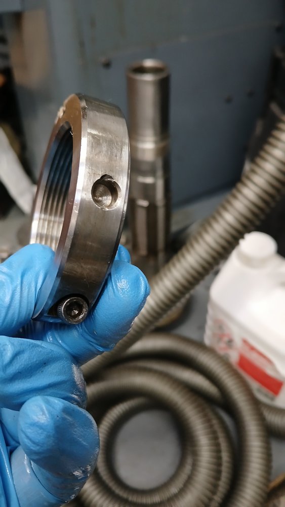

Relatively cheap, so I've gone for SKF. They're only getting done once by me. Looking at the spindle locknut, I'm not the first to get my grubby mitts in there, as witnessed by this damage:

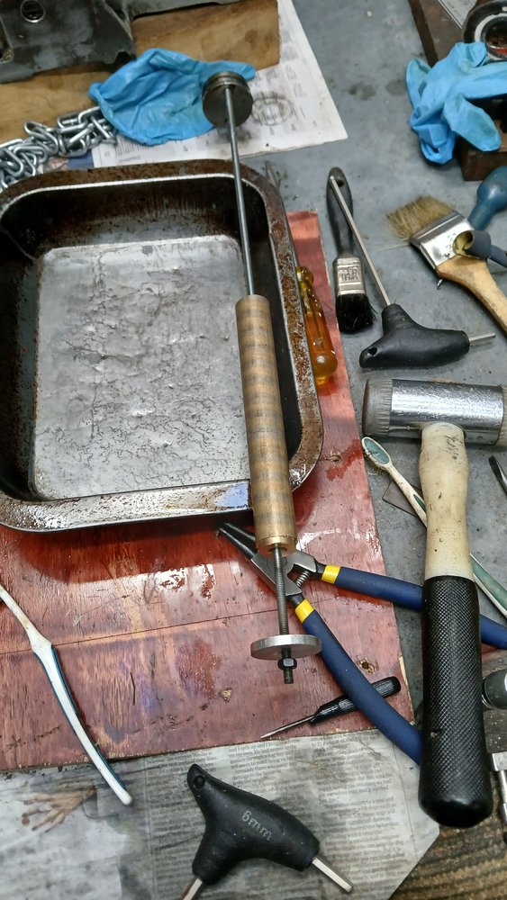

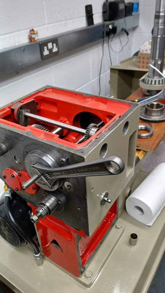

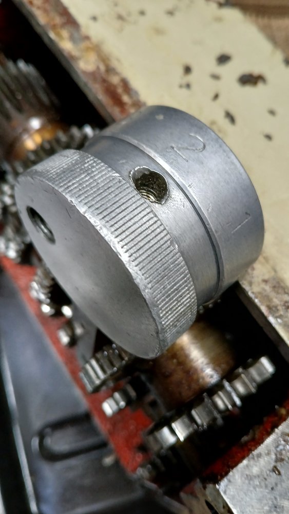

Why ding up the hole beats me. I used a length of 1/4" silver steel as a tommy bar, no damage was done. There are a couple of O-ring retained caps covering the bearings on one shaft. These were removed with an improvised slide hammer:

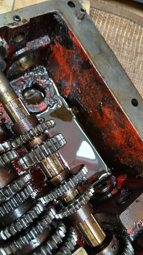

I've also located the missing metal from the rear spindle bearing inner race. There it is:

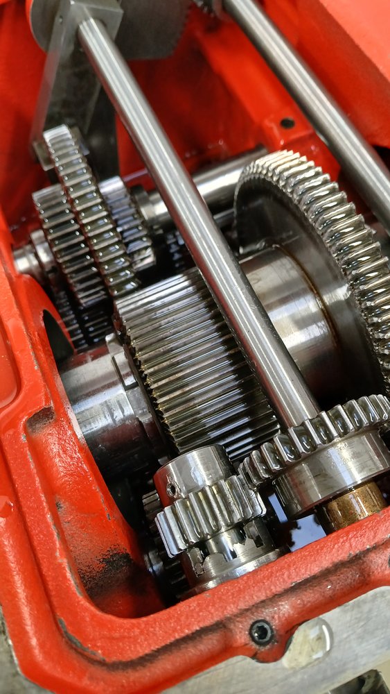

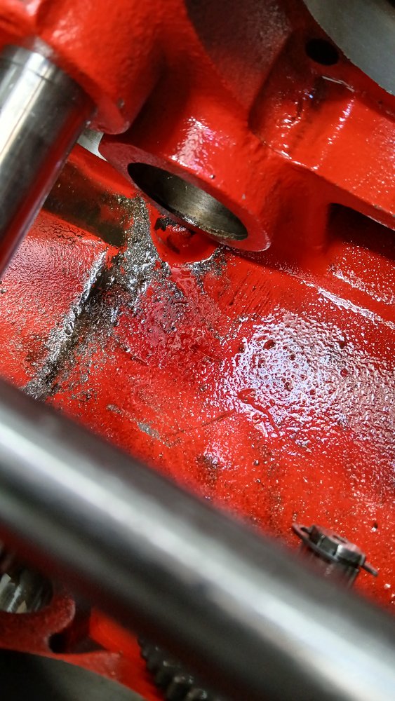

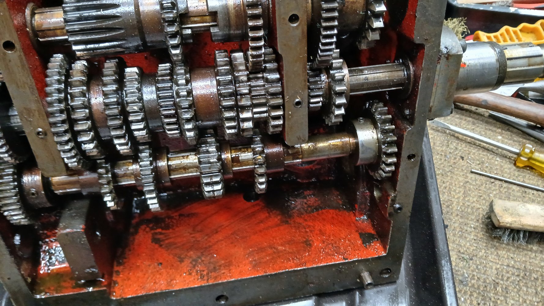

Pulling those two shafts lets me get in there. Thats all being thoroughly cleaned. I think the two other shaft bearings have been mullered by this debris.
So to the thorny question of a replacement rear bearing. I've got two feelers out trying to obtain a used one. The most unpalatable option is new. A cool £980
If all else fails I'm probably going to fit a slightly smaller OD bearing and a bush. The only thing that makes the bearing unique to Gamet is it has a flange. There are plenty of bearings in 55mm ID x 100mm OD of a quality that will suit my purposes, but without the flange they'll get pulled in by the preload. If I have to, I'll make a bush to take a 55 x 90mm tapered roller bearing. Turned in one setup and parted off concentricity won't be an issue. It will also make no modifications to the lathe spindle or headstock so it could be put back if I have to.
The hardest part is waiting...
