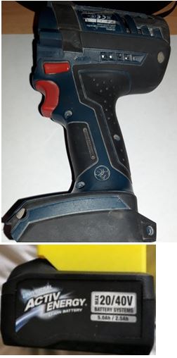

I had mislaid the adapter. Lol.@ukracer can you tell me the dimensions as near as, from the end of the Ferrex battery to the adapter at both ends please!
Front is 30mm and the rear is 6.25.

No not yet. Best give it a go..Sweet. Nearly there on something else for you to waste time and materials on to find it doesn't quite fit!
Seriously though it's looking alright. Have you actually tried fly leads from the Ferrex battery to the Bosch drill? Don't want to print to find we should have allowed for a 3rd contact etc.

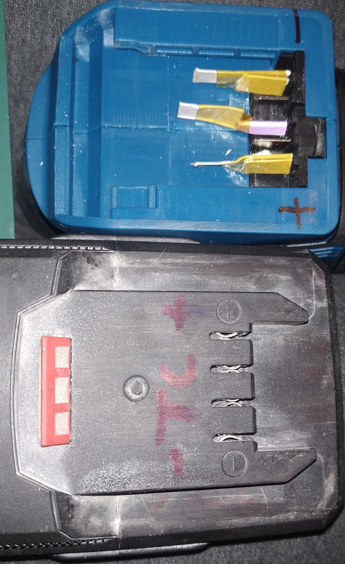

No mate. I have never been into asthetics. Lol@ukracer, The Ferrex battery to Bosh tool:
Excuse my dog rough attempts, I can't use Photoshop etc to save my life:
Keeping the + & - of Ferrex battery and Bosch tool on the same side it'll end up something like this, so the battery will insert the "wrong" way around to how it did originally. The thing is this makes for easier copper strips:
What'll probably look better is the battery going in the original way but this complicates things as I have to swap the + & - from side to side:
Can you see the first option being an issue?

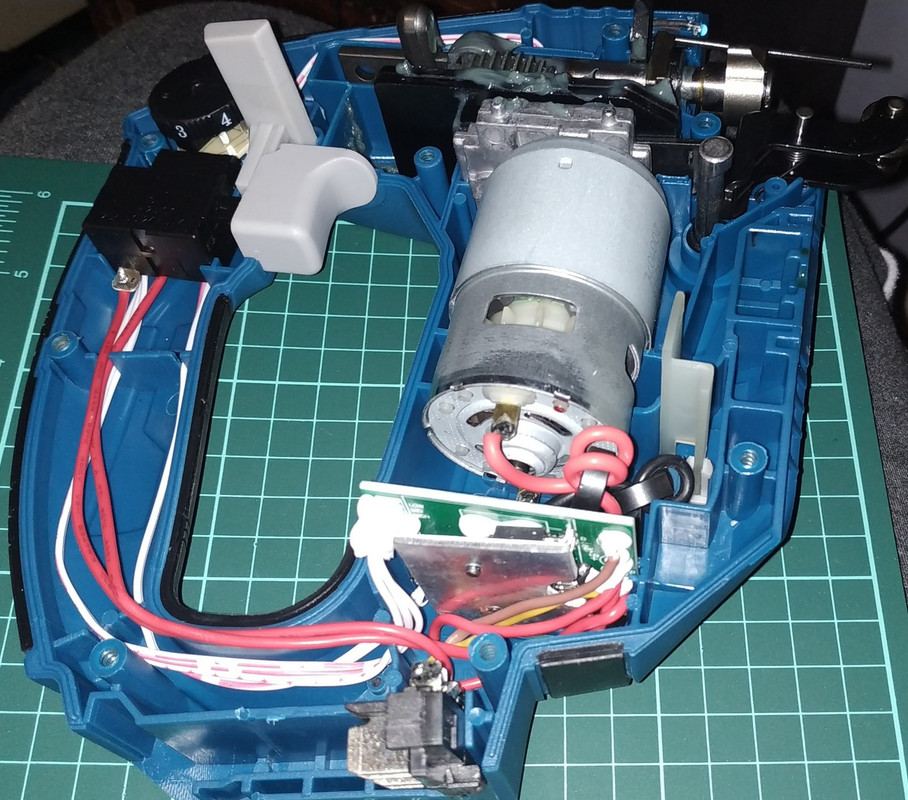

Tried my new jigsaw with a 5s lipo, led lights up for a second but nothing happens.
Sounds like I need the middle pin connected.
Would be great if somone could measure a battery pack to see if its a flat 5v signal, or resistance to the power pins? Likely a PTC that goes high resistance when it overheats.
If not, I know its a brushed motor, I can open it up, scrap the electrics and put a 24v mosfet switch in there. Would like to be using it this week
Opened it up,
Two mosfets on the board, couldnt see much of the traces but I think one is battery protection and the other is motor speed.
12.67 between center and B1-Please could you measure the resistance betweeen the centre pin and the power pins using meter on 20k ohm range. Im expecting a reading like 10k ohms from centre to one of the negative pins, which is how the parkside work with a NTC sensor on one of the cells.
I think if you had another brand of battery or just a plain lipo pack, you'd want a 10-15k resistor between the negative and centre pin. Use a NTC thermistor mounted on the cells insteas, if you want overheat protection.
