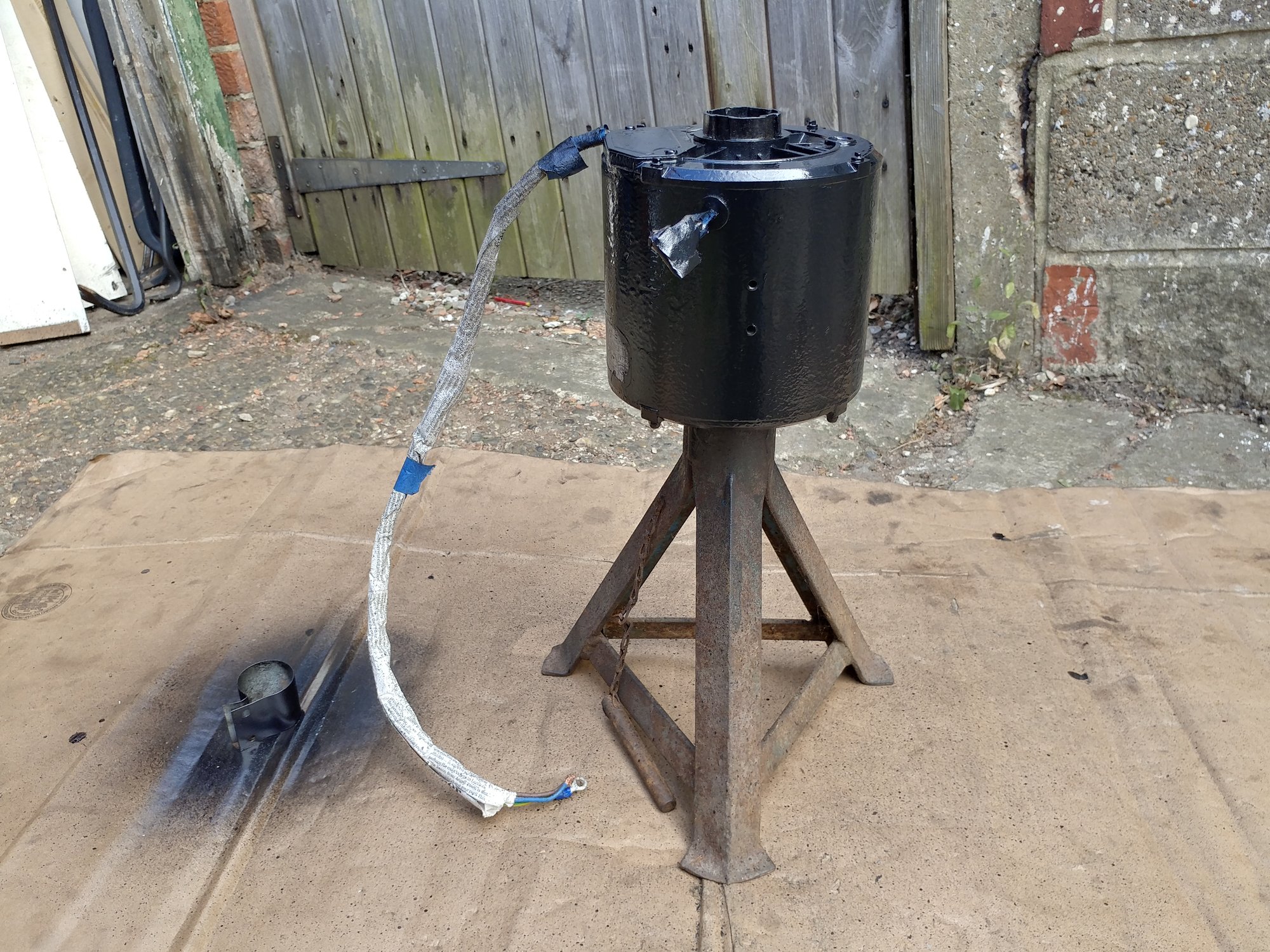

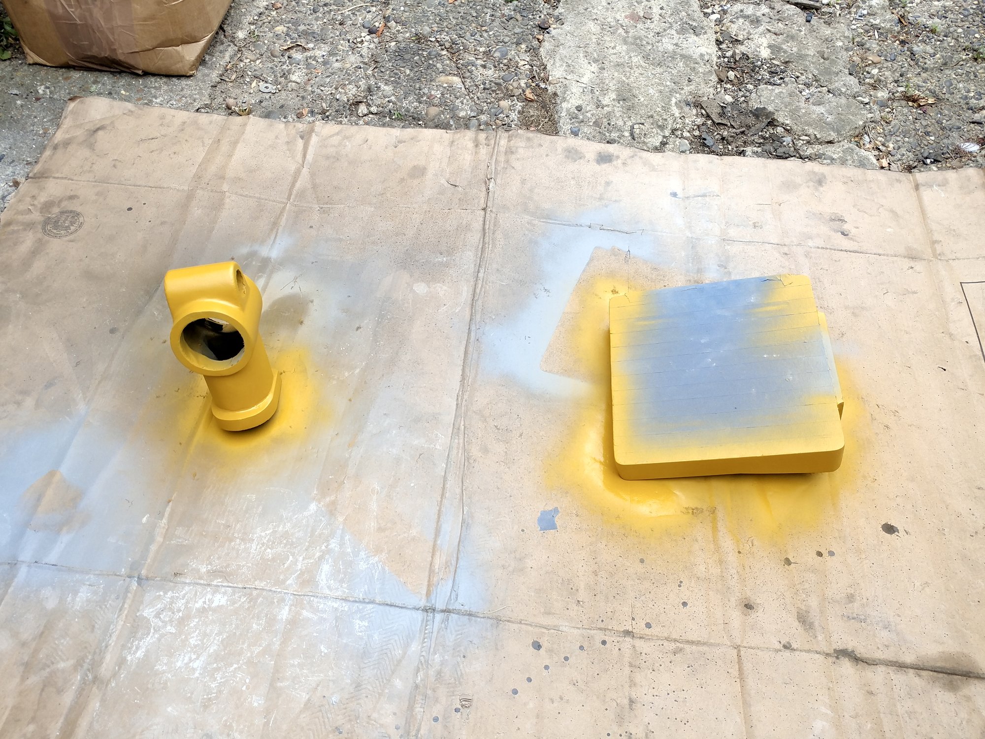

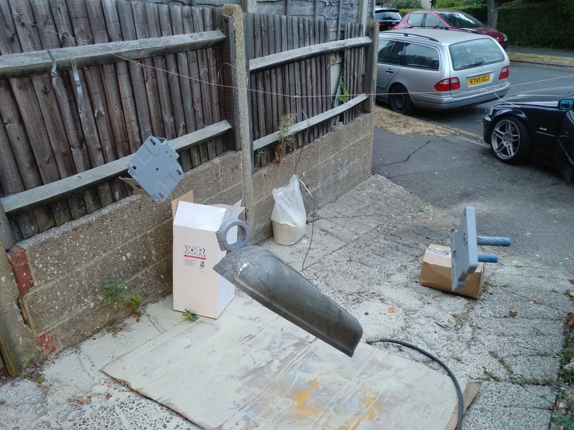

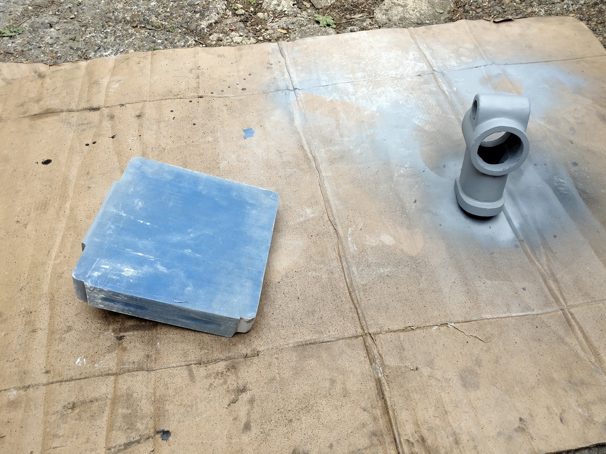

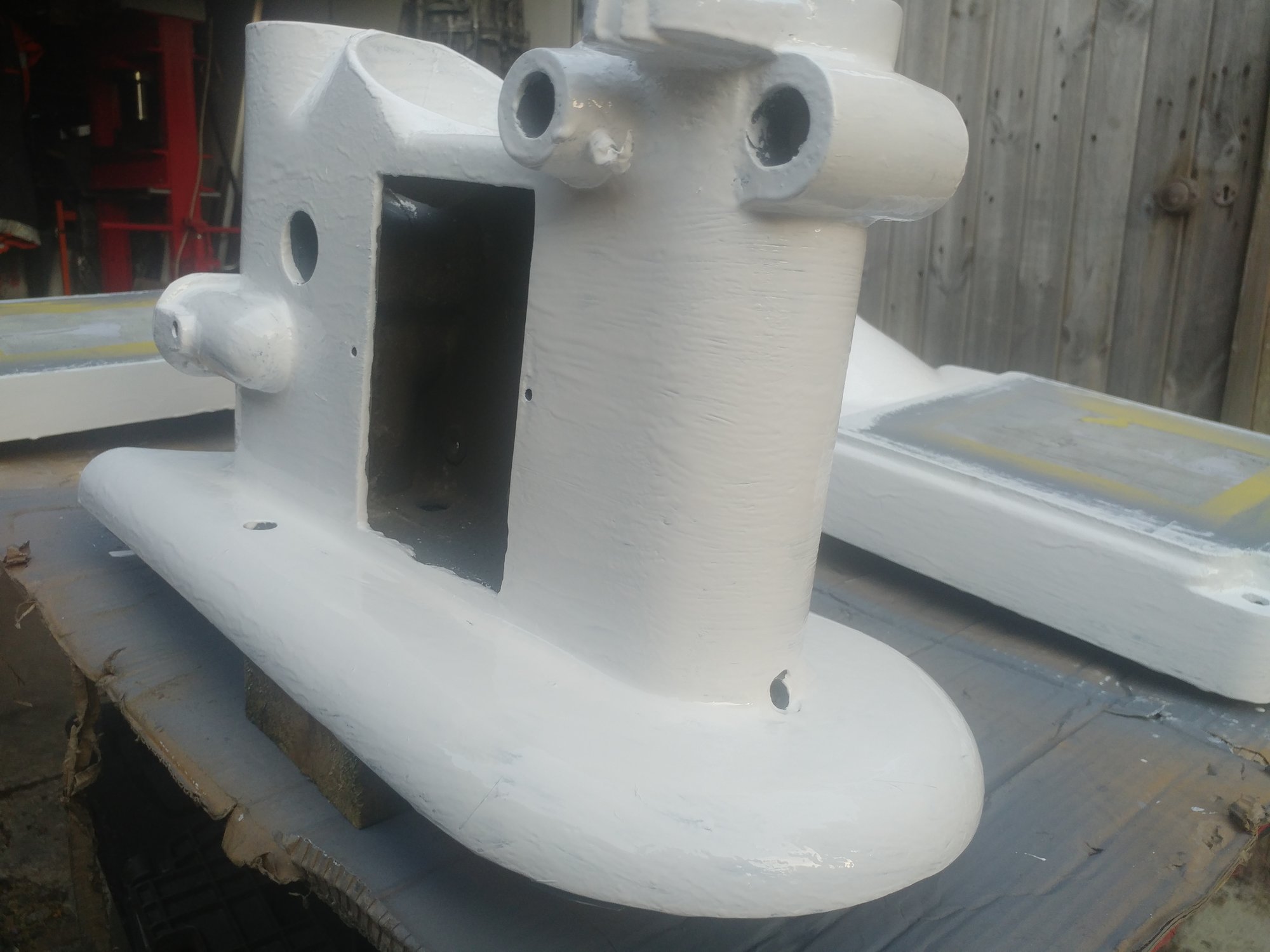

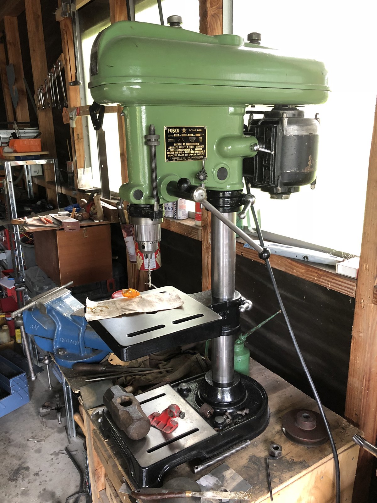

Been beavering away getting this thing prepped for paint. Took all the parts down to bare metal using a flap disc. Looks like it's had at least a couple of coats of paint since it was made, and it was covered in a thick layer of filler or high build primer to smooth things out. I might reapply filler to smooth things off a bit.

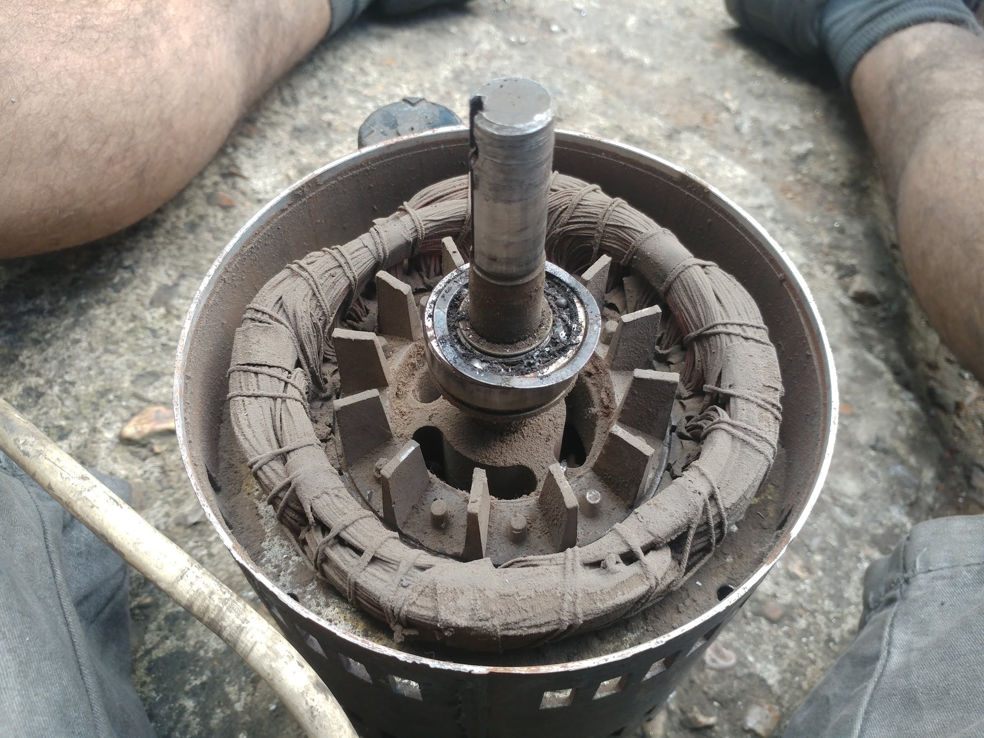

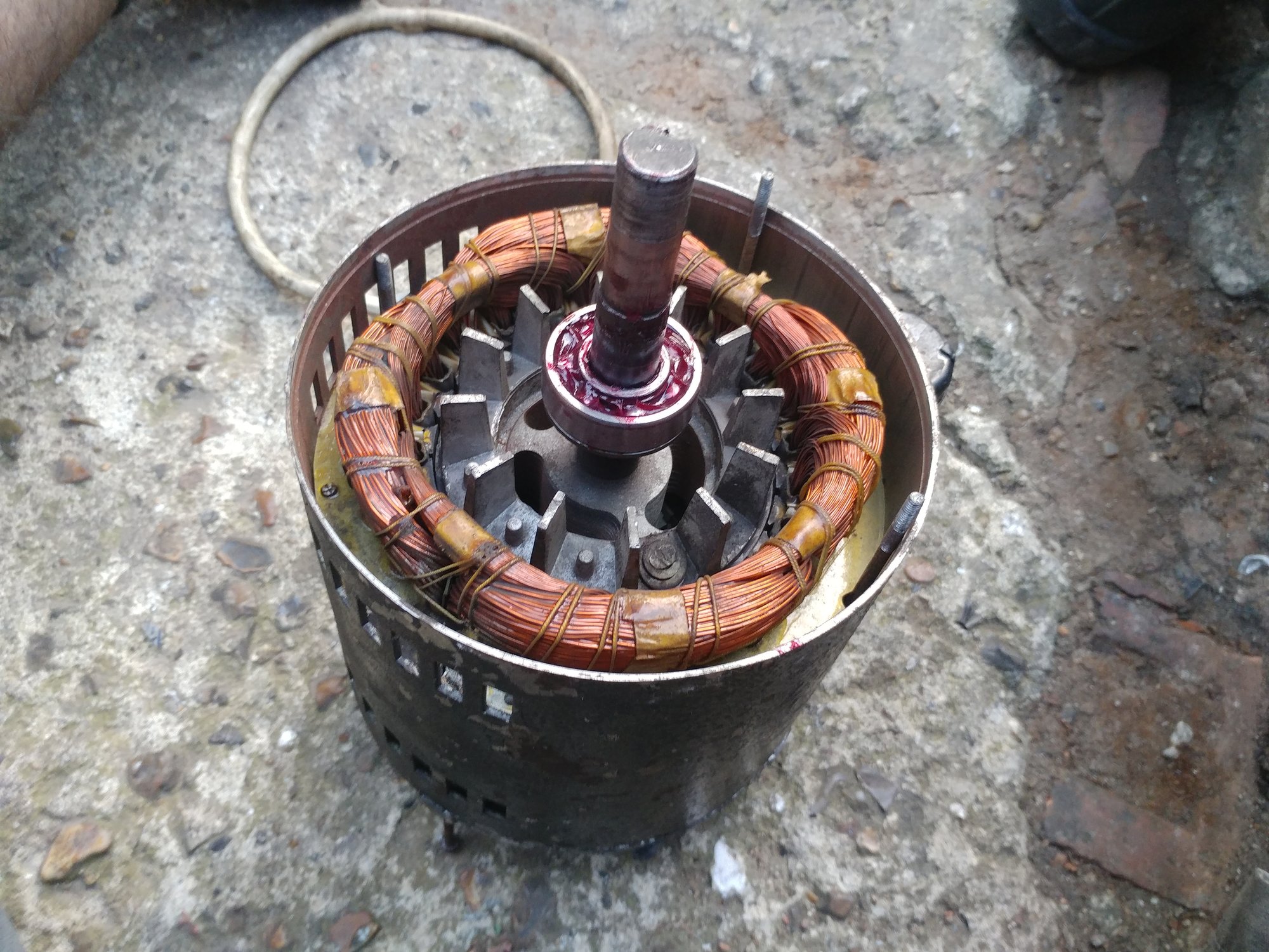

Also stripped the motor, cleaned and rebuilt. The bearings were nasty and felt very notchy. Now they're running nice and smooth. A small amount of play but not enough to warrant replacement.
I bought new bearings for the spindle at a cost of £50. Annoying because that's more than what I paid for the drill! I'll probably only replace them if they need it, otherwise they're getting cleaned and regressed.
