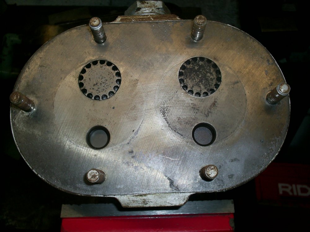

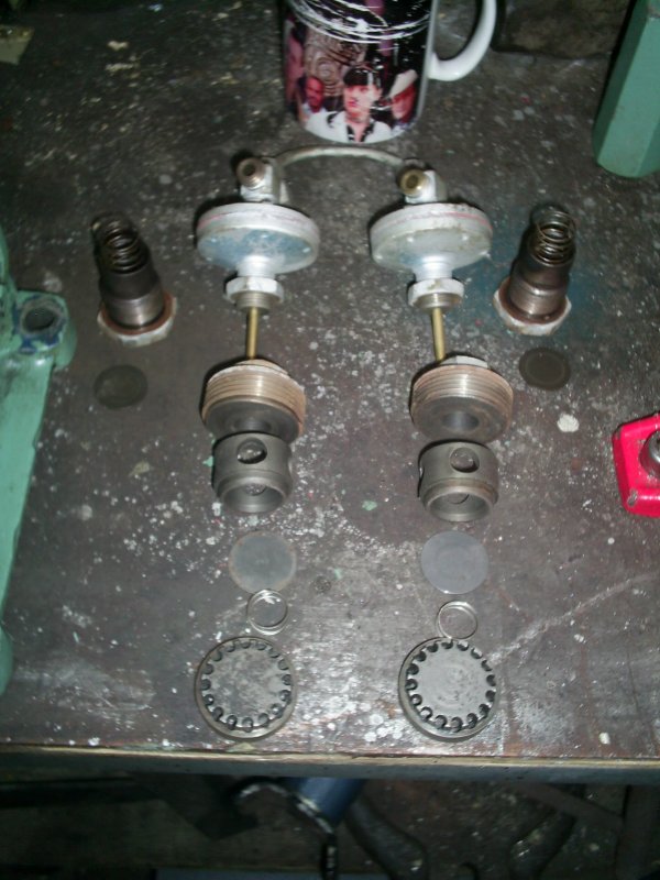

I think I might have worked out how the inlet valves work. If the controller allows air to the inlet valve from 0 to full controlled pressure then the valves will be held closed against the spring pressure and the compressor will in fact deliver compressed air to the tank. When the controller reaches the preset pressure required then it kills the feed to the inlet valve diaphragm/rods and the spring opens the plate valves and the compressor just idles!
