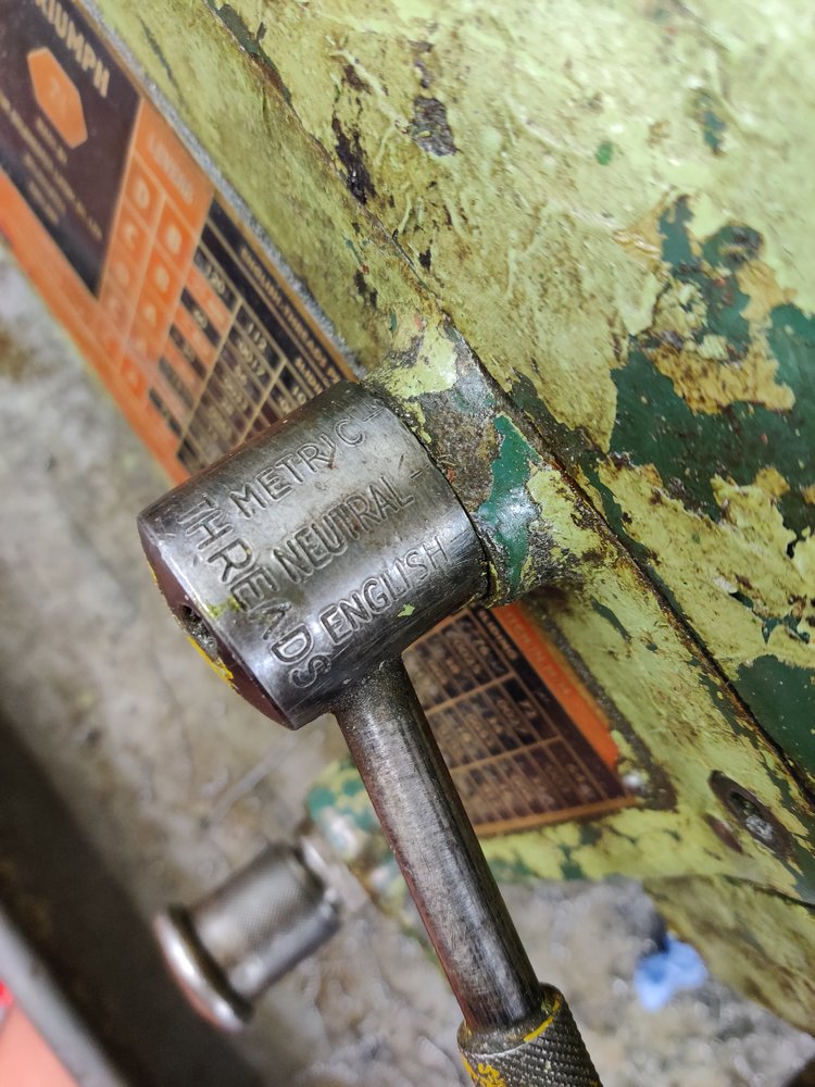

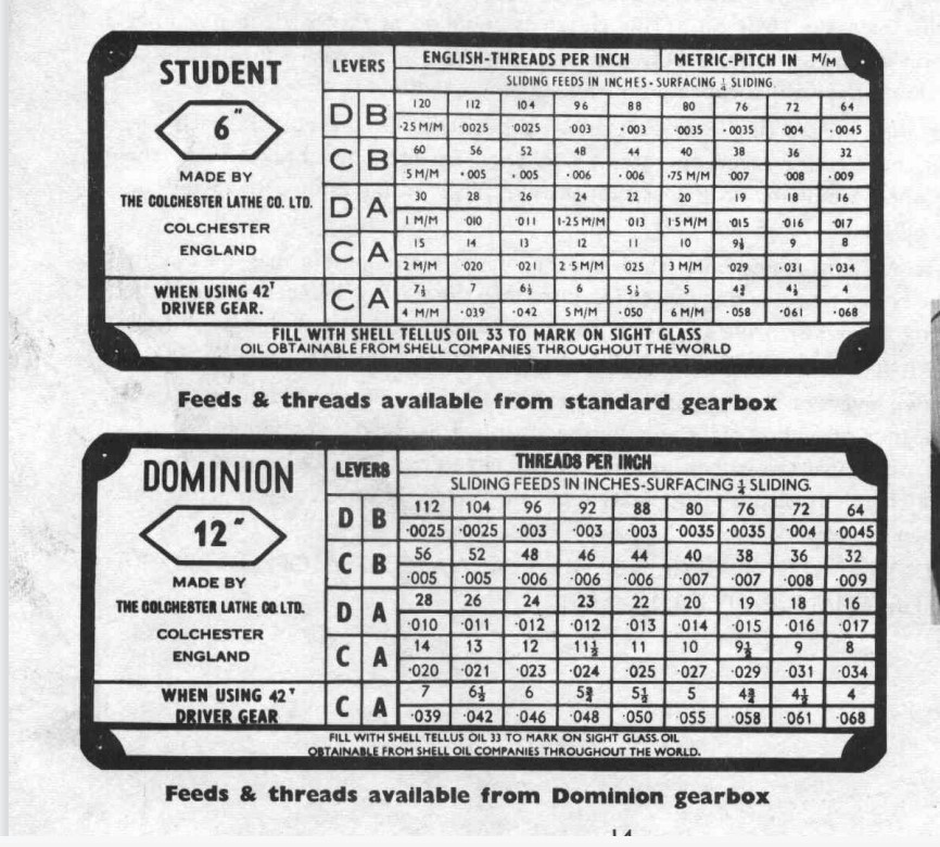

That may just be the imperial only box version, likely if it is Clausing. Thus lever is engaged or disengaged as no metric setting.The Triumph manual I got from Usinages says it's just a leadscrew disconnect. Likely there are several versions of the machine though the manual is for Clausing Colchester.

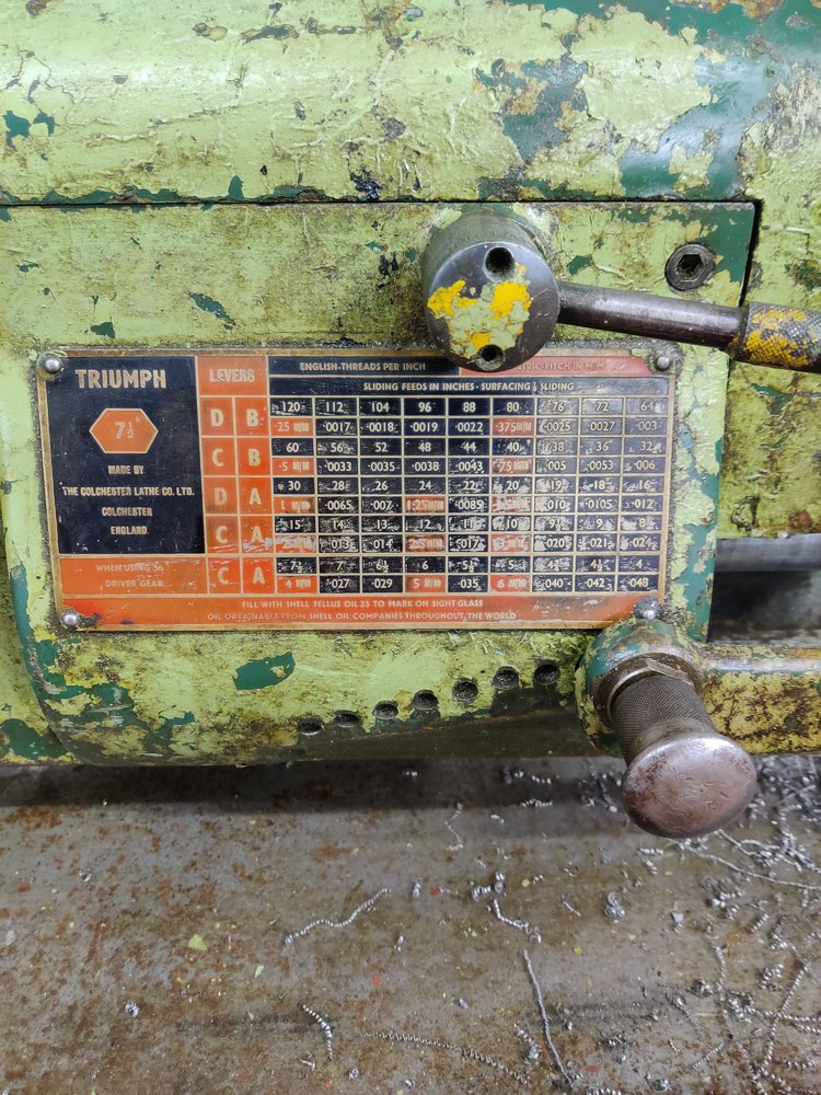

Regarding the feeds per rev, you would likely have lever 3 in the neutral position as it will not be using the leadscrew but rather the feed shaft.
Also if my memory is correct the surfacing and sliding speeds (thou per rev) are just used in connection with levers 1, 2 and 5 and you have lever 3 in neutral as you are not using the lead screw.
EDIT.
The sliding surfacing is actually displayed in inch per rev, so for example levers 1 and 2 in D and A, lever 3 in Neutral and lever 5 in position 3 you would have .011 ipr.

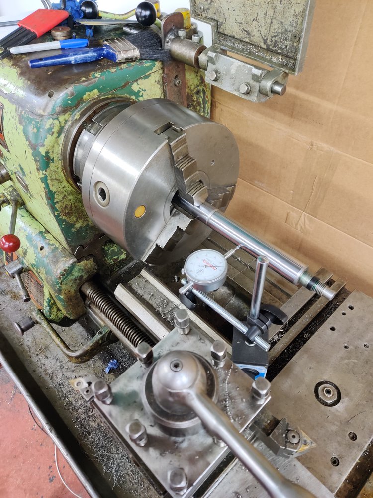

just did a quick vid to show there is no issue with the overhang, just mild steel but first two cuts are 2mm DOC (4mm dia), last is 3mm DOC (6mm dia).Some over hang on your post ,

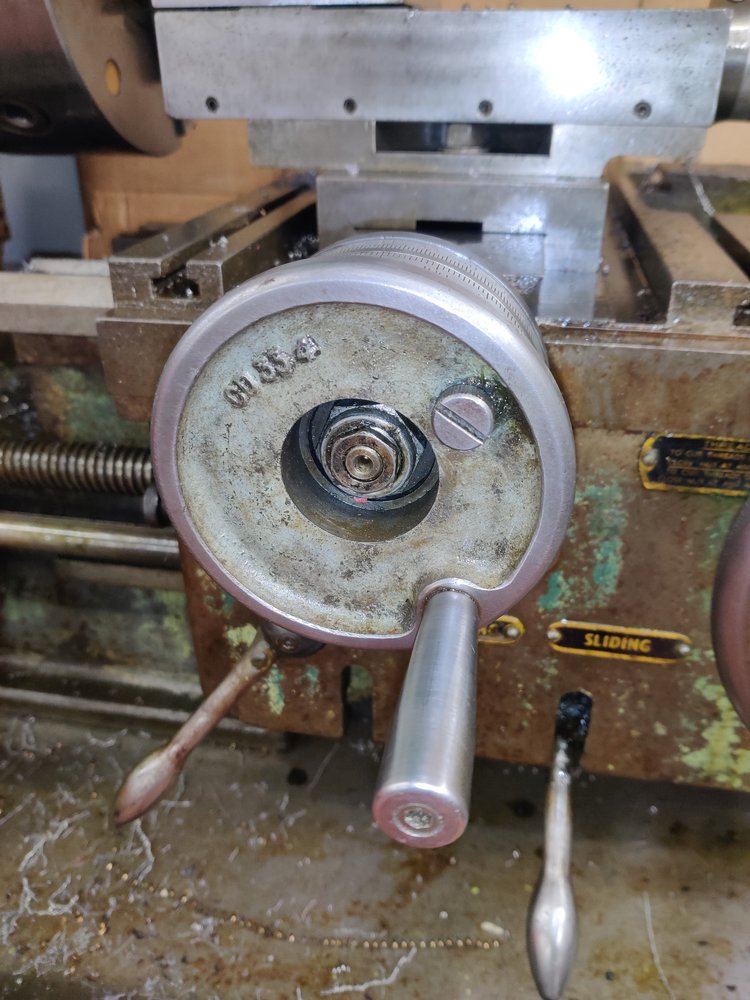

That play is normal when the screw is not preloaded, mine is much worse!
Check the gib adjusters along the tailstock side of cross slide.

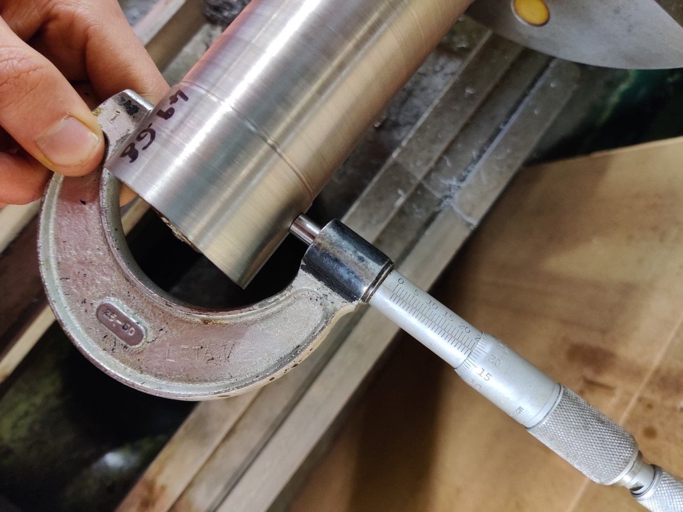

What grade of steel are you using? Some, mild can be horrible to get a nice finish and often changes along the length. Carbon, alloy or sulphur based free machining steels are very nice.

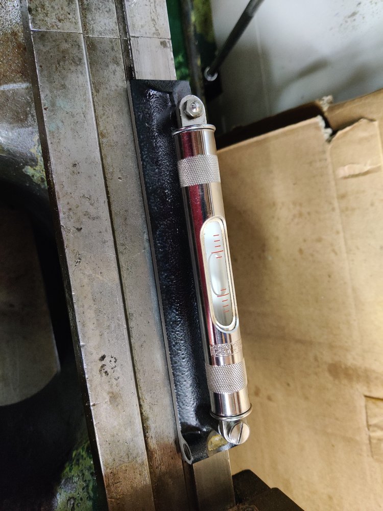

Don't worry about it being level front to back. It is twist you need to eliminate - and with a short bed version I bet there is almost none.
You need to set up a set of parallels to bridge the Vee and measure across the bed.
As to the finish you are getting I always struggled on steel until I bought the tool I linked to.
