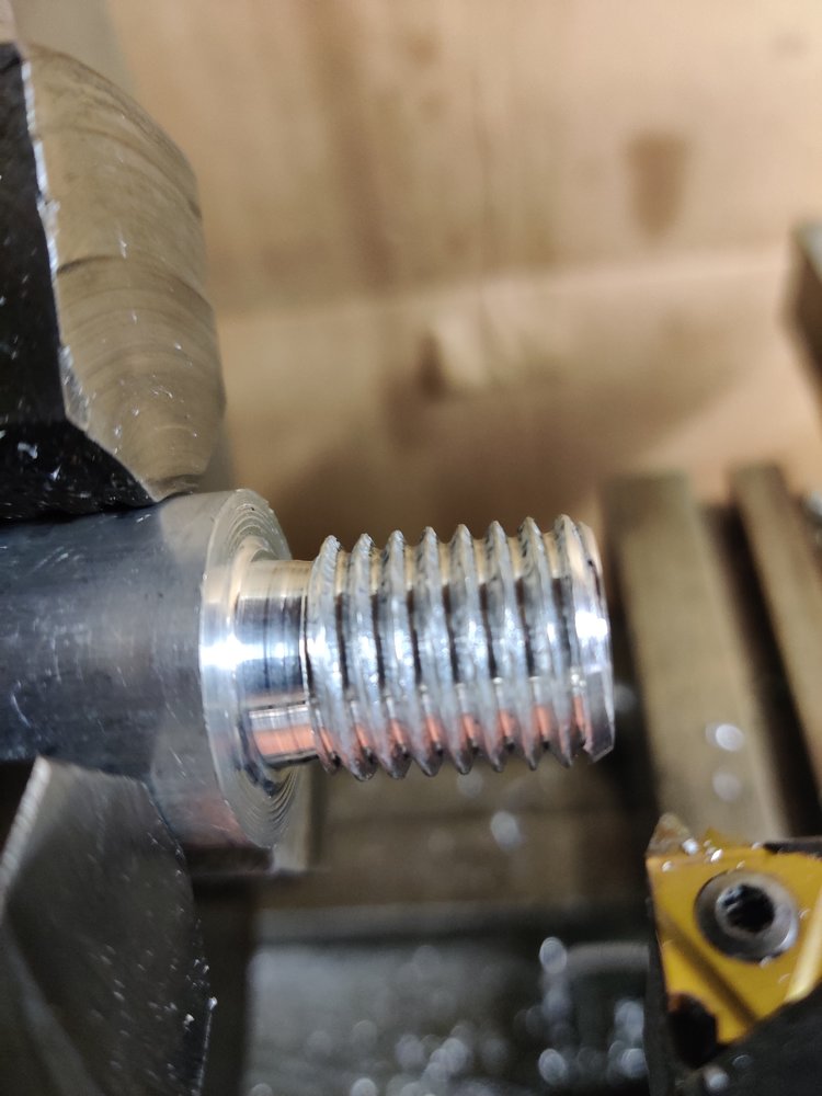

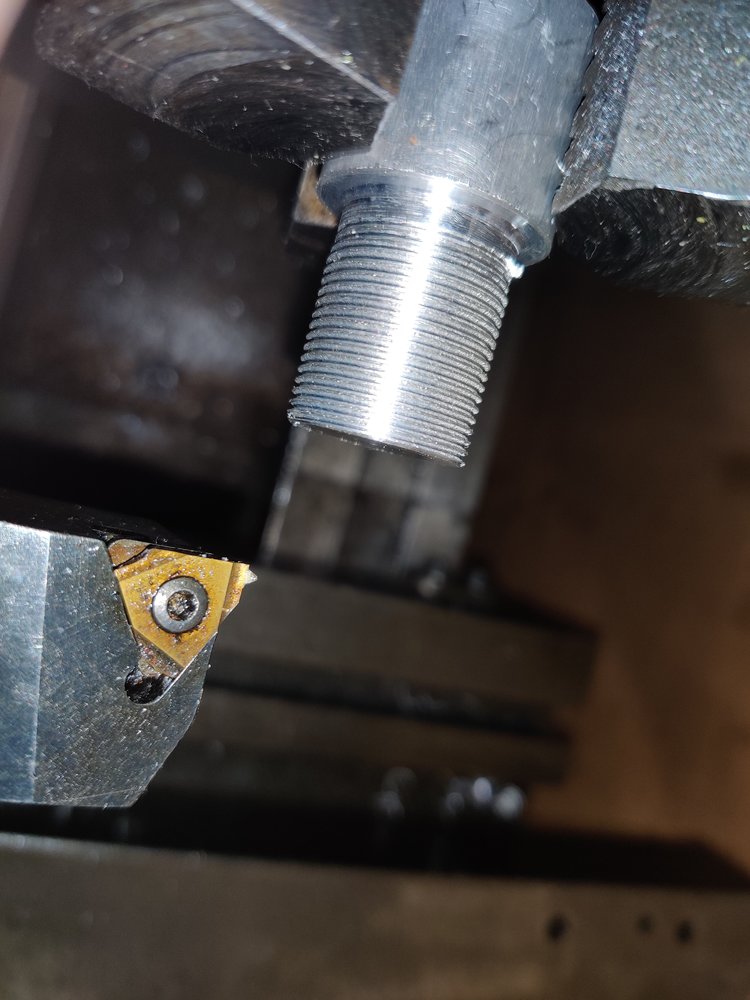

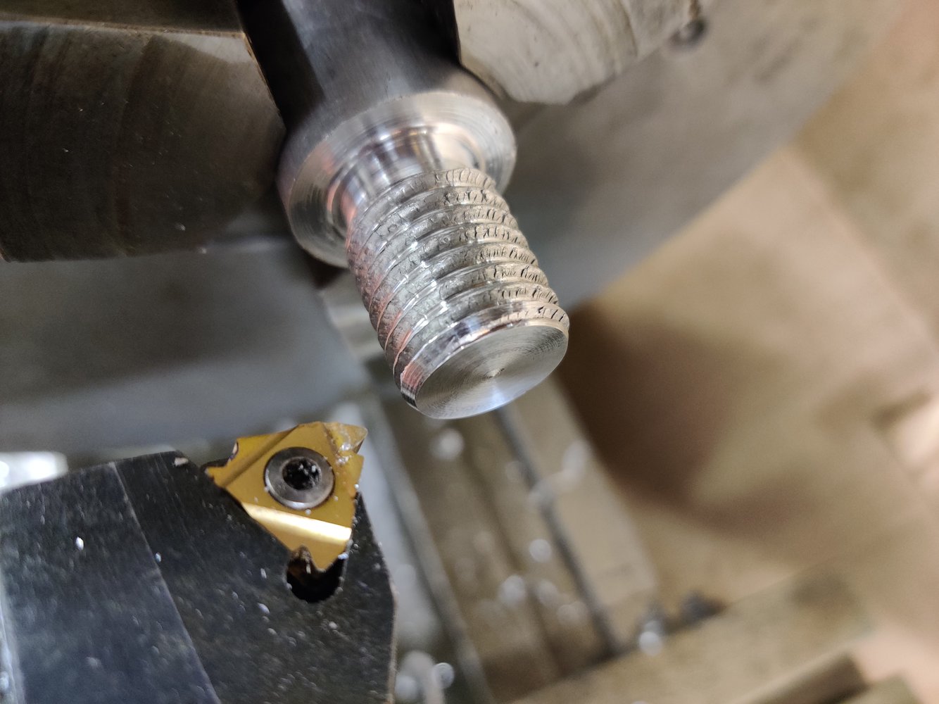

Playing with the threading tool tonight after watching a YouTube video or two , not that nice got a bit of chatter as using cross slide only method so I understand it cuts on both edges and the compound slide method is better so will need to try that to make them nicer
Not making real threads just practise bits really didn't grind the toolpost into the chuck so calling it time well spent getting used to the motions reversing etc
