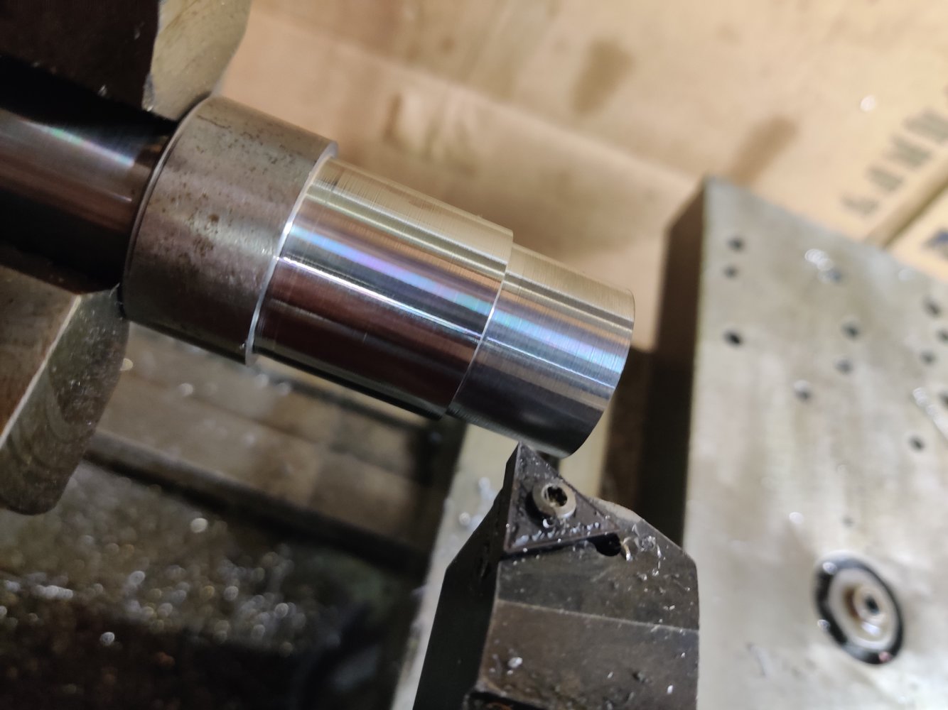

@Lewis_RX8 just wondering if you are using the power feed when you are getting these marks or just feeding by hand?
Power feed was engaged away from work piece at 5 Thou Per Rev and let it feed itself in.
Maybe hand feeding could be worth a shot to see if maybe the power feed is causing it but that seems unlikely in my unknowledgeable opinion
Power feed is usually a lot easier for getting a better finish than hand feed as it should be a constant feed which would be hard to get by hand. It is certainly worth trying a hand feed to see and if it is better then you will have to start looking at the feed shaft. It might also be worth trying it in a fine thread and engaging the leadscrew to see what it looks like.
I'm far from being an expert but IME powerfeed gives a better (or at least more consistent) finish.
The other issue with aluminium particularly is it has a tendency to build up on the tool which can cause issues.
I've found the sharper CCGT inserts make quite a difference as well as ensuring plenty of lube. It's quite noticeable if you're cutting dry that a squirt of WD40 will leave a smoother section.

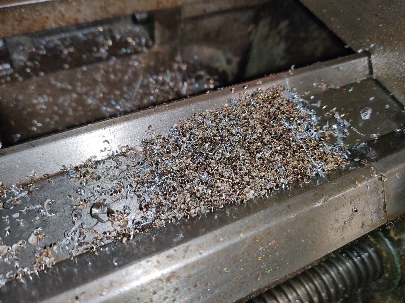

Think their kennemetal at a guess TNMG 160404 would need to have a look online for the spec sheets never easy to find.Looking at the vid your finish is perfect off the tool but it's getting torn up by the curling chip about 1-2mm behind the cutting edge.
Change your tool angle so that the shank is parallel to the chuck face. That's the angle it is intended to be used at. Look at the DOC and feed specs for the insert if you know the manufacturer. Set the machine to those settings and take another pass. If you can't find the speed and feed specs try increasing the feed and reducing the DOC, and try a bit of lubricant.

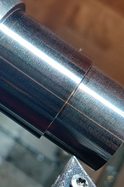

Yup especially on this crappy mild steel bar , now got it sorted on that will be even better on proper free machining steelsNo ridges in that finish, anywayDead satisfying when you get it that nice!
