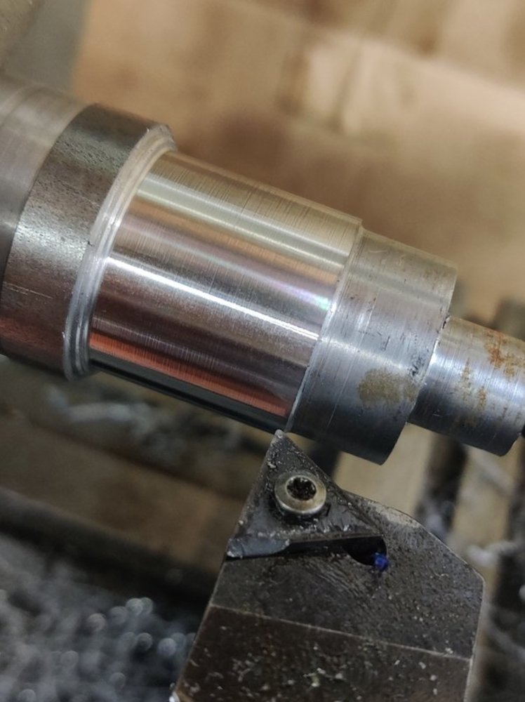

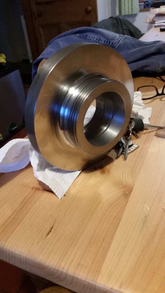

Well managing to get some progress , made sure all the gibs where nipped up , I just fully locked the compound slide as recommended by hood before as was not using it so try and take play out of the equation. I also ran it at a speed far away from the resonance to try and cut down on the vibrations. New tooltip because I was too ham-fisted with the tool post and smacked the insert into tailstock but never mind new cutting point on insert took any dullness out the equation.
1200RPM , 5 Thou per rev feed and 0.8 DOC on a 04 radius TNMG from kennemetal.
Now I say it the photo shows up the feed marks more so than by eye but they are a lot less apparent than they where before and can just be picked up by fingernail where as before it was like rubbing your nail on a file as the grooves where deeper.
Now the next part with turning like this taking heavy DOC working out how the spring in the part works as I see if you go in say 0.5mm DOC then go backwards it cuts more so I assume this is the spring somewhere and makes it more difficult to get to a final measurement compared to light cuts.

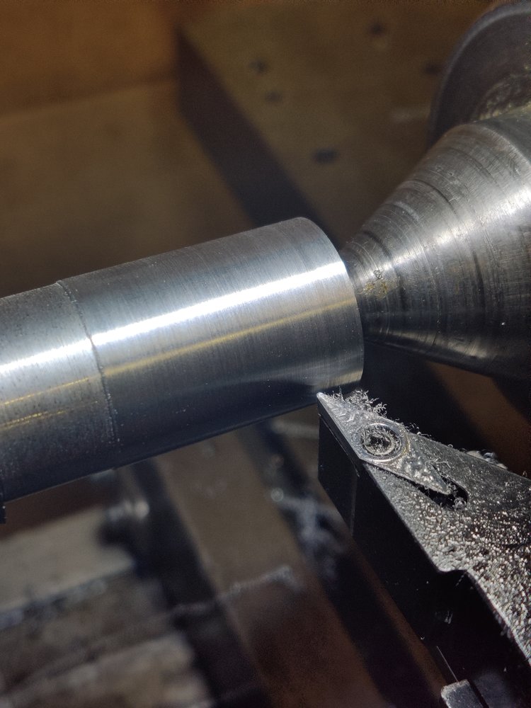

And here is how bad the lines where before
Then with the lowest feed at 1200RPM using the ultra sharp ally inserts it gave a nice finish which seems to be alot more uniform than what I have been getting previously not a mirror but a very very smooth finish with uniform lines and reflections so happy with that. Will be very handy if holding tight tolerences as can shave off a few thou per cut happily and leave a good finish.

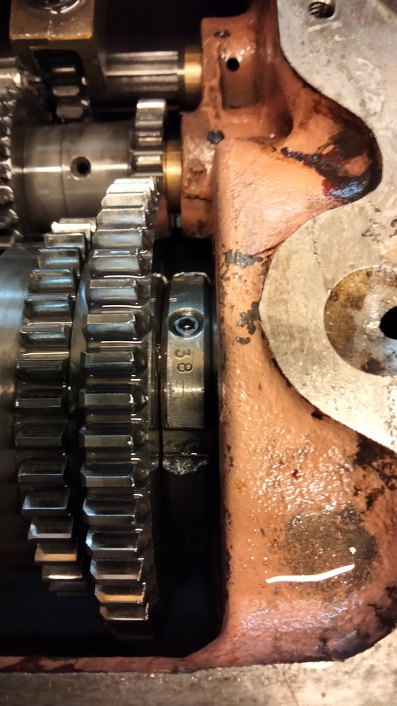

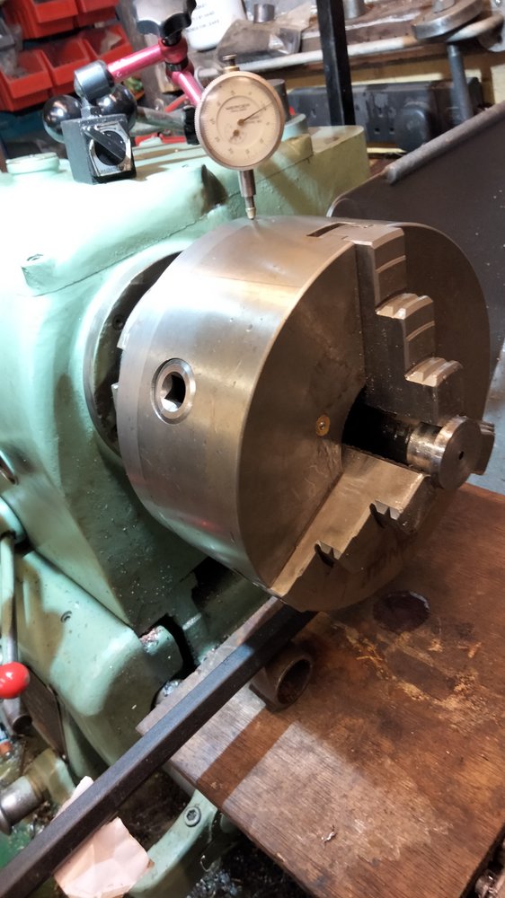

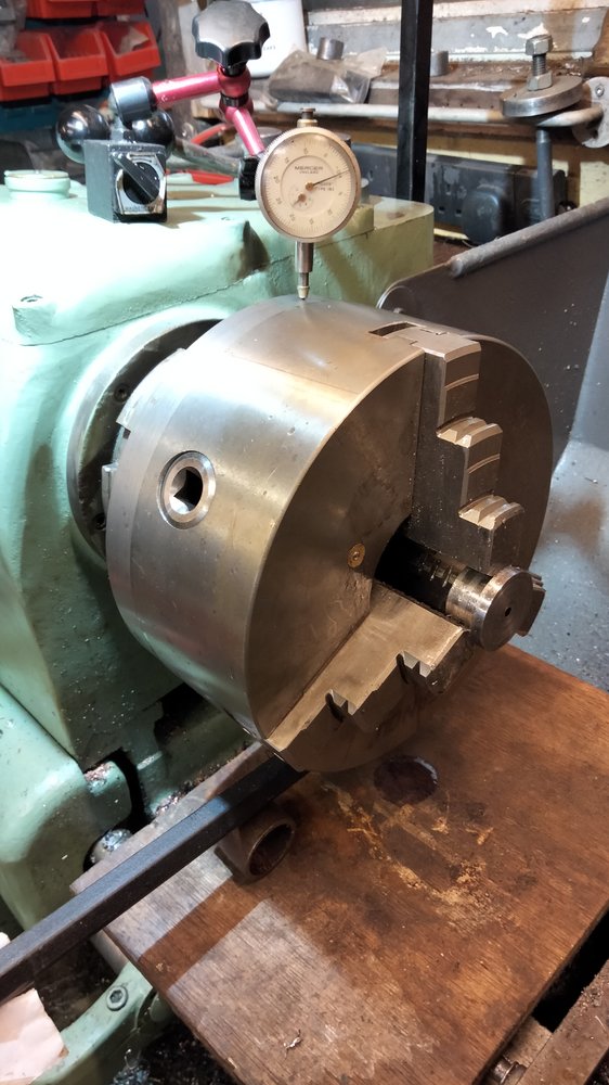

Also had a go with the proper technique I hope for checking the spindle bearings , Seems about 0.02mm of play up and down with force on a pry bar pushing up. Will need to remember to try when it is warm
Unfortnatley not sure what exact measurement I am looking for here as do not think it was published by colchester in the manual but it seems reasonable to me.

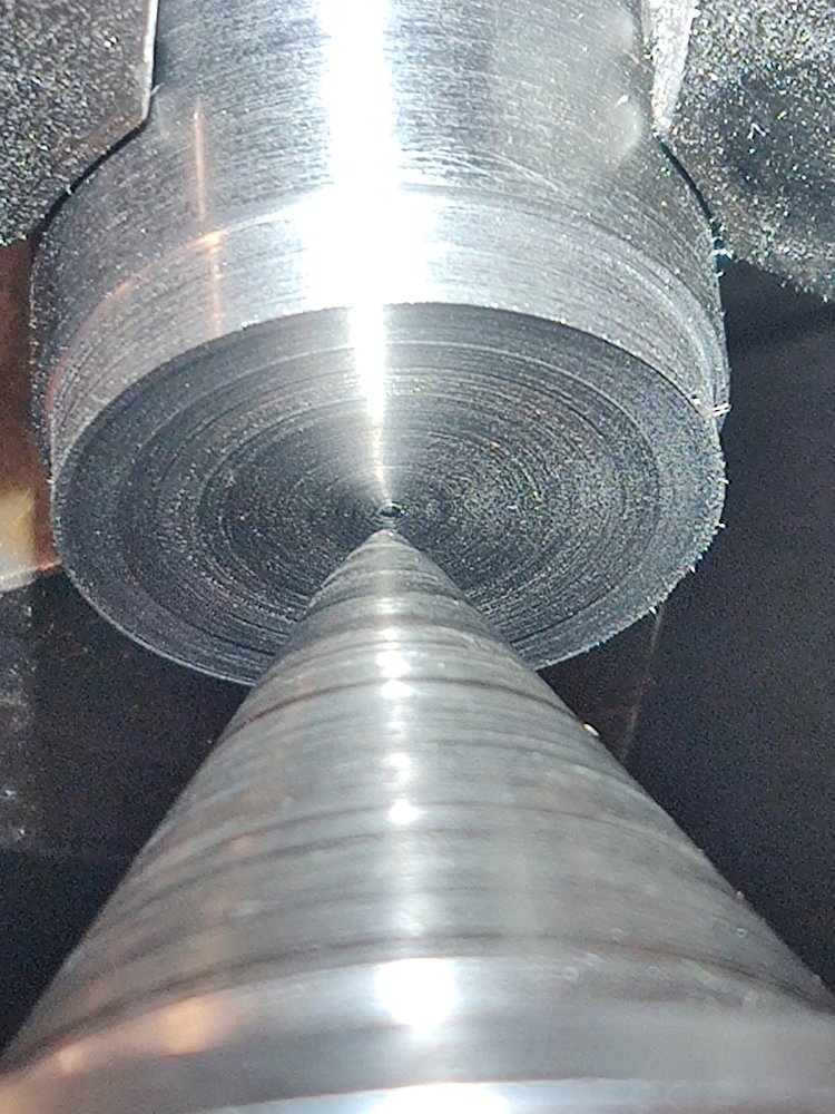

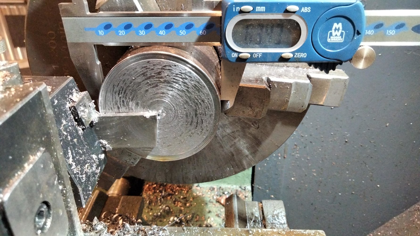

Now doing this I was using the tailstock a little aswell and forgot that I had aligned the headstock so will need to align the tailstock now as it would not sit right inparts and was being pulled , The manual calls for a ground test bar which I dont have so thinking of using the simmilar method to headstock alignment turning a test bar and using mics on it untill all taper is removed then I know it is running true and not pulling the part to either side.
Photo didnt really work but by eye it was clearly not aligned
