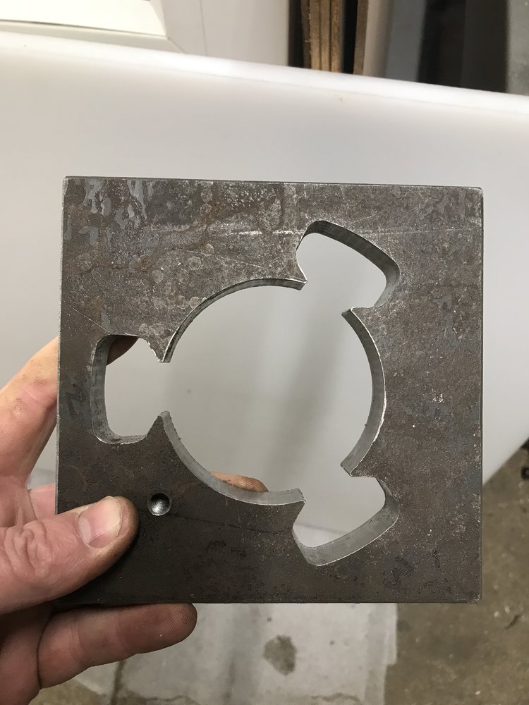

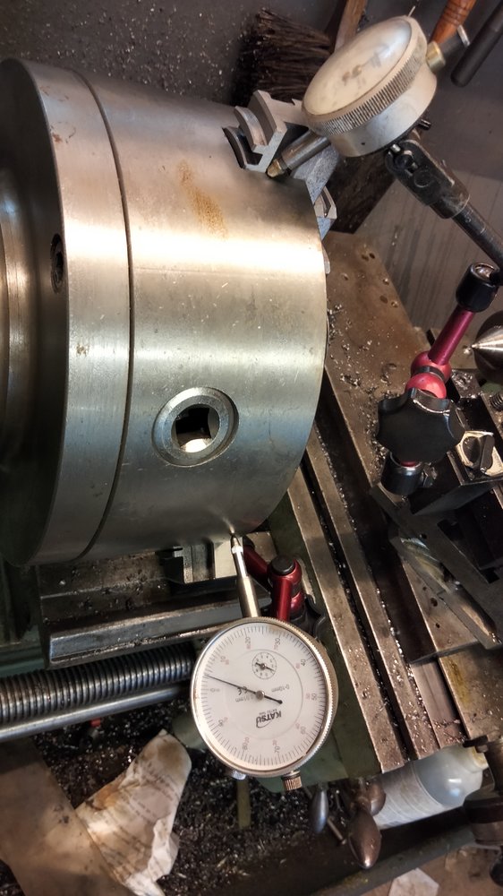

No issues with regrinding jaws as long as it’s done properly, which most people don’t
And even when they do they're left radiused, not flat as originally.No issues with regrinding jaws as long as it’s done properly, which most people don’t
Have a good look at a set of jaws. They are radiused from new. Well , the jaws on the Colchester Mastiff are, the jaws for my Bison are, the SWM auto blok ones are, as are the ones from my Hitachi SeikiAnd even when they do they're left radiused, not flat as originally.
I'll have a look, they didn't seem radiused to me. Or do mean you convex, which would be fine. Concave isn't what I would want, except on soft jaws.Have a good look at a set of jaws. They are radiused from new. Well , the jaws on the Colchester Mastiff are, the jaws for my Bison are, the SWM auto blok ones are, as are the ones from my Hitachi Seiki
Most chuck jaws are ground concaveI'll have a look, they didn't seem radiused to me. Or do mean you convex, which would be fine. Concave isn't what I would want, except on soft jaws.
You are absolutely correct.I reground a set of jaws for the Mastiff using the jig I made in the photo. Totally transformed that chuck.

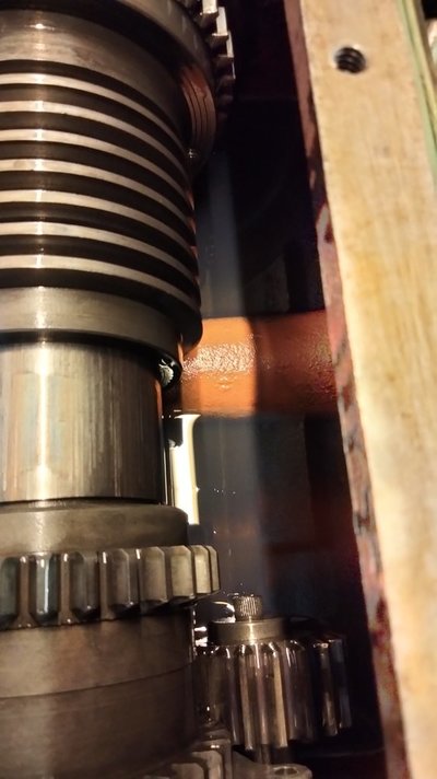

When I checked the Student lathe to find out why the oil point on the leadscrew end bush was blocked. It turned out that the casting core had never been cleaned out. So for 60yrs it wasn't used. Must have been oiled from the ends.
