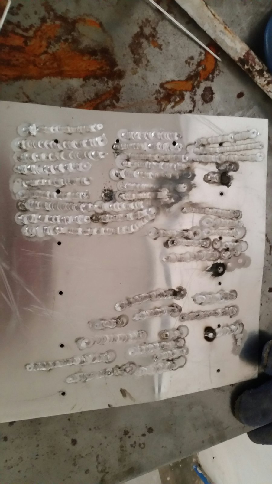

Back step it while phasing down.Need to work a bit on the crater filling, sometimes I manage others I don't, easy enough to rectify but better if it is not there.

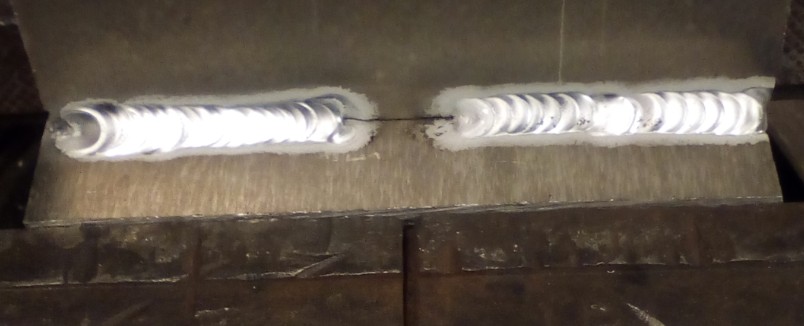

So long as you keep the arc and pool right in the corner you can do it however. There is no written rule on it.The most my welder will do at 180amps is 110Hz, goes as high as 200 at lower amperages.
For me the 140amps and 75Hz seemed to be the best, the one on the right just didn't feel right and, to my eyes at least, doesn't look right.
As said probably just what I am used to.
It is mad the difference a higher frequency, even just 40-60hz more can make on a fillet joint. The better the pool flows into the corner the quicker you can progress down the joint and ultimately the neater it comes out in my experience.
Assuming you did the first run at the higher frequency/current when the plate was cold and the second at the lower settings while it was heat soaked then yes that make sense but your lower settings were not making you go faster the plate heat was. If that's not the case and both performed cold then that doesn't make sense to me.
