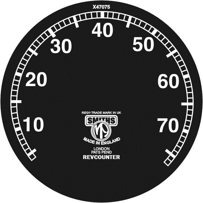

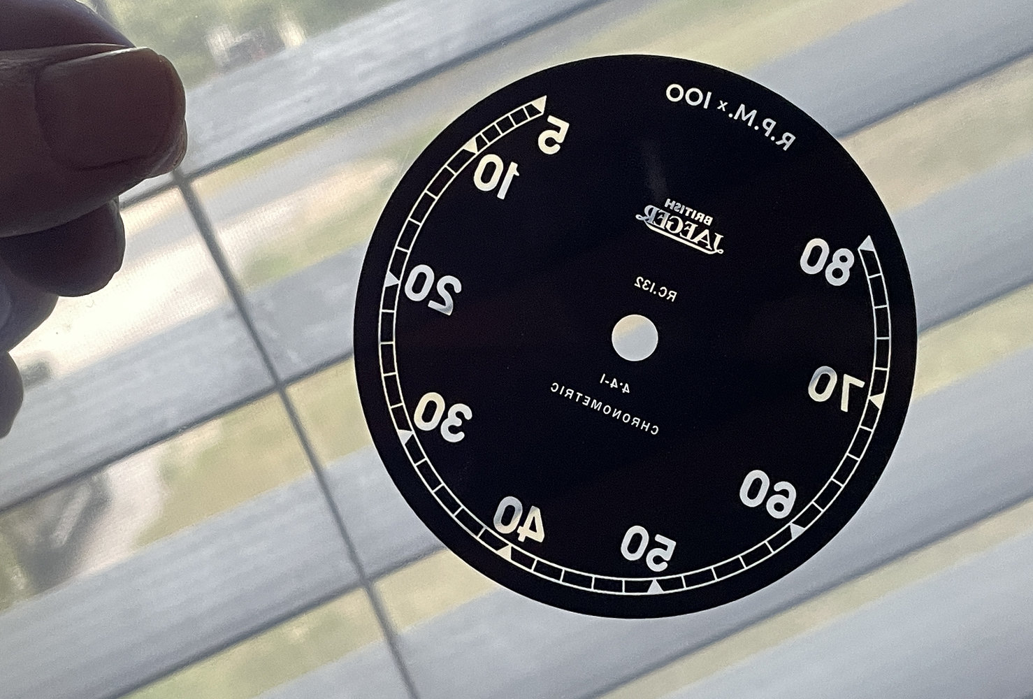

that is awesome loving your workThis is a positive film printed from the artwork on special inkjet transparency film. It's reversed so that the emulsion side of the film will be against the photoresist film when exposing the metal plate. It will be a few days before I have a chance to try it out, as some supplies have just been ordered. I plan to make a couple of reproduction data plates for my 1954 Dodge M37 at the same time.
