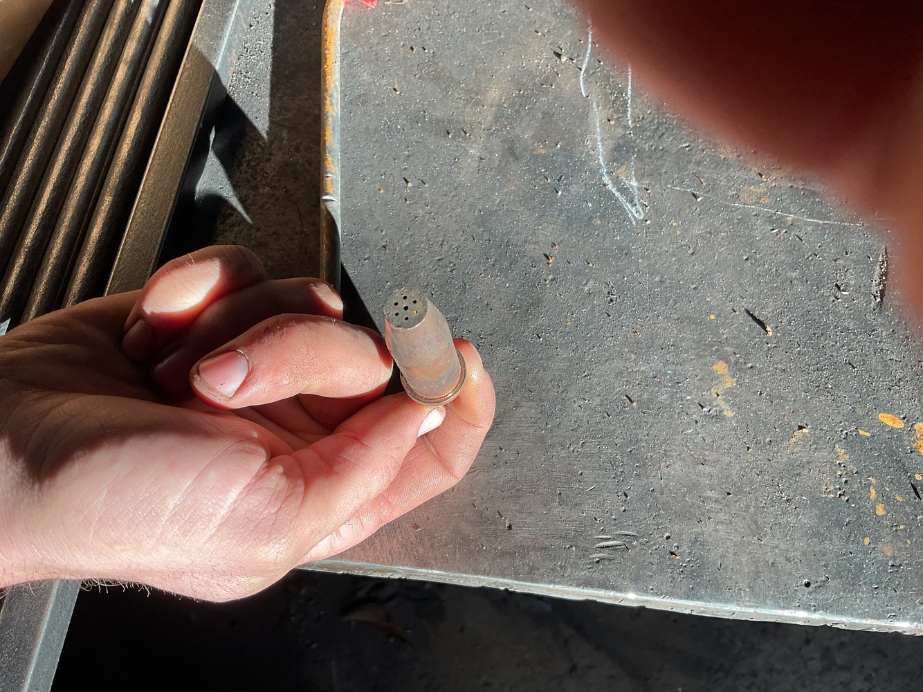

That's an acetylene nozzleThe one I used,it all went very easy and cut just as clean.View attachment 466336View attachment 466337
Yup ^^^ or hot start it.It's easier if you rest the nozzle against a piece of scrap steel, with the flame playing across the plate somewhat parallel, before you open the oxygen.
I don't know why it is, but it is in my experience.
In that case, can I also interest your grandmother in taking an egg-sucking class?I'm aware of that.
Exactly.cuts perfectly.That's an acetylene nozzle

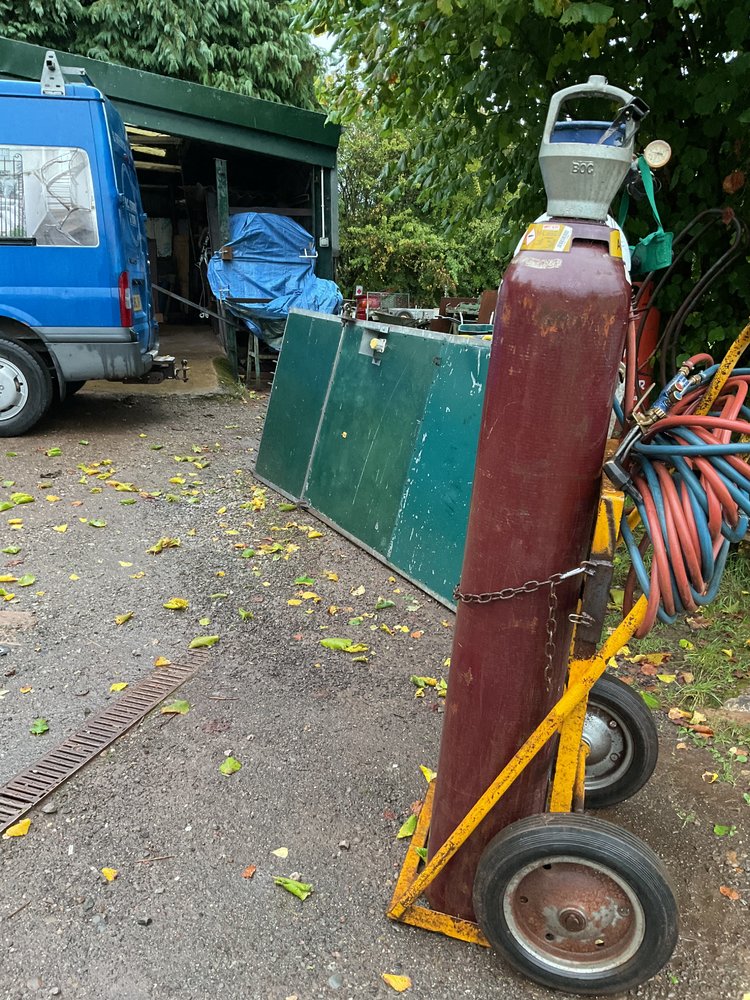

So after 39 years it’s goodbye to acetylene,it’s now off hire,£12.50/month better off.View attachment 467440
I find propane cuts as fast as acetylene but it's slower to preheat before cutting. You do need higher pressure oxygen though.Having done some more cutting on mainly 12mm plates,it’s slower progress than acetylene,maybe that’s where a dedicated propane nozzle is now necessary?
You need for sure a dedicated oxy propane tip.Having done some more cutting on mainly 12mm plates,it’s slower progress than acetylene,maybe that’s where a dedicated propane nozzle is now necessary?
That's true but it spreads the heat on a bigger area.I find propane cuts as fast as acetylene but it's slower to preheat before cutting. You do need higher pressure oxygen though.
Cheaper, safer, and it cuts just as well.Scrappies have allways used oxy propane for cutting.

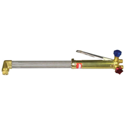

But you'll get the better results with a dedicated torch.
I have as said up above an injected Harris torch, those torches are fuel specific.
They use an injector which is nothing more than a Venturi in head mixer, with specific diameters and volume for said gas.
