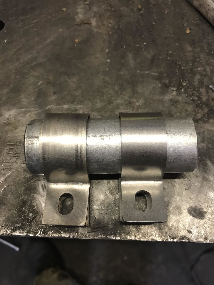

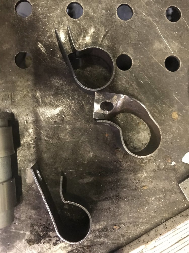

These are all good, but you have to show the flat blank in them as well, not just the finished, closed item. If the tooling is horizontal, the blank can just lie on it but you still have to consider how to stop it moving forwards and backwards, to ensure the bend is the correct distance from the end of the blank.
When discussing with the client, it might be worth finding out how he will install these. If he slides the end of the tube into the clip, it is better to supply to him as 'closed'. If he pushes the clip sideways over the tube, then it would be better to supply them 'open' (and the open option is less work for you making them).

Think about it... this is as efficient as I could see it in my head in a normal sheetmetal shop:
1. guillotine strips
2. use custom form punch on a metalworker to radius the ends and punch holes
3. punch 90 degree bend in one end
4. hand form the U shape around a form jig
And that's assuming your tooling is minted sharp so you don't have sharp edges to deburr... might get it with a tumbler, not sure...
£2/ea is probably not a bad figure to start from...

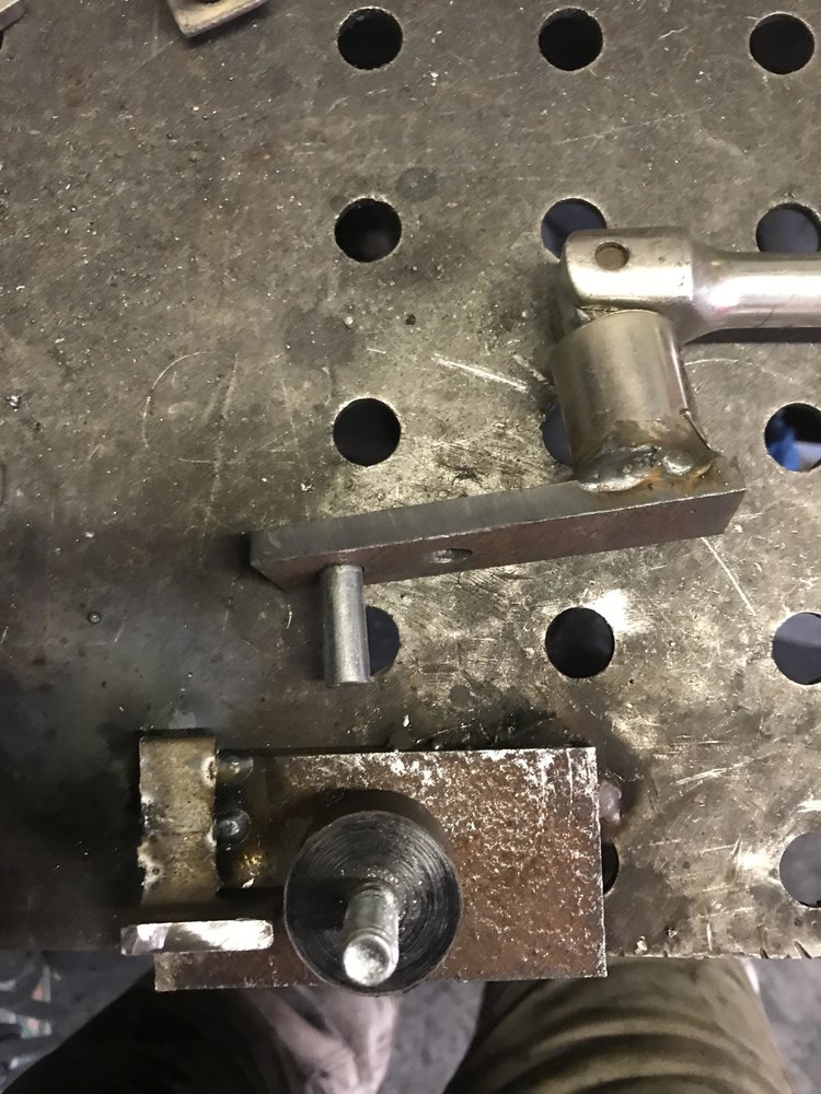

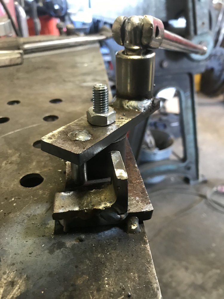

Its more the 'can I do it' and 'how' than actually wanting to do it so I am there with you on that one.The most expensive part of the operation would be a custom form punch for the ends... you could get by with a generic radius punch and a hole punch, with properly set up fences, but you're then turning one operation into 3 operations, and ironworkers aren't the fastest moving things...
A better option might be to laser cut them, cutting out 3 operations altogether, assuming you can get a tidy finish on thin stainless... and definitely tumble them. The 90 deg fold is dead easy and quick on any sort of machine with a fence/backstop, and then you're left with the U bend. A custom form tool for this would be easy and cheap to make, and assuming 1mm or less, it'll be a hand operation with suitable fences.
Not that I'd want to do the job in the slightest, even at a decent rate... but it intrigues me to work out how I'd manage to do it most efficiently and £2/each would make it pay, if you did it just right... be plenty boring after the first 50, though!
