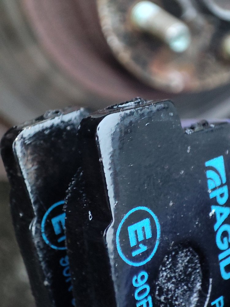

Used a different brand tonight on my own car, Allied Nippon rear discs and pads on my Freelander 2. I have used these before and they seem like decent quality. Once again these use stainless pad guides clipped into the caliper carrier. Unfortunately new ones not supplied with the pads. Cleaned up the old ones OK and re attached them. Two of the pads were a little too tight and needed a light tickle with the angle grinder so that I had nicely moving pads on both sides. Not to the same extent of the previous Pagid ones in my initial post though. I've no doubt most garages would just bang them in and not worry about it but hopefully spending a little time and effort will ensure they continue to function properly.
I've found that the cause of binding brake pads is more often corrosion under the mounting shims, rather than oversized brake pad backings.
The shims you describe have a 'slippy' coating and often a plastic conformal coating on the carrier side, the idea is to reduce 'chatter' and allow the brake pads to withdraw from the disc sufficiently to prevent brake squeal. As you know, the mounting shims should be changed with the brake pads to renew the 'slippy' properties - in most cases, the application of metal-loaded grease will just attract brake dust, causing friction and therefore binding of the brake pads.
Before the copperslip fans get involved, there are no car manufacturers that apply metal-loaded grease to the moving parts of braking systems.... with good reason. I've lost count of the number of adhesive brake pad backings I've seen slathered with copperslip!
Do you have a brake caliper file? It's a special file for removing rust and debris from inside calipers. You shouldn't require grinding new pads, I suspect it's not cleaning the calipers thoroughly enough. Having fitted possibly hundreds of sets of brake pads, I have never once had to grind a new pad.....
Oh I been fitting brake pads for 42 years and yes I have had to "dress up" some awful fitting brake pads in my time.
It's rare though you have to admit no?
If you find this is needed often then I suggest you buy your parts somewhere else!
Wish I saw this thread a few weeks ago, I didnt know Pagid were a ECP brand, tho I did know they are supplied by them to Halfords. Halfords were cheaper.
I had to use a file as they were oversize plus the paint lumps. Yes I should have inspected before leaving the shop.
ECP seem to supply all of the local mechanic business here, so thats a good reason to do the work myself and buy elsewhere! I shall avoid ECP.
