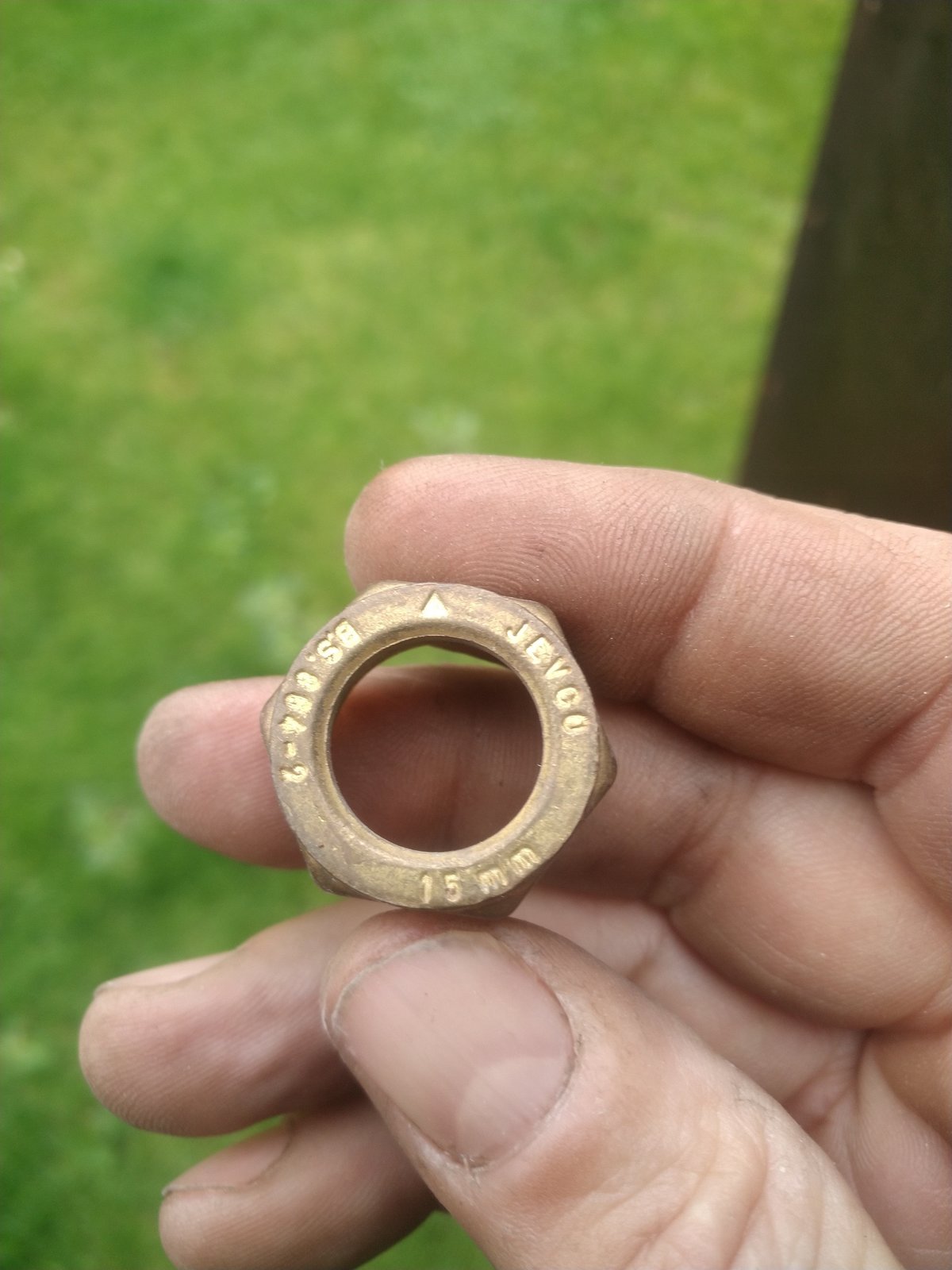

as I say, on plumbing compression fitting there is a Arrow on the nut. Do up until snug then half a turn. @8ob I prefer Boss blue. It doesnt go hard
