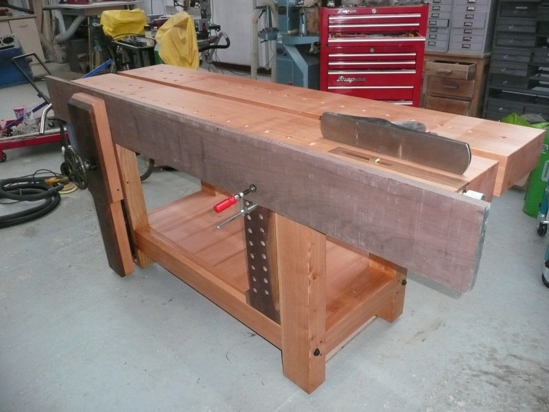

Looks fantastic, but educate me please. What’s the function / purpose of the sliding deadman?
May I ask what arrangements will , are made at the bottom of the vice!
Ta
You can put pegs or clamps in the sliding deadman at different heights to support long timbers or panels held in the vice so they are supported when you push down to plane or saw. A picture speaks a thousand words, here somebody else using one as the bench is currently drying after a coat of Osmo Polyx hard wax oil/ I may put some hole in the right hand leg, same reason
