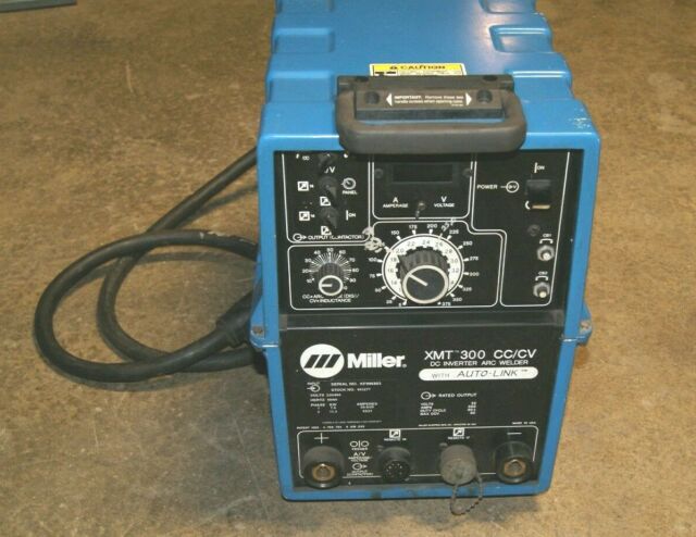

i thought it was miller who bought them outThey are the best of the best.. do well on scratch tig too
Every movement of the hand is accompanied by a different tune they are so vocal and make a tick tick tick noise like a metroknome
Sold the patents to kempp.i
