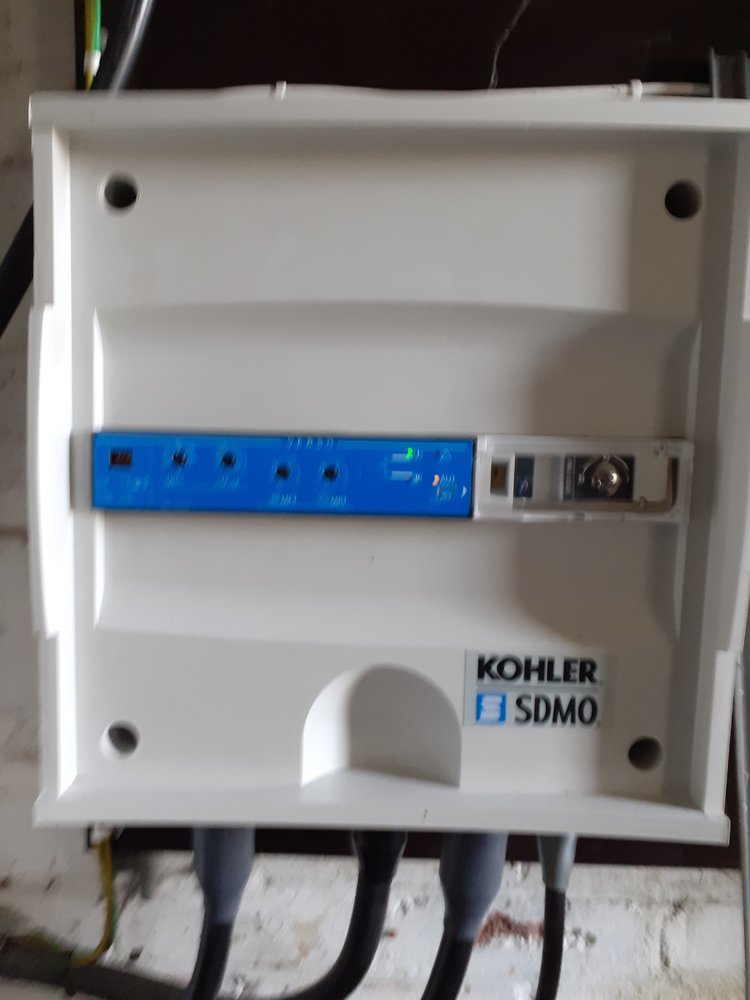

Little SDMO Verso units with a dinky motorised c/over by Socomec in it I recall.We use these on our smaller gen setsView attachment 337695
