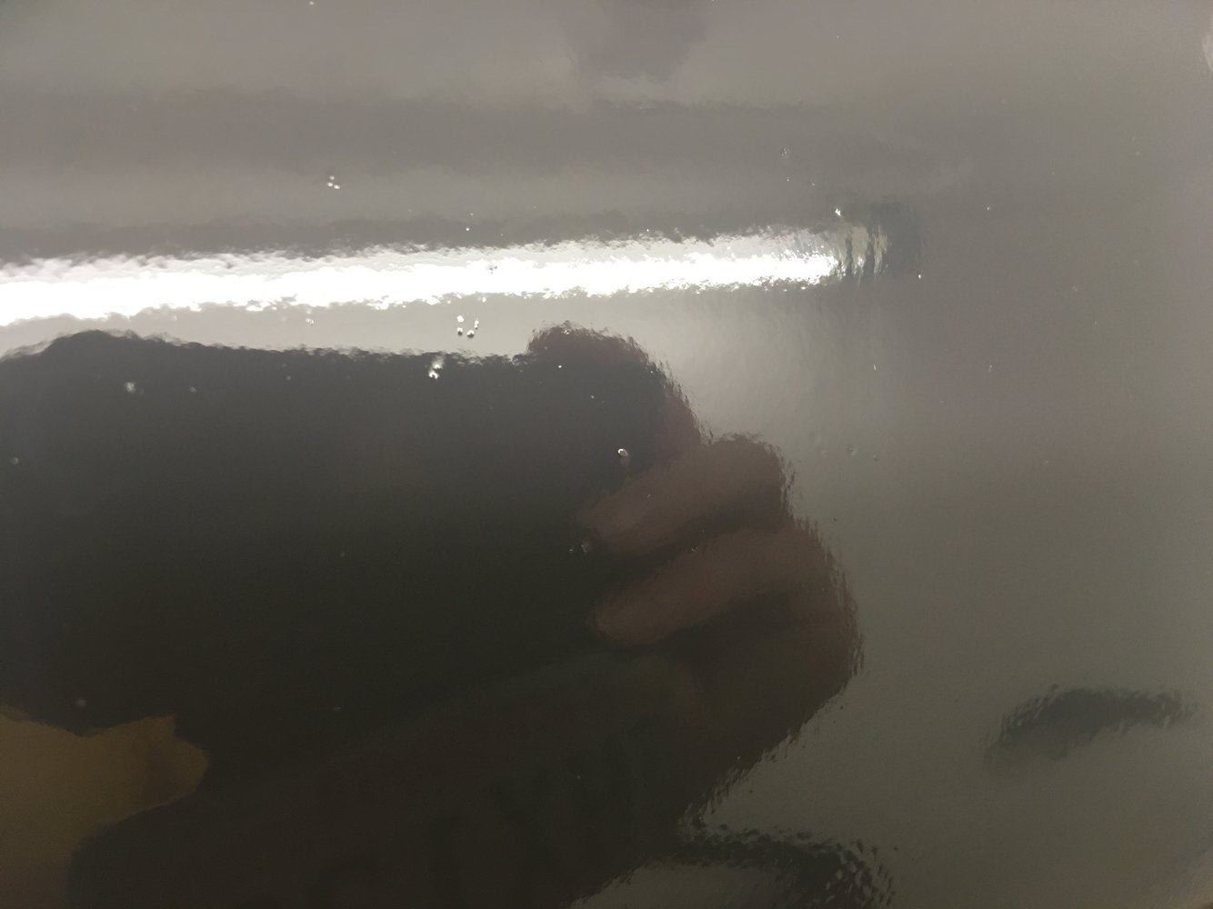

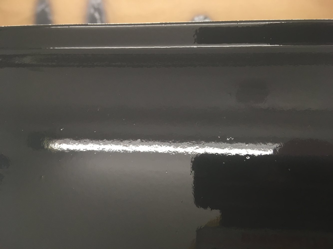

Is this one coat of expoy primer?So here's my first attempt at spray painting via my DeVillbiss GPG...
... Lechler 29107 onto bare steel. As a first attempt it was ok, although on inspection...
View attachment 341771View attachment 341773
...some of these imperfections look like tiny craters and others tiny bumps/pimples for want of a better word.
Would these be dust particles? Other than that it "appears" ok, I guess. Complete novice.
View attachment 341770 View attachment 341771 View attachment 341773
I would have expected you to use some thinners for thisI haven't used any thinners
According to the data sheet for the Lechler 29107 the 'Theoretical coverage: 1 l mixture = 4.5 m² at 100 μ' from that I would have expected at least two coats from the quantity you hadWhen I mixed the paint I filled the cup on the spray gun about two thirds to three quarters full. Nearly all the paint in the cup was used on that first coat for that one panel. This is considered too paint for one coat ?

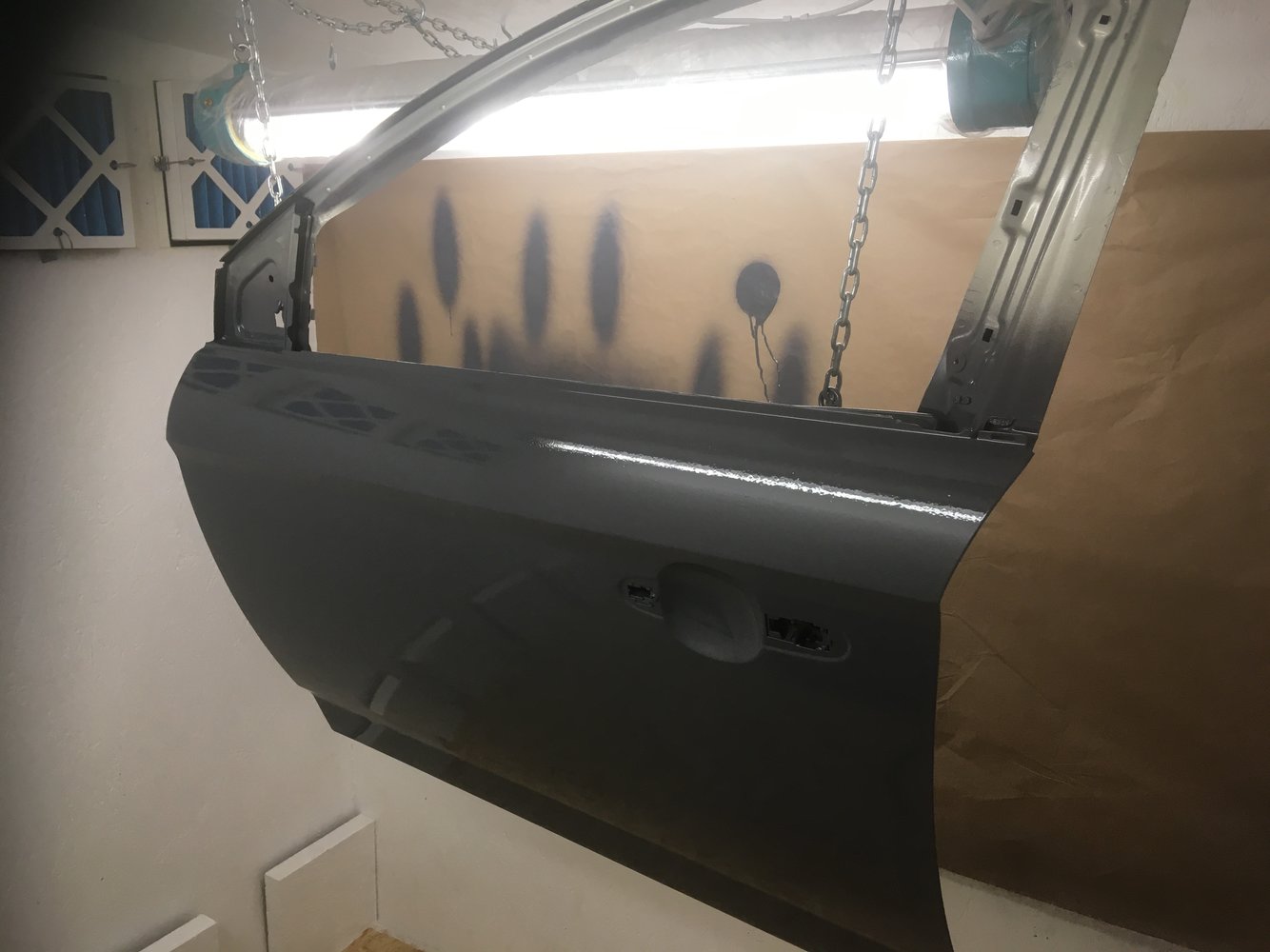

Ok, so I'm still practicing and using the practice panels and so far there seems to a bit of an improvement. Getting used using the gun and getting the paint on with no runs and less orange peel.
I've experienced some dust in the primer but I've cut that out with 600 grit when I keyed the surface for the application of the top coat (direct gloss Mipa Super Black).
The top coat has gone on rather well except for a little orange peel and dust in the paint which I'm happy to cut out.
My question are these:
1. What grit of paper should I go in with for this job?
2. I'm guessing I ought to continue block sanding with this process?
3. Should I be dry sanding or wet?
Thanks![]()
Everybody has their own method - I can only tell you what works for me.
Primer I finish dry with 400 straight off the DA, block with 400 as required - then spray base/clear or direct gloss.
To deal with any peel, runs, bits or get a mirror finish, I wet sand the topcoat with a block. It is imperative to keep it wet and keep washing the paper so you don't leave any scratches.
For a bad run I might drop down as far as 320 to level it out or slice it back with a razor blade - and then switch through the grits, 600/800/1200/1500 and then finish off with a trizact 3000 just to cut down the buffing time.
Buffing with a rotary, I prefer 3M or Menzerna. Farecla G3 works ok, but I prefer Menzerna.
So just to confirm you're dry sanding at 400 grit via a dual action sander? Can I ask why I would be block sanding afterwards with 400 as well?
no not normal , id expect it hard next day or 48 hrs maxOn one of the practice panels, painted in Mipa direct gloss (black) around a month ago, I tried the finger nail test. Unfortunately if I press quite hard and indentation is left. Is this this to be expected with direct gloss paint?
I made sure I used the correct ratio of 2:1 and followed the data sheet, I am using regular hardener and left the paint to cure naturally.
Oddly if I rub my finger across it, repeatedly with some pressure the indentation can (not always) disappear, no paint appears on my finger when I do this.
Trying to work out what May of causes this.no not normal , id expect it hard next day or 48 hrs max
funnily a mate painted something the other day and thats stayed soft ish
If a little too much of the thinners we’re added, could this be the cause?
Ok, thanks for clearing that up. At least I know it’s not the addition of thinnersAs long as the ratio of paint and hardener is correct then the amount of thinners shouldn’t make any difference, as once the thinners has evaporated the paint should cure. The problem with to much thinner is you are more likely to get runs
