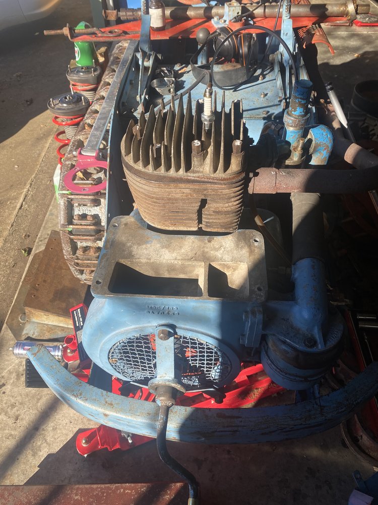

I'm not sure of the type of carb on your crawler but if it has a brass float have you checked to see if it's got a hole in it?
is there space to adjust the lever that moves the needle , some are bent to a certain distance off the face , this may be the case , have a chat to the owners group , or see if theres a rebuild manual on the carb , zama and the likes use this system and have a small gauge for setting the heigts.
its not so much of a lever as the bend you put on the lever ,, hope that makes sense ,,, post a pic if you have it in bits .No there’s no adjustment lever for the needle. I’ll take the carb off again to have another look

Carb is at a repair shop. Really cool place stuffed full of old motorbikes, a Lancia Beta and two old guys who were apparently talking about how nobody had walked in with something old and weird in a while. Allow me to introduce myself, gentlemen![]()

fuel is not leaking anymore but fuel/air mix will aggressively pop back out the air intake. I feel I’m close but I’m close to throwing in the towel with it for today.28 to 30 throu as a start, if memory on similar engine is correct.More of the same. Lots of forums saying make sure the gap is set correctly, unfortunately no plug width info posted.
Closer if coil pack is old/weak.

The donky engines at my mates farm used to get air leaks on the inlet manifold, start run and soon cut out.
I guess you checked for that?
WD 40 works as wellYes, all sealed with fresh paper gaskets and hylomar. The exhaust does leak a little, but not enough to inhibit starting… will buy some easy start today
