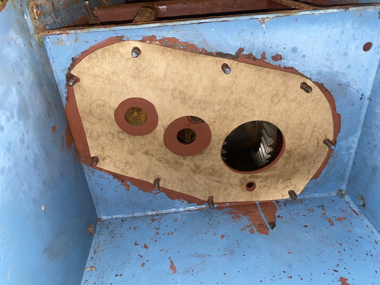

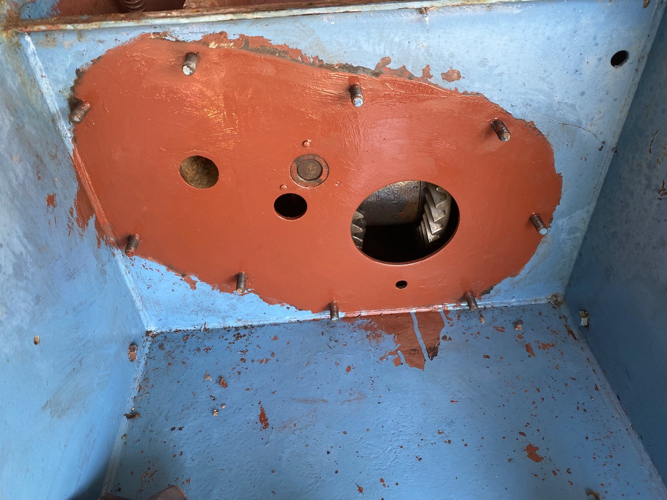

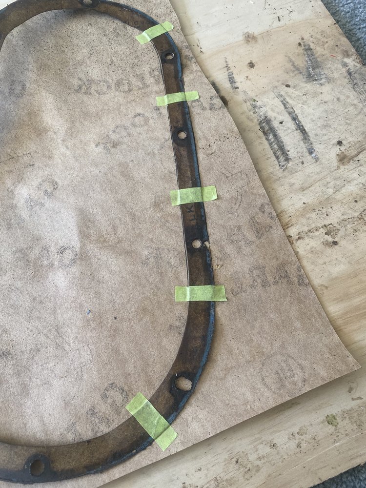

Re the gaskets - I always use the original cover/housing to make gaskets, if at all possible. I don’t like copies of copies of copies….
Harps back to the game of ‘chinese whispers’ of long ago (before PC came along).

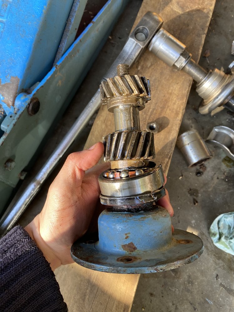

While here, ‘pounding’ is off my radar these days. Always press if possible. If not, only the use of a soft mallet head or a yellow metal drift gets used. Seen too many ruined shafts from hammering.

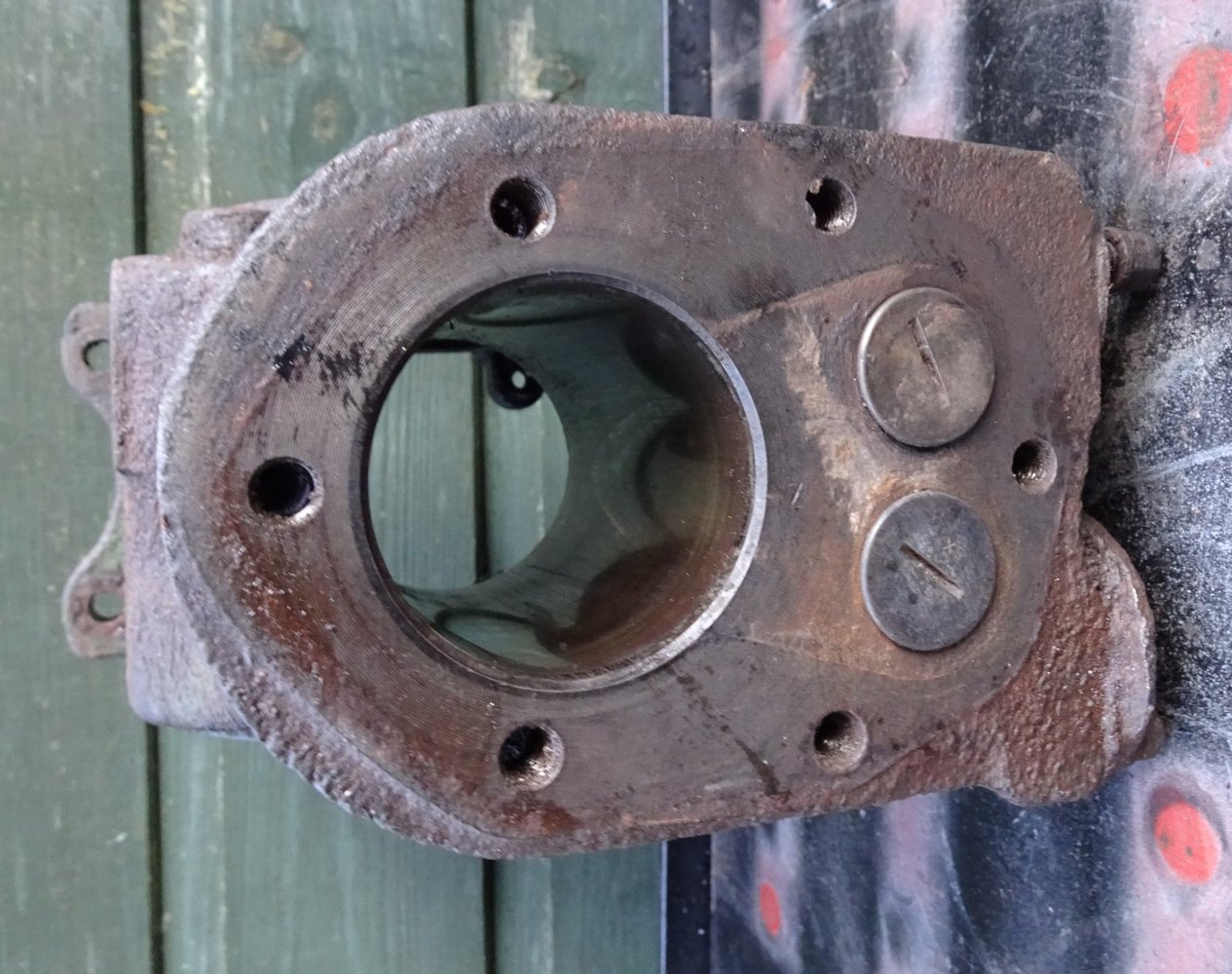

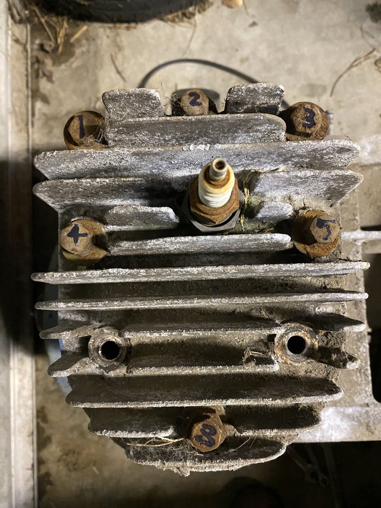

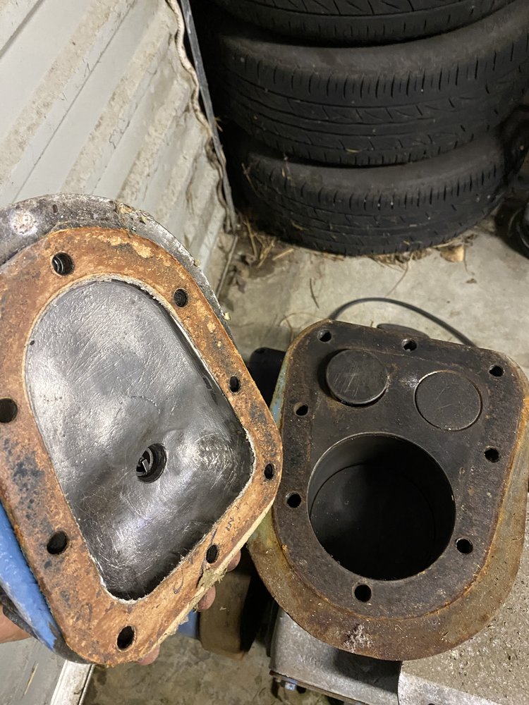

Looking at the witness marks it looks like he's removed bolts 6&7 before the pic?Not sure your concerns were allayed - more like confirmed, especially if two head bolts were missing.
Quite correct.Looking at the witness marks it looks like he's removed bolts 6&7 before the pic?
Looks like a home-made head gasket from steam gasket material? Likely contains asbestos.
