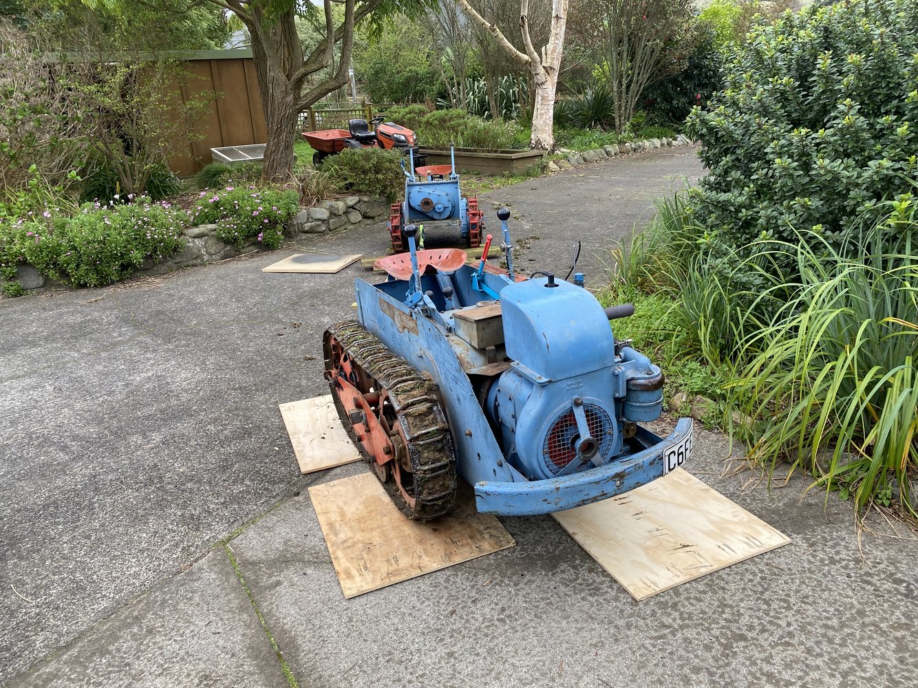

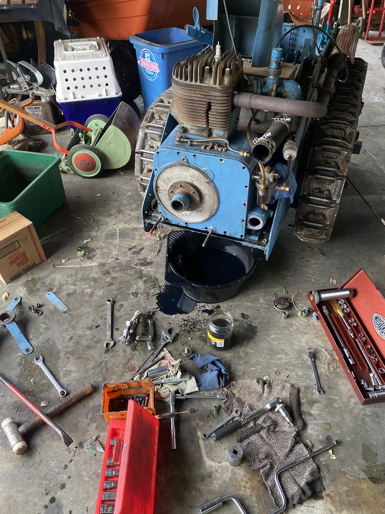

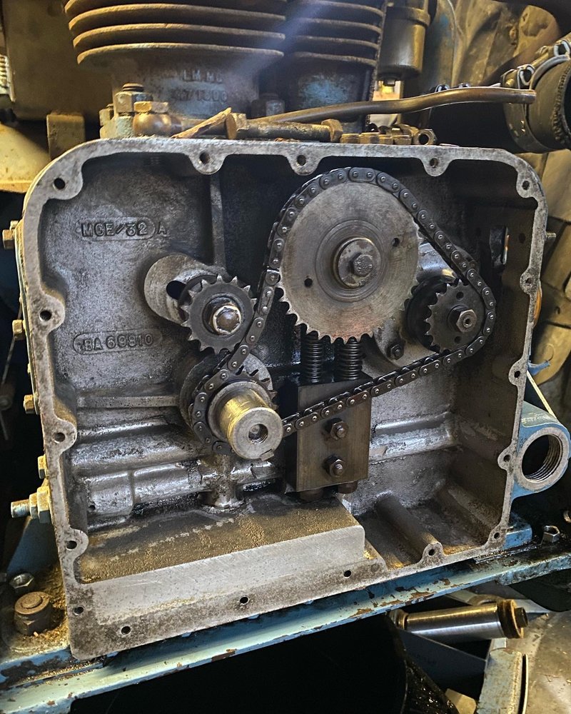

it really is going to be better than new , great to see its progress.

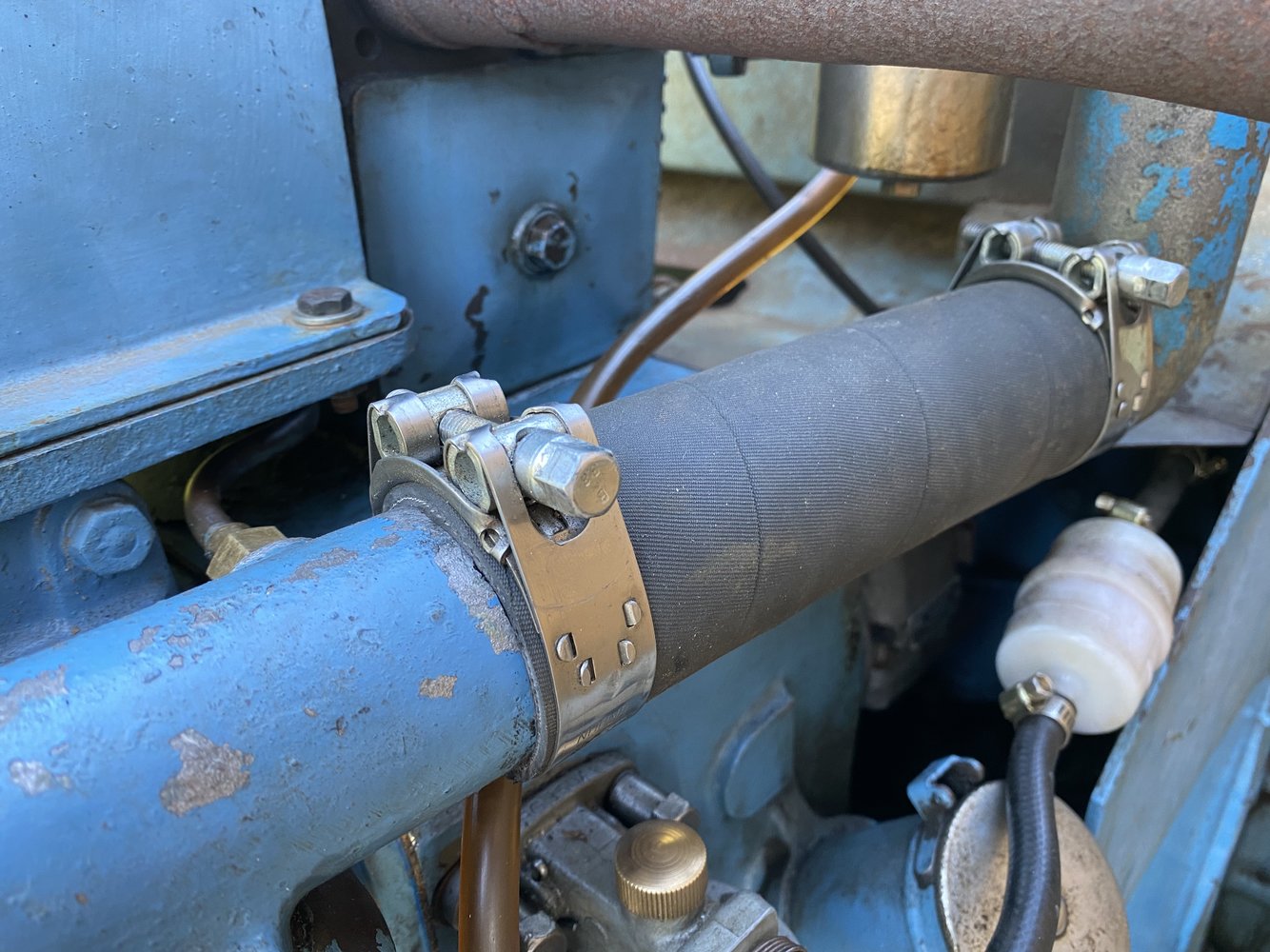

Fuel pump - this needs cleaning every so often. Deposits build up on the bottom of the glass. I recommend filling it up with a bit of petrol before you put it back on, saves endless pumping on the diaphragm.
don't let the bowl freeze they break no idea if they are available anymore
Luckily it's a popular model so plenty of aftermarket stuff available - glass bowl
The Ransomes takes an Amal carb unique to Ransomes MG tractors and is notoriously difficult to source as a spare.
it has an adustable main jet that you can wind the needle in /out
Have you tried Burlen Fuel Systems for spares?
Looks like a Wolseley Style 4 (R Type)I've got the contact of a guy called Neil Jarrett, he's the go-to man for spares
