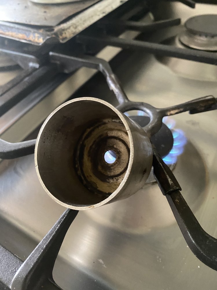

Can you weld up brass?

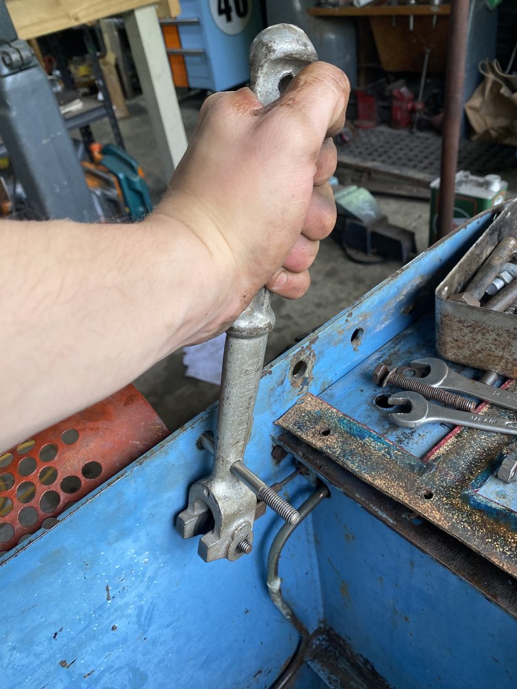

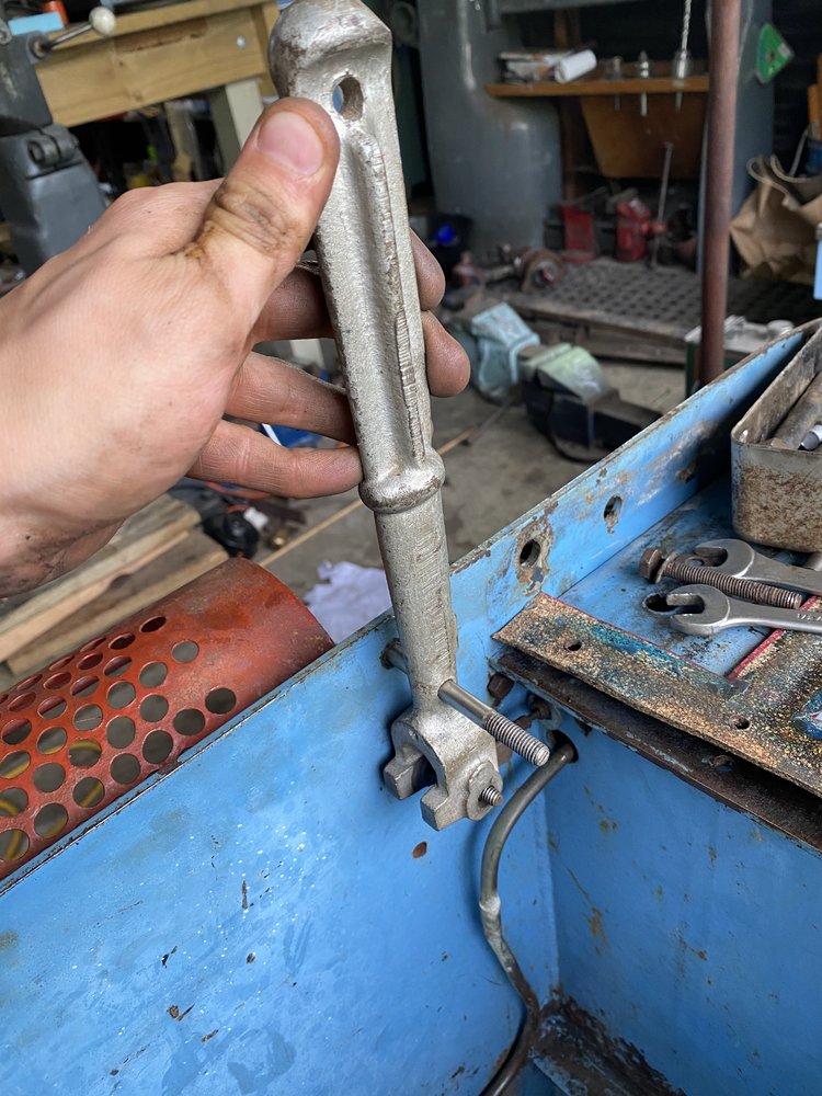

I’ll get some spacers made up and proper bolts etc, just a mock-up for now but it works really nicely.
The handle would be better with a bracket fabricated to strengthen/support the outer end of the pivot pin?
No, you cannot weld it. Soft (plumber's) solder will be fine for that. Cleanliness is you friend when soldering. Sweat a brass washer either internally (thin one) or externally (thicker, depends on bolt length*) over the cracked area to spread the clamping load.
Anneal it before attempting to bash it back into a flatter state.
Consider making a hollow brass spacer that goes between the bottom of the carb and the top of the underside of the float bowl. Fiber washer between spacer and bowl on the inside. Then it is not possible to overtighten it.
* you can thin down the underside of the bolt head on a lathe if you need a little more length using the same bolt.
