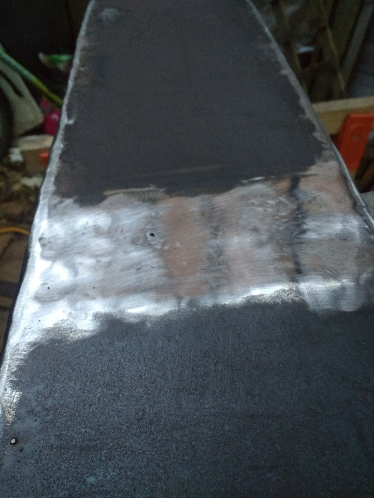

You don't need to go to 120 it's over power for the rods I just did it to show you that you shouldn't be blowing holes in 3mm 80-90a I found worked just fine as to the 50v or 80v it just gives easier starting of the rods and helps with cellulose rodsI've just seen your replies, having welded & ground out the slag inclusions and again etc etc.
JLG, I have no doubt it is my lack of skill and depth of knowledge. I'd do welding evening classes, but all the good ones have been axed.
Coincidentally, I did a couple of practice beads on a piece of scrap, then ran beads & more beads over the finished area to fill it, as it had developed a slight concavity.
Now it's all ground down just the odd pinprick of void but these are in the build-up layers. I was planning on fairing cosmetic blemishes with epoxy fairing compound (as used on boats) -any reason why that is a bad idea?
ALHP, that is good advice to take time out, which to some extent JLG is suggesting too. My welder is an RT110B & won't go to 120. I really ought to take time to play with the settings.
I had a look to see why I would choose 50V or 80V, but as yet haven't found an answer.
