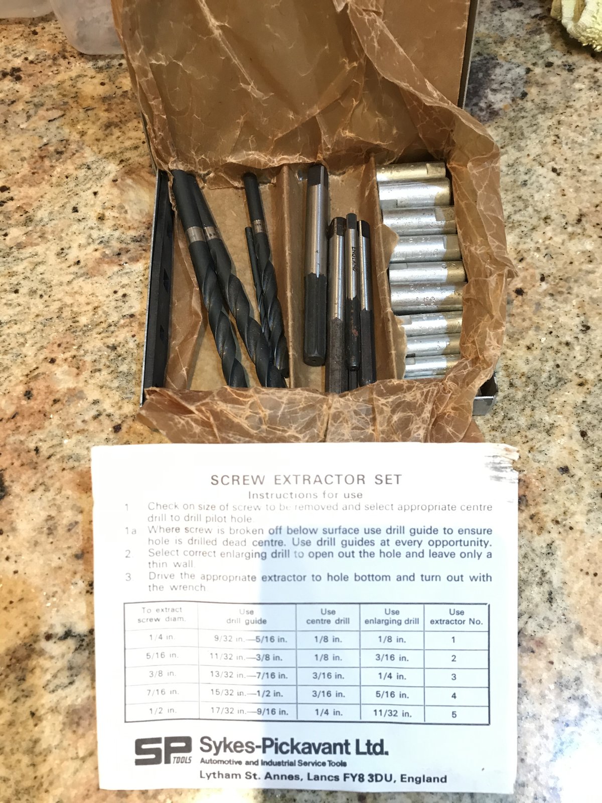

You’re welcome to try this out if you want:
Edit: just seen your post about the snapped drill.......
You are very kind. What I really could do with is a shoulder to cry on and someone to watch, to prevent me making it even worse.
