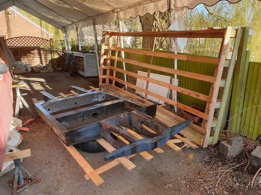

I haven't done anything on the van for nearly a year. I've finally unboxed the chassis. It has stripes where the e-coat has faded in the sun. I want to mount the body on the chassis this weekend so I'm finishing off the welding on the body.

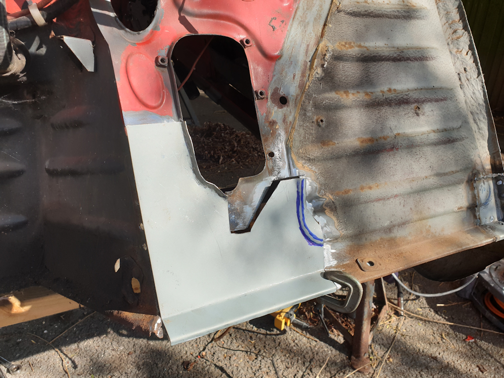

There was a hole in the bulkhead behind the reinforcement bracket that bolts to the chassis. That was inconvenient as the bulkhead panel was sandwiched between the reinforcement and the panel behind the engine. So reinforcement bracket off and a repair nearly ready to butt weld to the bulkhead. All 0.8mm or less so tiny little welds and a good fit needed.
