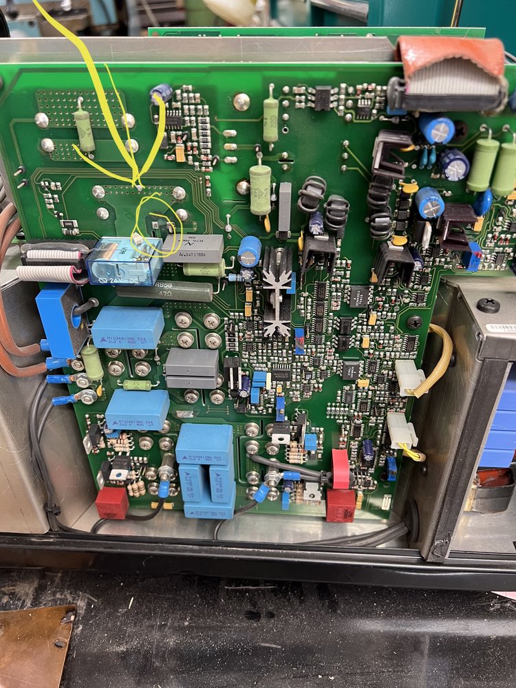

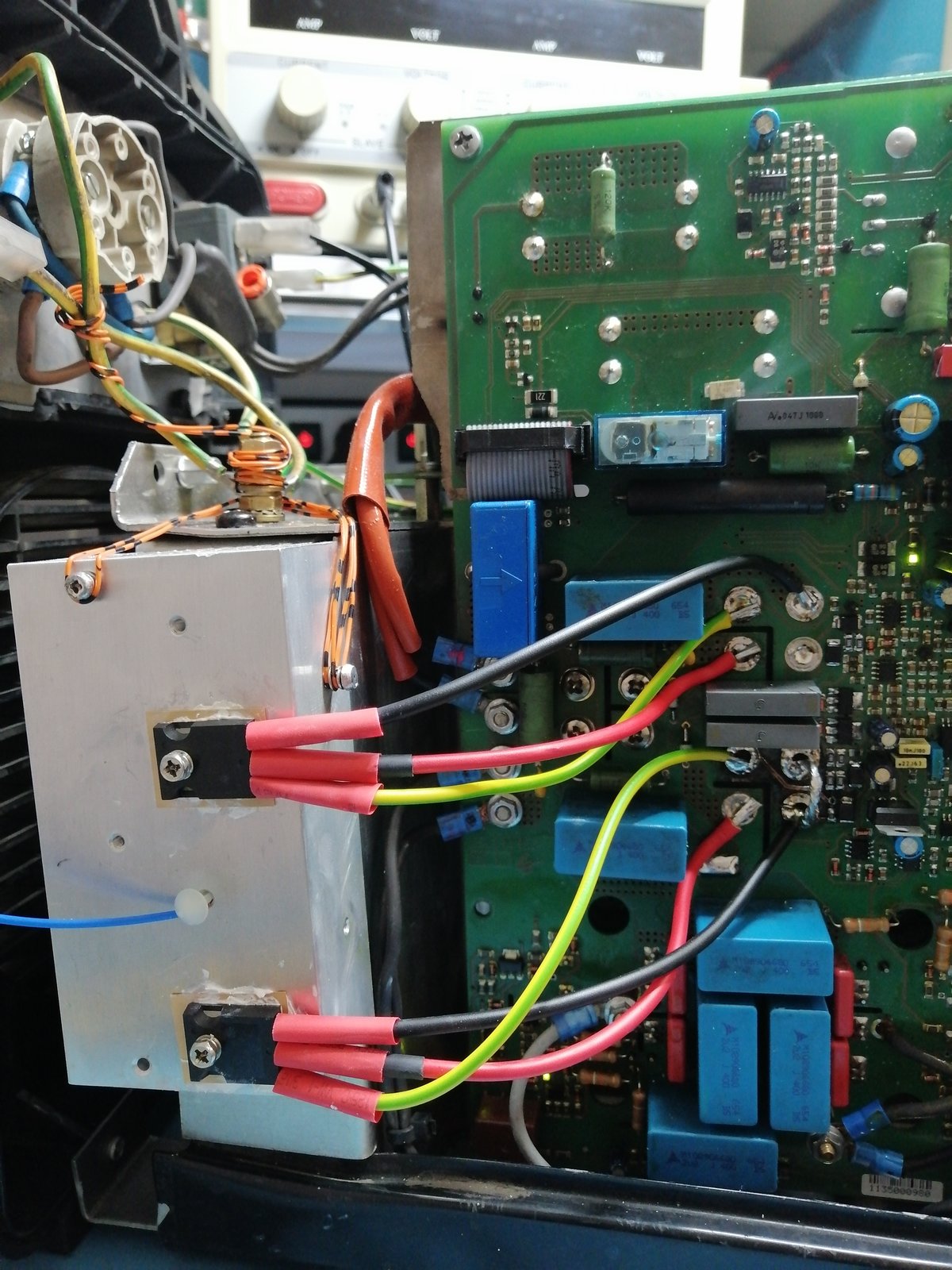

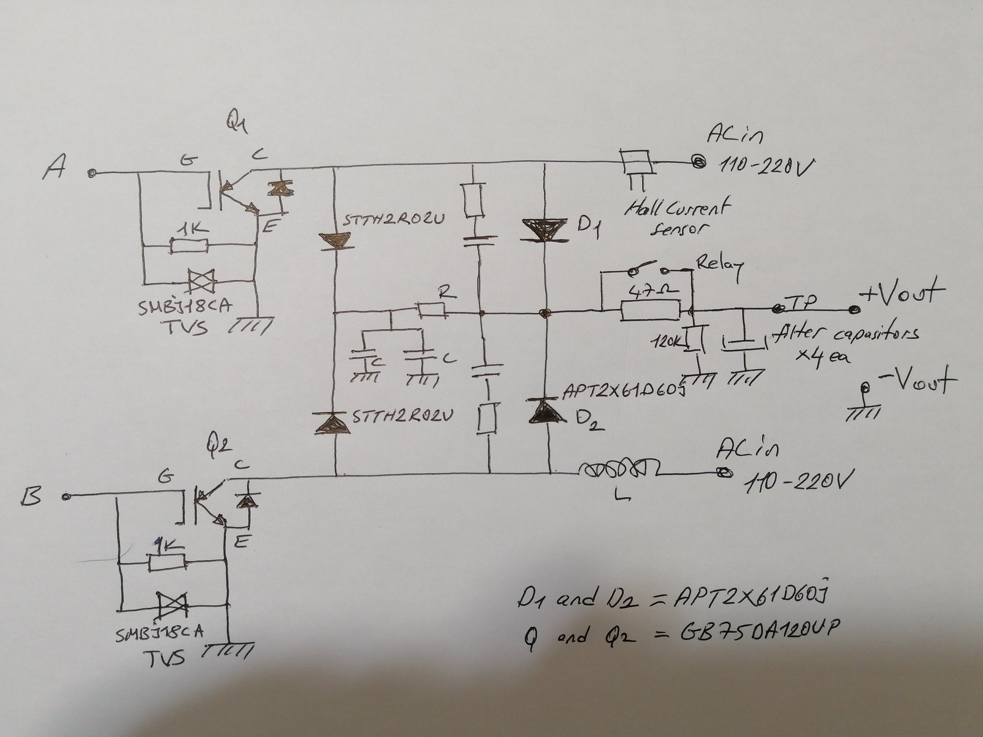

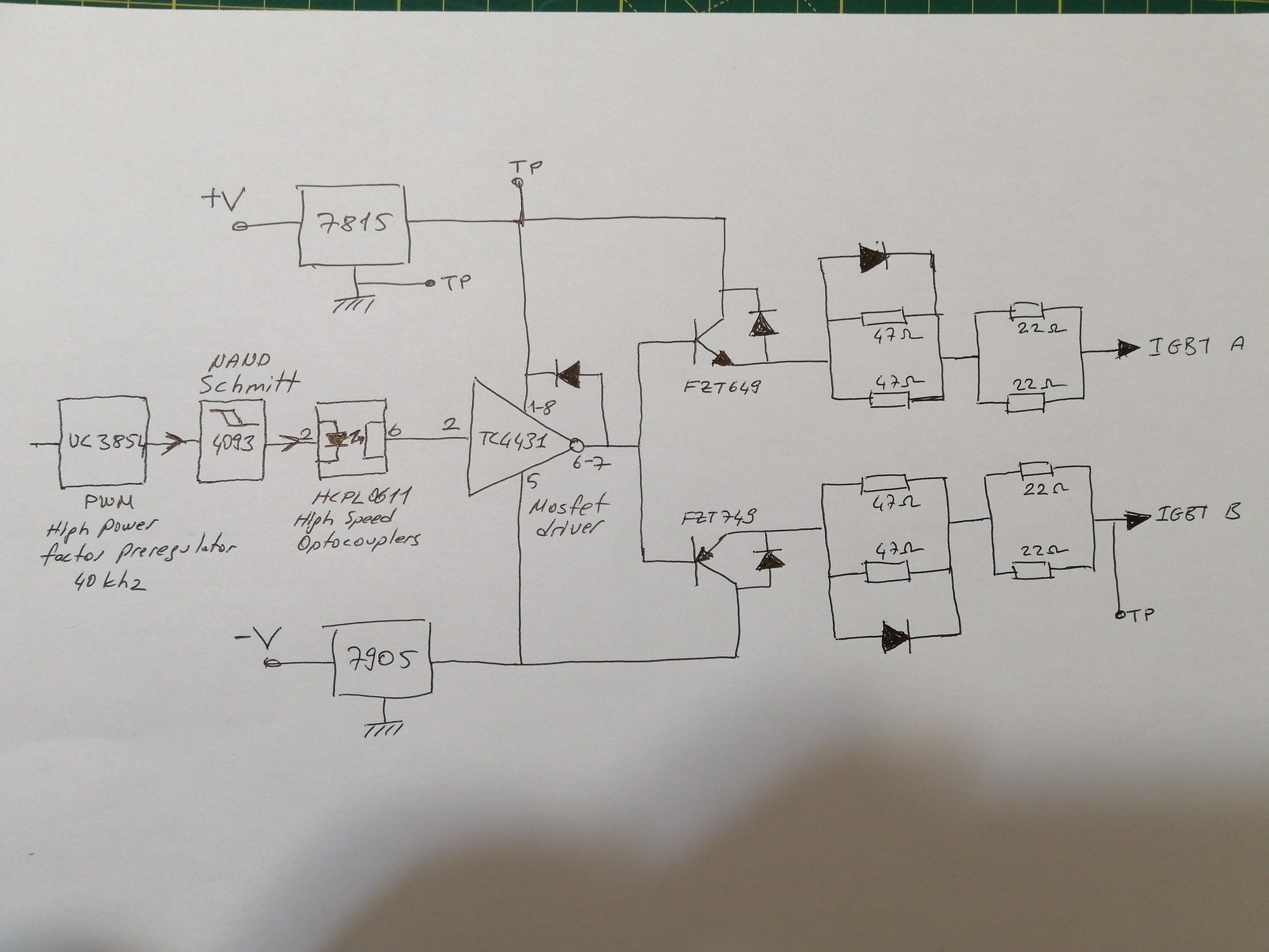

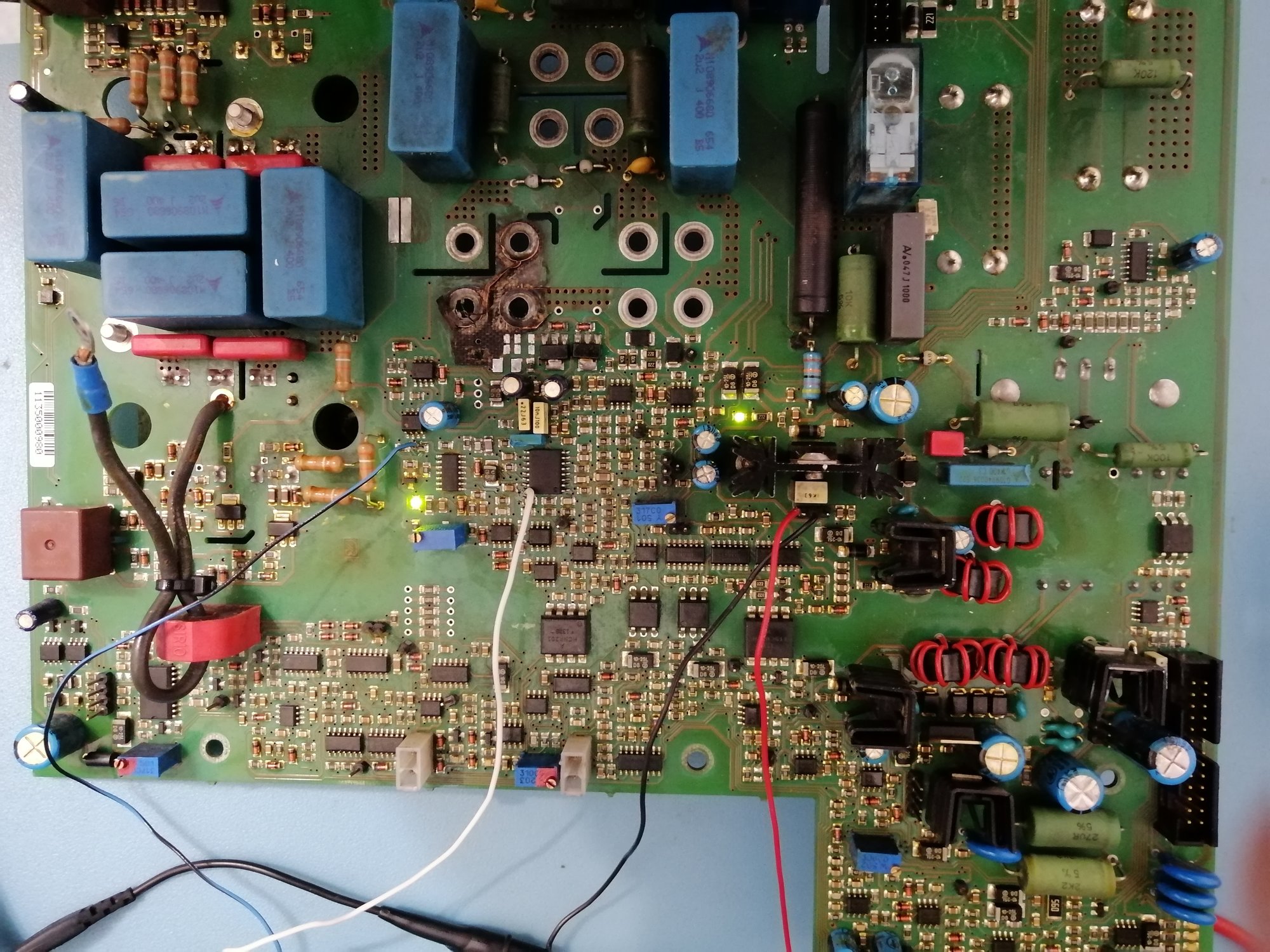

Hi, after long time later, just start again try to repair my roasted main pcb ( called by Lincoln Main IGBT Inverter Board ) of Lincoln İnvertec V205T AC/DC welding machine. I want to try to share my knowledge and experience. First off all i need to circuit diagram roasted section of pcb which is called UPFR section. Many times searched to internet and can not find any information of correct version of this machine. And decide to draw scematic diagram of this section. I hope that if somebody need it and help out this circuit diagram. Also hoping that more people contribute and develop this thread it should be good guide to repair mentioned machine.
