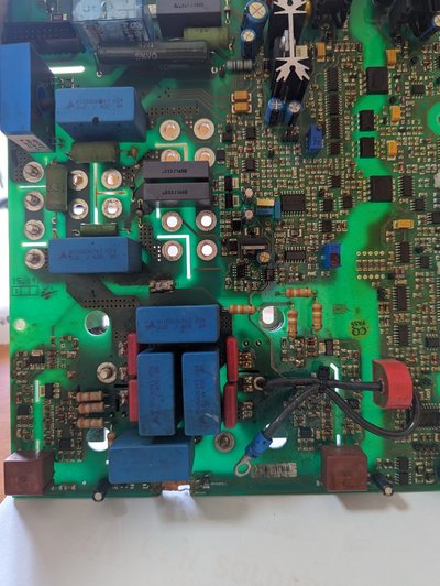

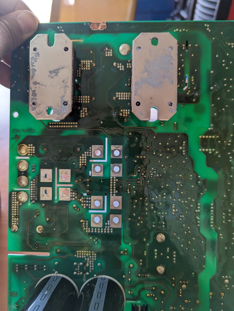

But obviously I am hoping the mosfets have failed open circuit…thank you for the reply
no, I do not know that the mosfet’s are faulty, I have tested with a multimeter and they are not ‘short circuit‘ which I understand in the common failure mode for mosfet‘s. As I get more familiar or more advice, I will check more out before they arrive.
My rationale for ordering them is that they will take a good few weeks to be delivered so I do not want to delay ordering if I confirm that they are at fault. But also, the machine is coming up to 20 years old, these components are doing the ’heavy switching work’ and from experience from working with clever people these have a ’life’, so replacing Is not a bad thing even if they are not at fault. (Noting, the spares catalogue for the PCB at £3,250 includes 6 new mosfets)
